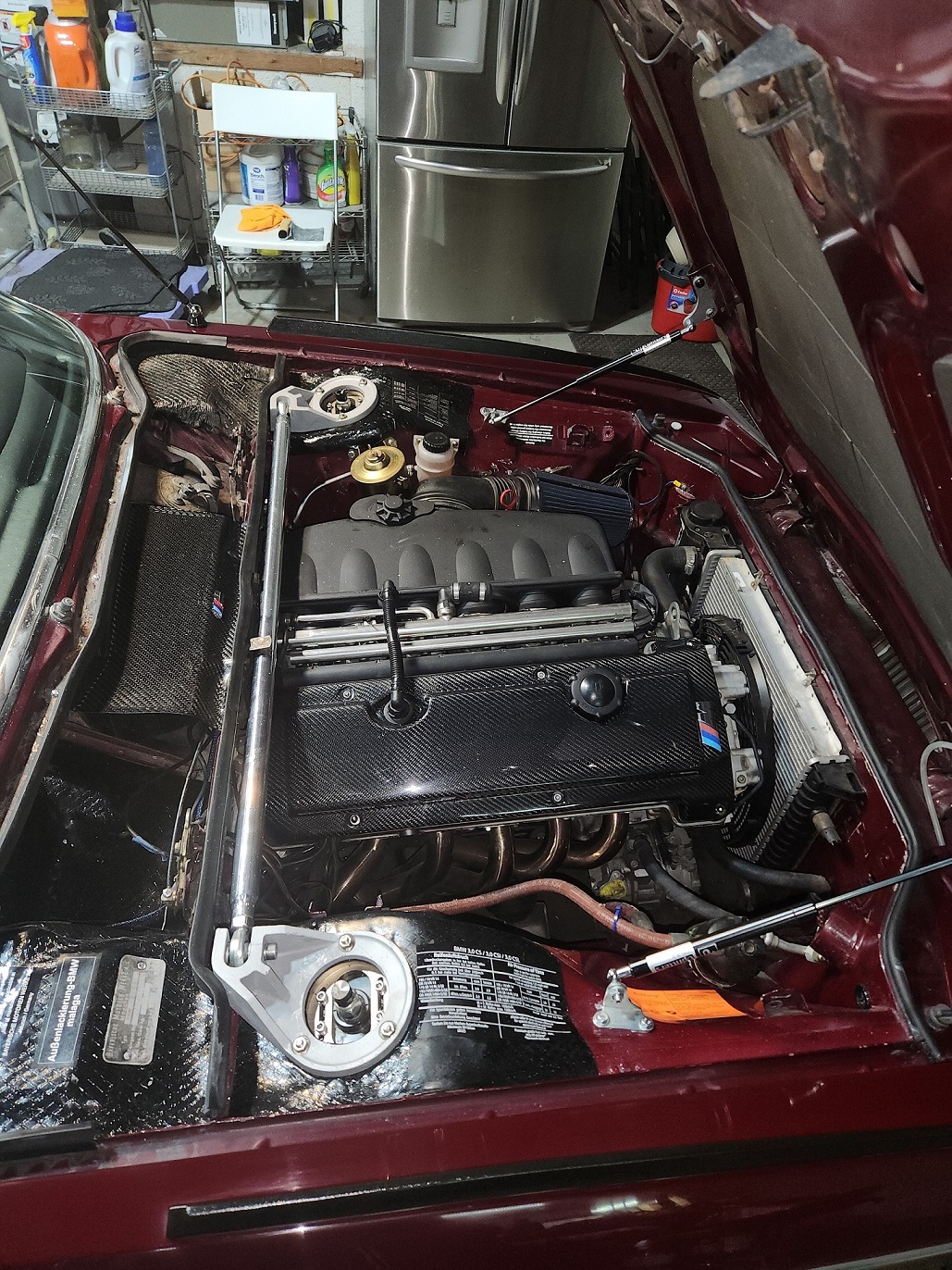

Hello my friend, I am the one I swap s54 with 5 speed if you will listen to me stay away unless you have lots of money that you don't need there is countless hour and parts and very hard work and in the end when you want to sale it you don't get half of the money back, DO NOT TUCH S54 FOR E9, I know a guy he had a 633 BMW and he rebuild the engine with raising parts and twin turbo he is mechanic he didn't pay labor but he have 700HP do you want more than that and he didn't spend half what I spend on the S54
do not do this what I did or you will lo0s 60 or 70K
If you want S54 horsepower, the S38B38 motor from a euro M5 has 340hp. Make sure you change the bearings no matter how young the motor is.
True, but S38s are getting very hard to find. Not sure you want a B38 w/the dual mass flywheel?
Look for at least $10k for an S38 if you can find one in good condition.
