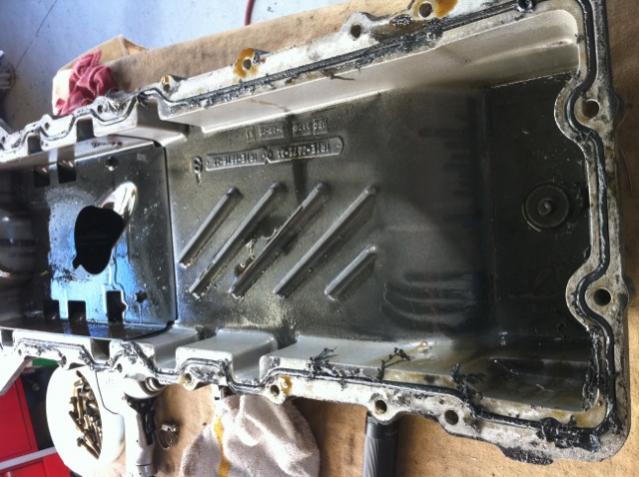

Guys: Autopsy complete and waddaya know: several years ago I had an oil leak from the area around the oil pan seal. Wanting to have the repair done "right," I took it to the local Aston-Martin dealer in Marin (Marin Luxury Cars) and paid them $$$ to fix it. They did. Unfortunately, their idea of fixing it was to use an enormous amount of silicon (think window caulk) between the oil pan and the block. The correct repair called for a gasket -- not silicon. The silicon broke apart over time and eventually clogged the sump, starving the engine of oil and leading to the catastophic engine failure. In one of the attached photos you can see all the silicon “worms” covering the sump intake, and in other photo you can see the silicon remnants along the edge of the block and around the gasket. I am still waiting to hear back from the Office Manager at Marin Luxury Cars to see what their repsonse will be. Stay tuned.

This would seem to be an open-and-shut case. Its a beautiful car, I hope that the dealer sees it the same way and gets you back on the road.

Time to lawyer up. If the dealer and AM give you one syllable of grief go public and sue.

Based on the pictures and receipt of service, I think you should have a solid case. I can't believe a AM dealer would cutt corners like that. The liability is just too much to try an cutt corners and save money on a hih dollar car such as yours. If they are still in business the good news is they have money, a bond register with the state and most likely other insurance that will cover them for this type of neglience.. Once this type of service level gets out in the public, IT WILL HURT their business for sure... Keep us posted and act quickly as you don't know how many others that might be after them for similar issues.
