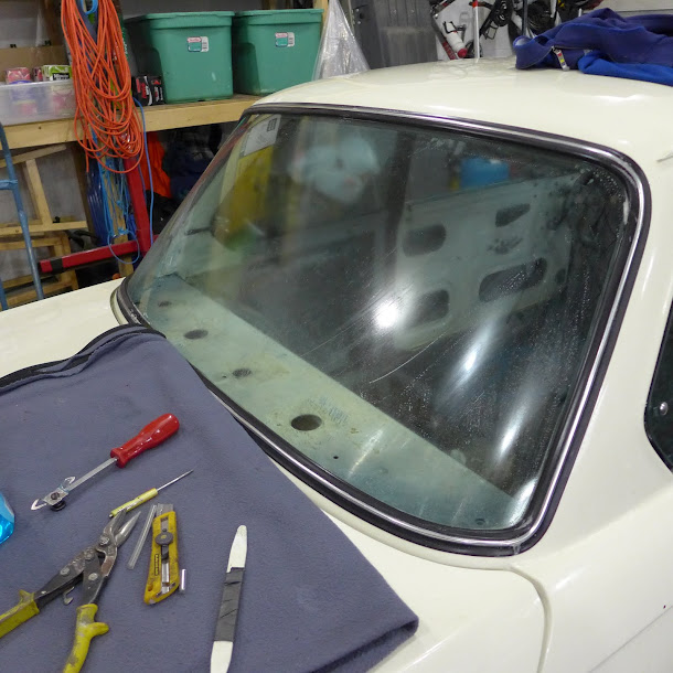

Would the windshield trim on a E3 or E9 for that matter be installed the same way as the Studebaker windshield+trim? That is installed unto windshield with new rubber seal, taped in place, rope into slot for body, etc, like blog?
BTW - I have done 2002 front and rear windows with the rope method; never used glazing just soapy water to lubricate. Then the locking strip once installed.

Yes. In fact, the same guy did my E3 as did my Studebaker...
