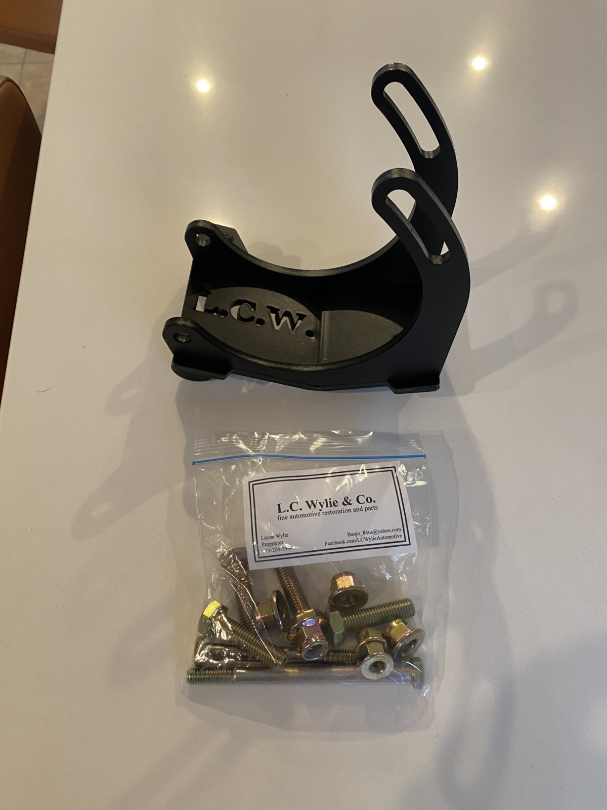

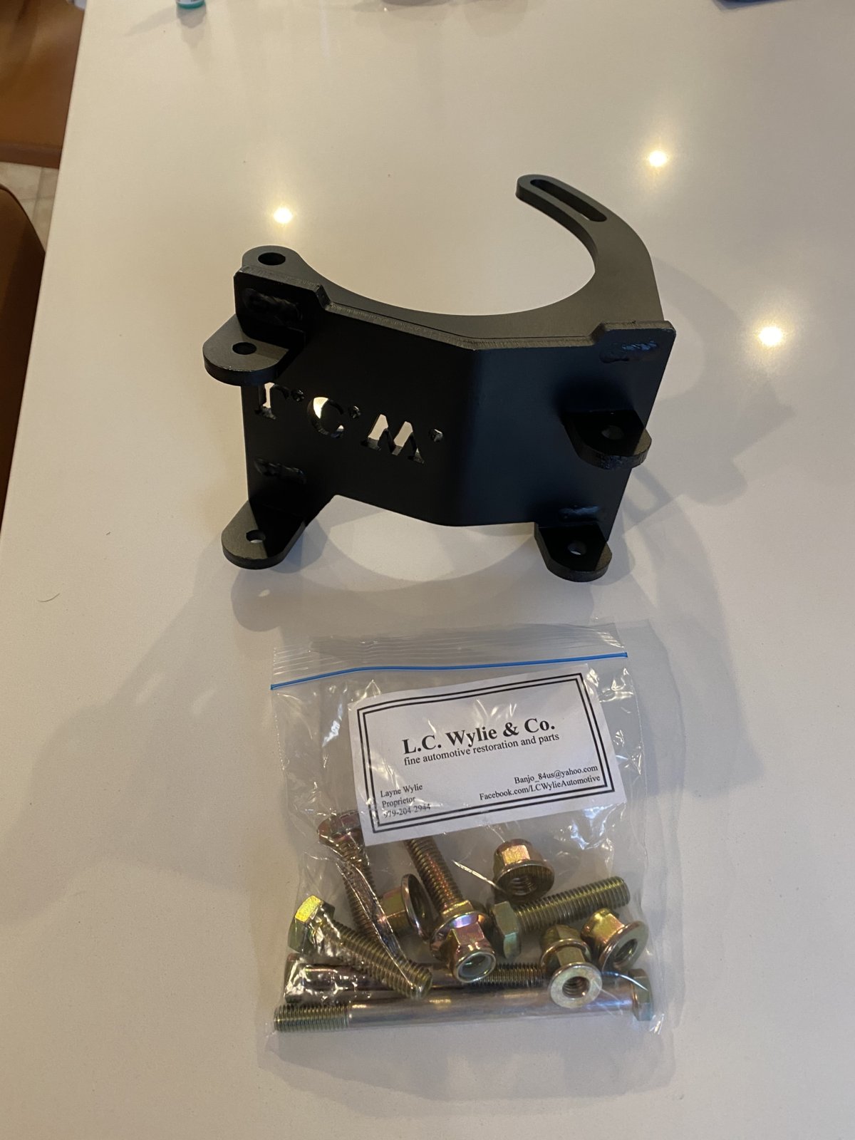

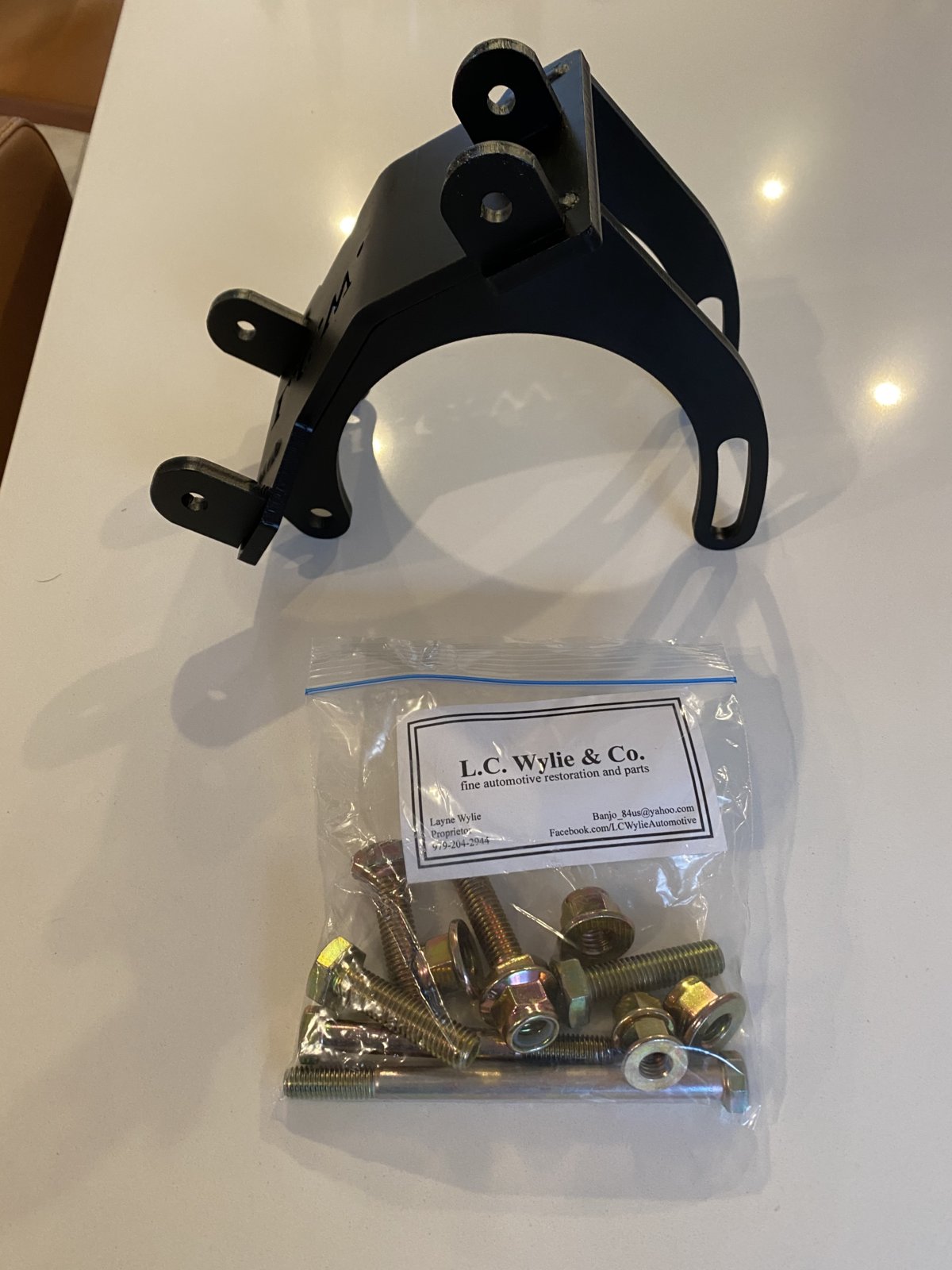

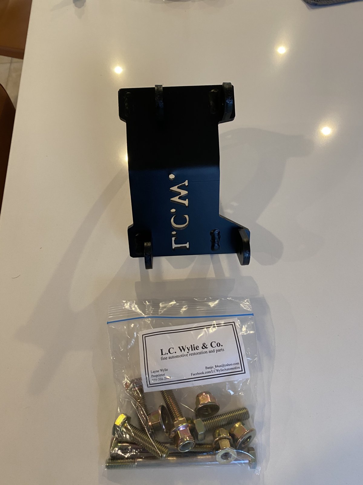

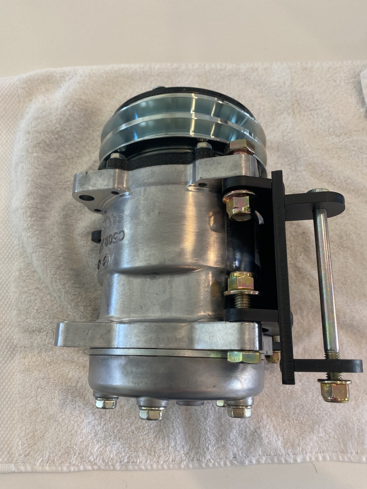

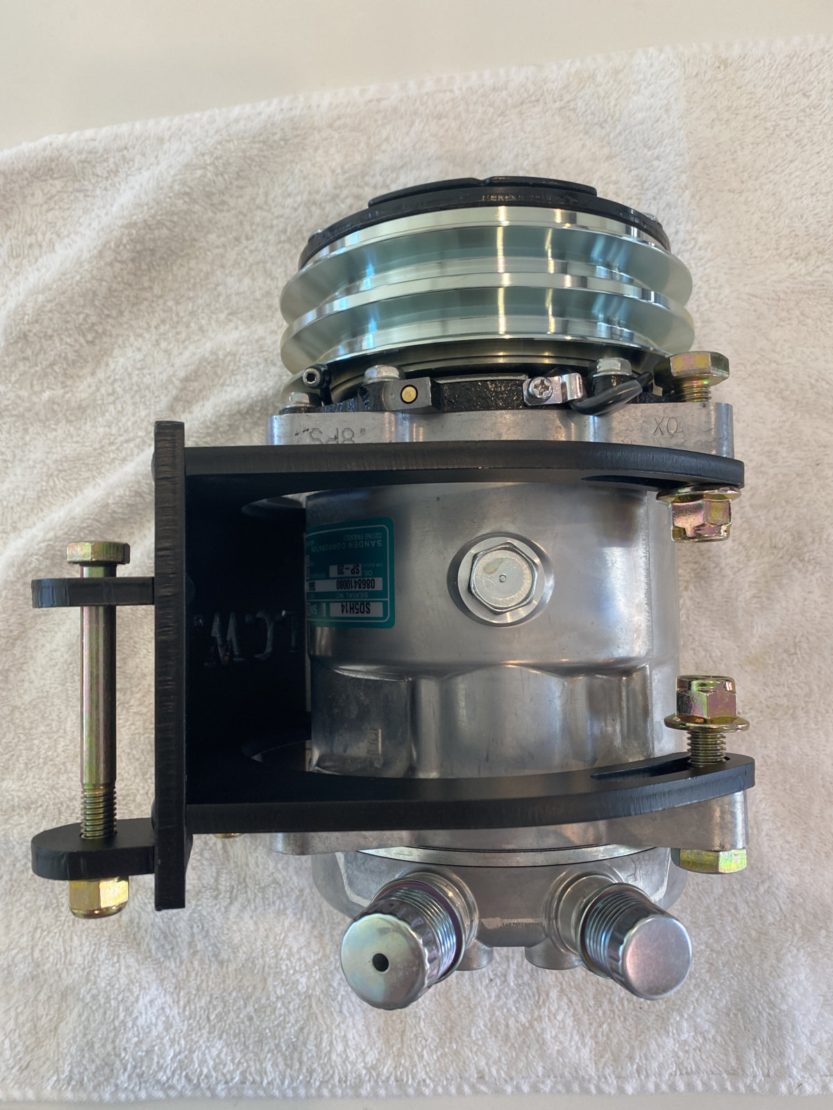

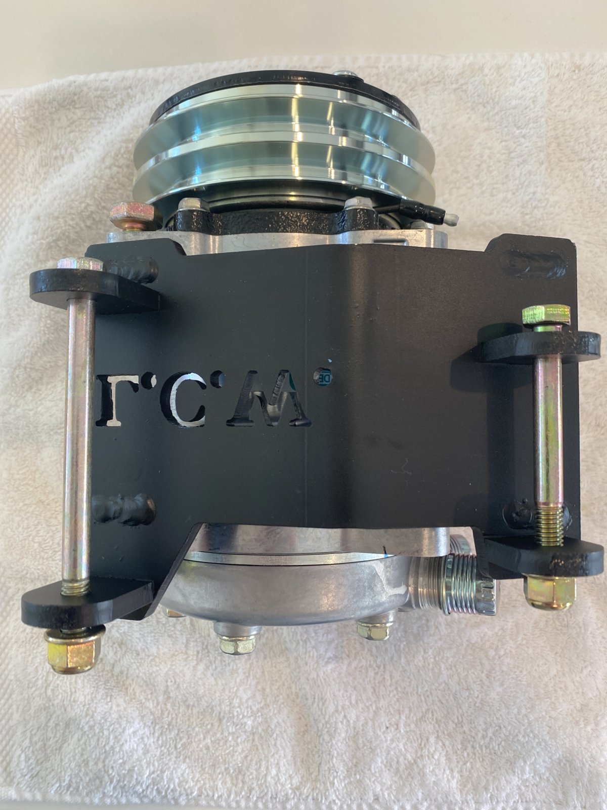

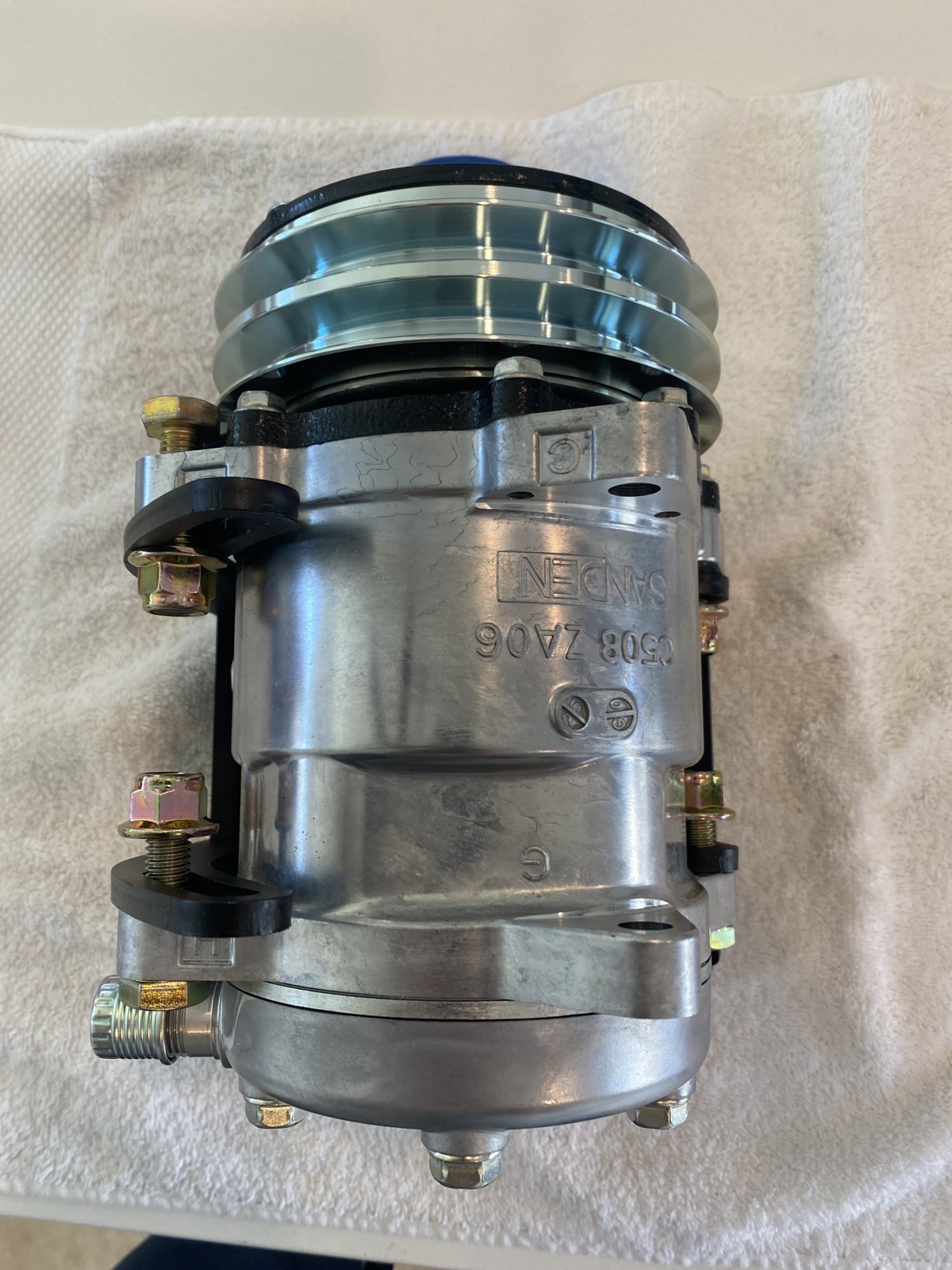

Layne’s bracket just came in-I have to say, this is a beautiful piece of manufacturing.

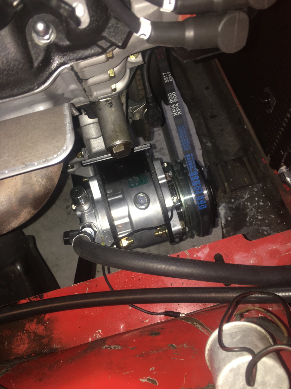

Here’s a couple of more pictures for the guys that do better with visuals.
Still waiting on the intermediate piece, belt, condenser and brackets to ship. The fit is perfect on @Layne bracket

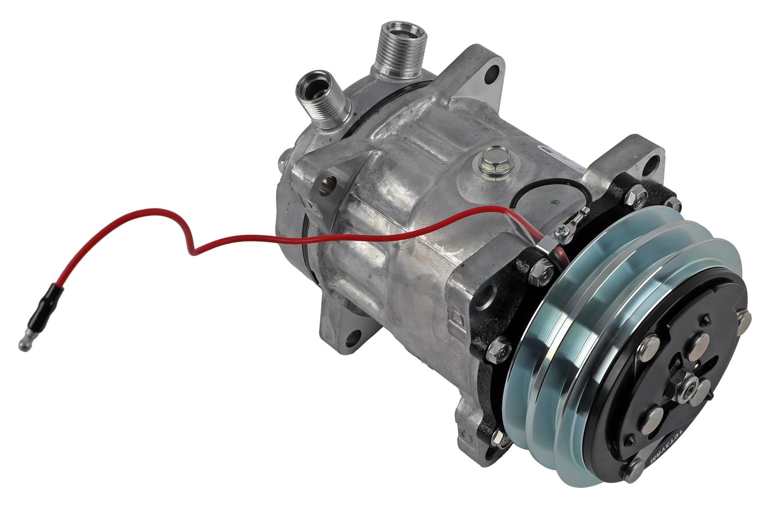

which model ac compressor would you recommend for an upgrade? sanded 508? or any other for an E9?
508 or 709 works just fine. There's a lot of variations of both, different fittings and different sized pulleys etc. This is the one I like. A 709 with a 125mm pulley. Larger pulleys work (132mm I think), but can make installing the bolts more difficult. The 508 has 5 pistons and the 709 has 7. There's very little functional difference, I've used both with great results. But in theory the 709 is the "better" one, so I usually go with it if the price is about the same.
