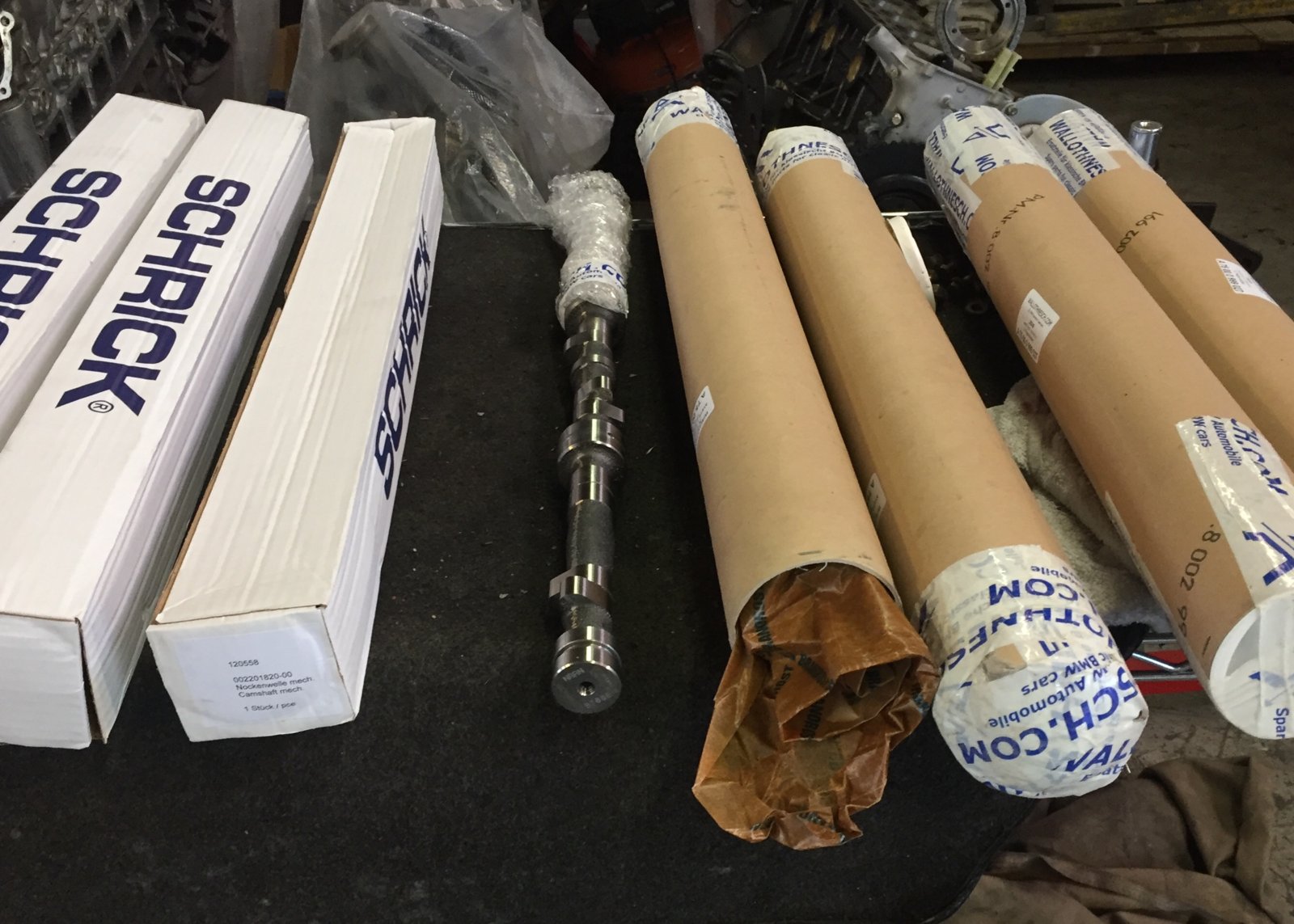

Got my first shipments today and yesterday. W&N was great tracking production and keeping me informed. Smart time to buy as they are in stock and there is a shipping discount available.

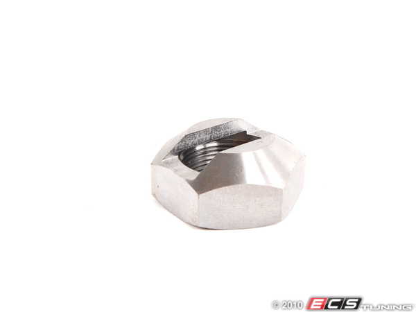

All motronic cams become distributor cams with the special nut.

If I am understanding the information correctly, at Gladen only one of those four cams are suitable for use with carbs (the 282 degree "with distributor"). All of the others note that they are for Motronic, which would not drive our distributors? ("our" meaning us carburetor people). I am even more lost on the W&N site, but assume the "SCHRICK camshaft 284 deg 320/6 and 323i" would work with the distributor ignition (process of elimination since the others read "MOTRONIC"). And with that logic, W&N may also have a 272 and a 288 degree cam that would work?
Yes, only one of them is for a carburetor M30, it has the lobe to drive the mechanical fuel pump, which the other ones (motronic) don't have.
There are also a difference between a early Jetronic cam and a late Motronic cam, Jetronic has a fork for the distributor and the Motronic has a pin, but I've read that you can convert a Motronic cam to be used as a Jetronic? Sfdon?
EDIT: aswered above one second before I pressed post reply:p
The 320/6 and 323i cam is for M20, no go.
