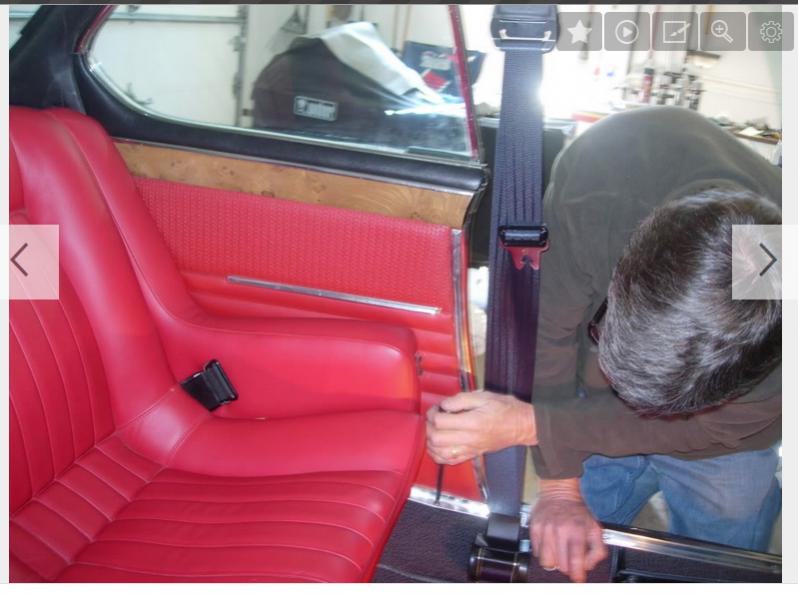

The 'fix' I decided to get, Bim Bill and Stan have this, an extension hangs down from there to position the top of the shoulder belt at a reasonable location
Here is a photo I found looking on the net, turns out it is Stan's

And for posterity, the upper belt mount was added to US/NA coupes with 2240143 and 2250071 so early in the US 72 model year in January 1972.
