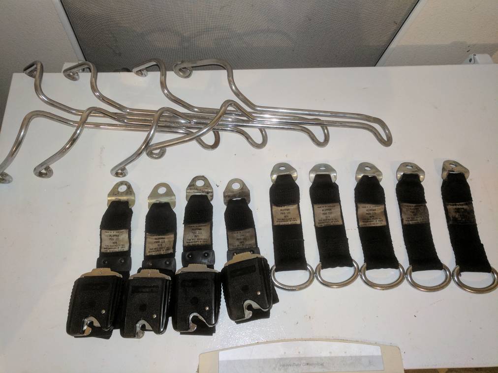

The fixed belts installed by BMW were by Klippan and used a chrome hoop mounted on the trans tunnel. I have a set if you'd like them.
We called them "crab claw" belts... a very simple but unbreakable clasp mechanism hooked onto the chrome hoop.
From the 2002 site, not mine or my photo, but these are the style. The tall bit is used for the fronts, short hoops were used in the back seat.
