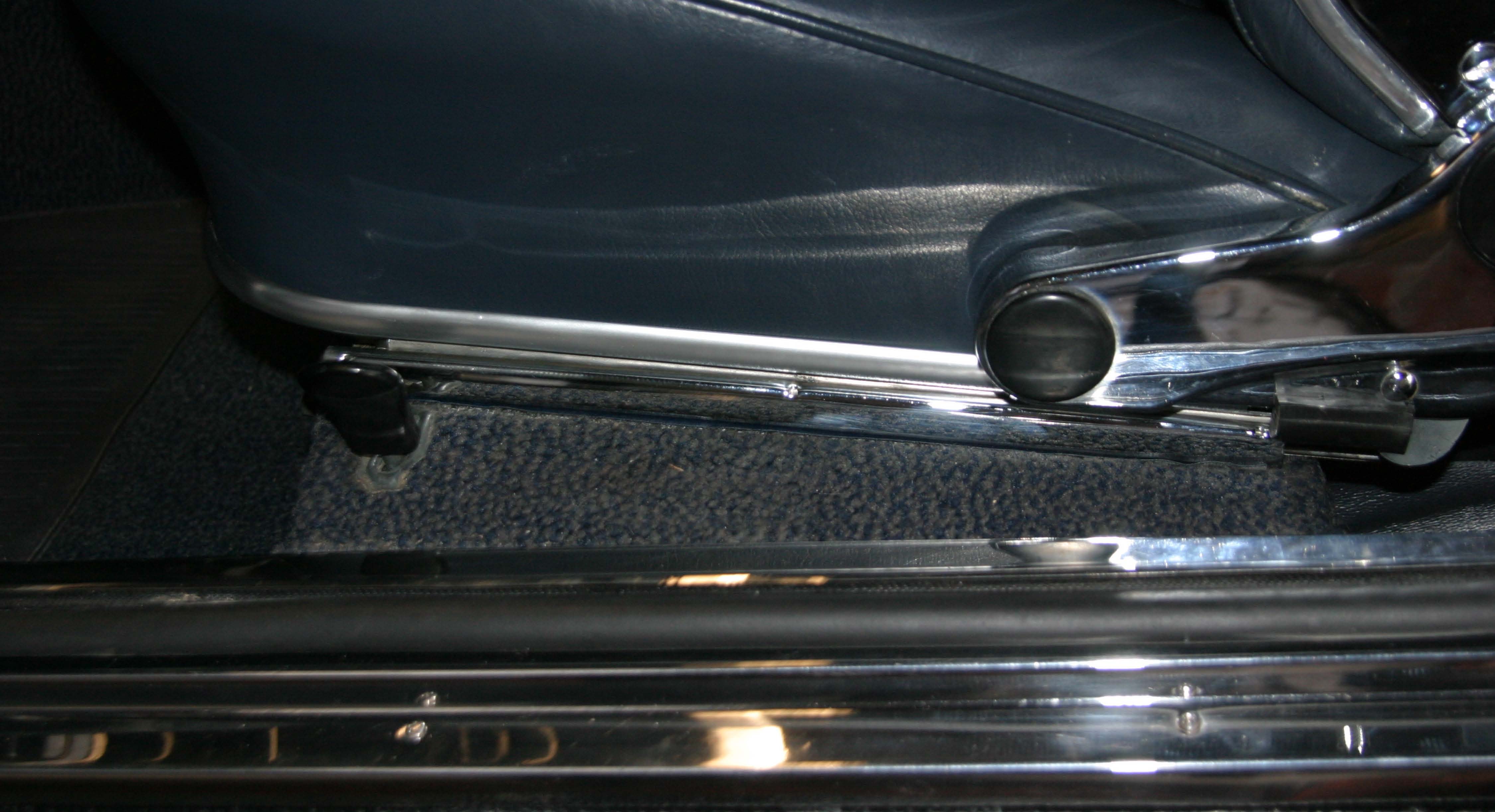

I had mine plated. The key is to have the top rail opened all the way so the zinc gets the front of the bottom rail. The zinc will not throw all the way back in to the inside of the rail so you don't want to find yourself with an ugly exposed surface that has not been plated. On '73 and earlier cars there was a chromed plastic cover that covered and adorned the outer edge of the seat rail.
You can partially see the cover here:

right mike i havent installed mine plastic piece yet
which really covers the whole rail so the chrome barely shows
Paul,
Clear zinc really looks best and you don't have to separate the pieces. The bottom of your seat has plastic chrome hockey sticks as finishers and the lower track has a plastic chrome cover attached to floor.
