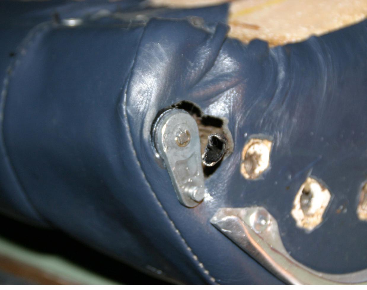

So if your seat release wont work weel
you can pull the cross rod to each side lever
ans its held with a very small circ clip
its made of pot medal and you can use a
paper clip and slide it d and the lever notch
its fits perfect and will tighten so both
work in perfect conjunction.
after furthur adjustment it seems a needle is needed to
make them fully tight
Pics
So its hard to see but the rod has four sides
and the lever has eight faces as in 6 for a socket
so you slide the needle in the open 4 "slots"
then put the clip back on
they get really tight
i set the needle with a small set of vice grips

I think I have a lever on only one side per seat. I will check when I am home.
