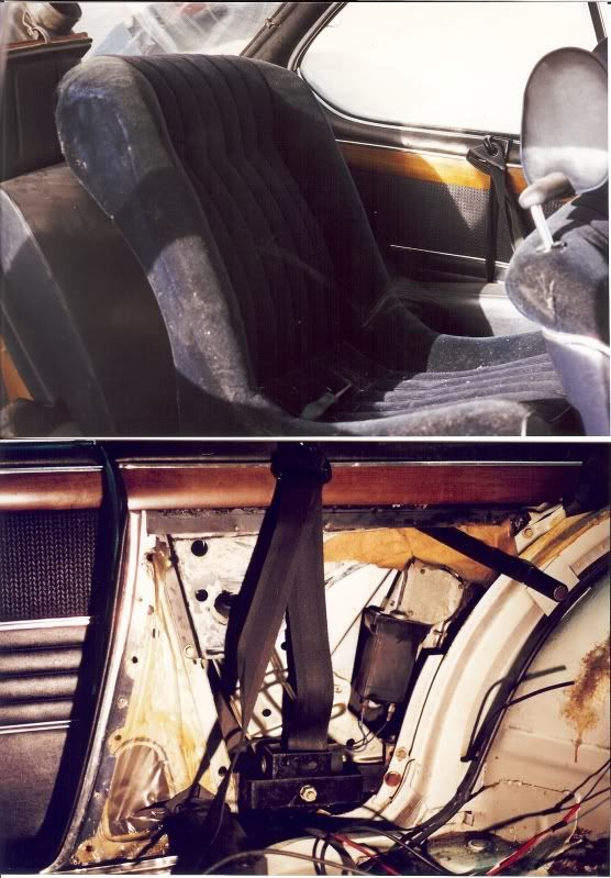

I'm now concerned with the setup of my seat belts - On my car (a UK 1969 2800CS) the front seat belts are fixed (not inertia reel / retractable) and the way they are mounted behind the *rear* seats means the belt basically intrudes on the rear seat passengers!
Has anyone got any suggestions as to how to mount more modern, retractable seat belts for the front seats? Obviously it's not as easy as most cars as there is no "B" pillar above the windows and I can't see any mountings on the lower part of this pillar.

On my old bucket the front belts were of the inertia type. The reel is mounted
below the rear side window mechanism just behind the B-pillar, and behind the trim.
It then comes up through a slot to a sort of hook come loop which again is bolted to window mechanism / trim.
The other end bolts to a point at the base of the b-pillar.
It's a bit of an after thought
I have attached a couple of photographs from when I was taking the car apart - yes it's a long time ago before I had a digital camaera :roll:
HTH
Malc
HTH
Malc

It is a 74
I do have a very rotten 1972 car for spares.
If I get the time I can look in it to see what's there and take some pictures
It is a 74
