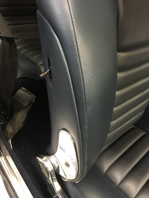

Ok I got them apart, now how do I get the backs off?
Sorry,
I have no idea,
but take good notes 'cause I'll have to put them on!
Thanks,Barry.
very easy they just pop off
start at the bottom
and they are held by clips
start opposite the lever and pry off
