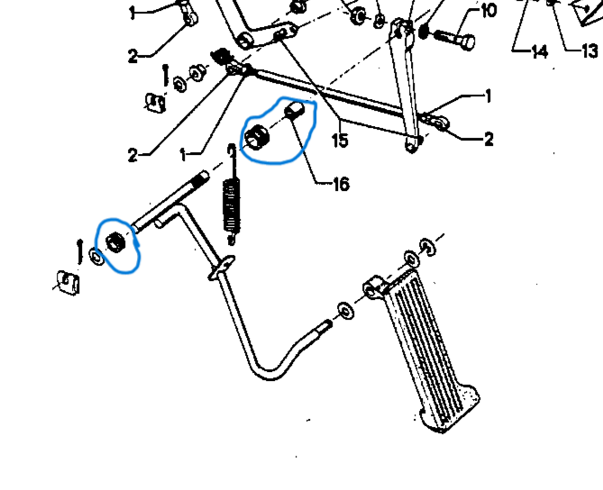

Discovered that my car is missing the Pedal Box bushings for the loud pedal and need to source and install. Box is in the car and seeking wisdom on the install 'technique' (ie: approach from above or from the interior foot well?) and a parts source. Ultimate question: can these bushings be installed while pedal box is in the car?

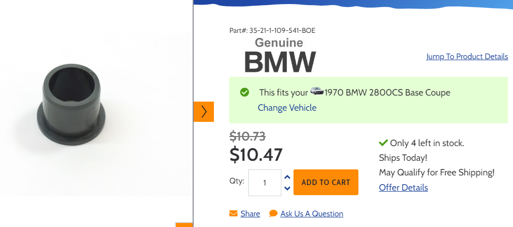

Found these bits at Pelican: are these what I need?

Hi Shannon,
I took mine apart recently (7/72 3.0cs) and mine looked different than what you are showing. Maximilian
shows a part 35414640194 which appears to be available from Maximilian and also from FCP EUro and possible others.

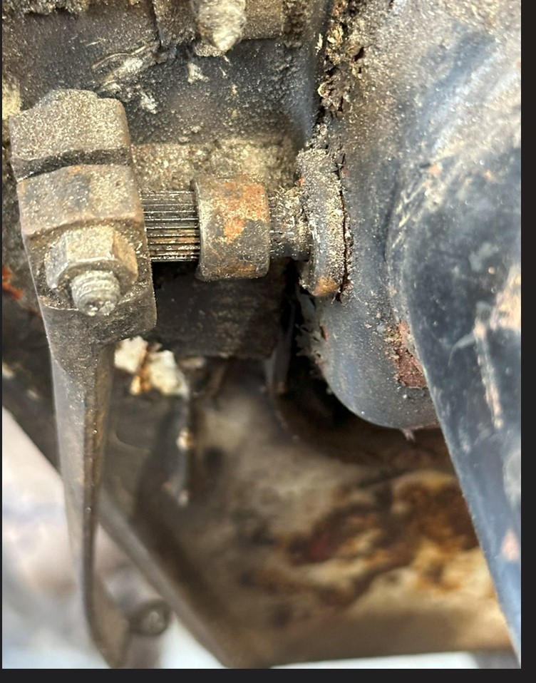

I suspect it will be tough to install in place as there is not much room, but it is worth a try. I have a picture of the side closest to the engine that shows the bushing. I think this is the "easy" side...
In my case it was not easy to i stall. The bushings are not as soft as they might look.
I installed them from outside/engine bay side. Didn’t try from inside. I removed the pedal, placed the bushings and squeezed them in place using a long m8 bolt (or maybe it was m6) and nut with large washers against the bushings.
I was only successful after I used grease on the bushings and holes. However, not sure if that will damage the rubber so maybe a silicone grease would be safer.
