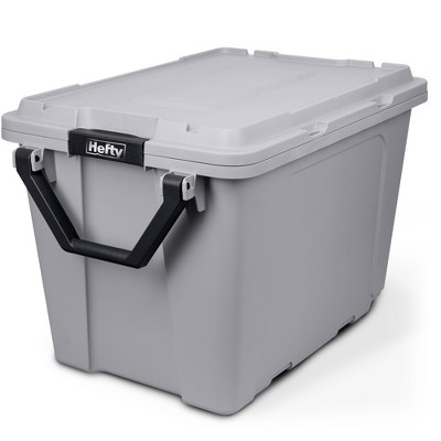

Attached bellhousing or removable? Pictures make it look removable… if so, should be able to fit it into two of these containers - transmission in one and bellhousing in the other
I shipped one in one of the Costco yellow/black tubs but the plastic is too thin, it cracked. This tub has much thicker plastic. They make a 50 gallon one which maybe could hold the whole thing in one. Use Pirateship to purchase your label, just enter size, weight and address. Will be about 50% off the price you’d get at the ups store
Agree on above, also found it useful to put the transmission in a garbage bag and then fill all the dead space with expandable foam insulation - one can or two will completely fill around the transmission and that thing ain’t moving
JC that is really good advice and a can or 2 of that expanding foam is cheap and doesn't require a lot of labor to crate ... as long as its wrapped in that plastic bag so it doesn't require carving it off the part.
