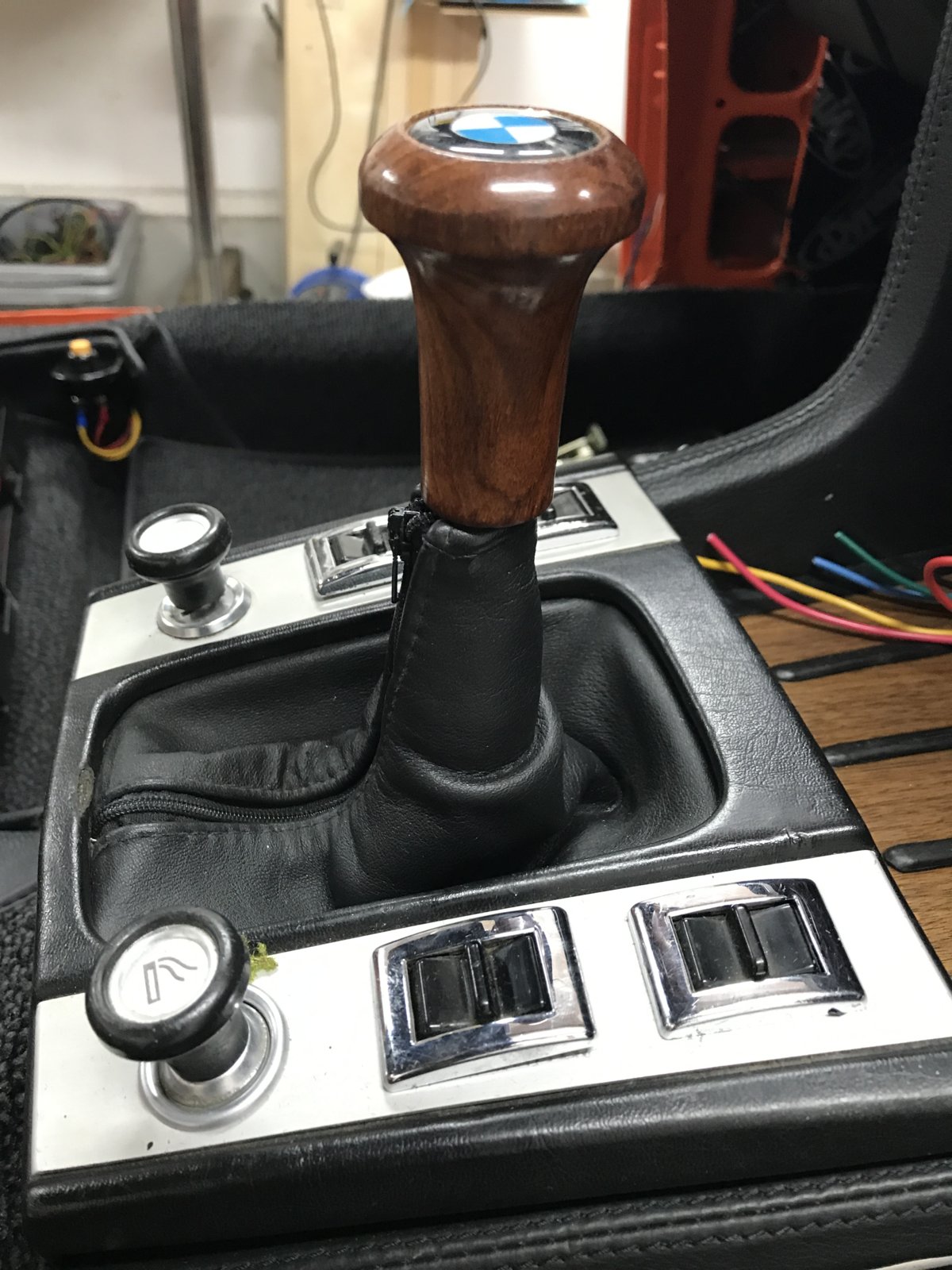

I made one for my Bav out of a shift lever I got out of a newer BMW in the junkyard. I stripped it down to the bare rod, installed some new bushings, and made a shift knob from a Louisville Slugger. I also lengthened my connecting rod slightly to get the angle I wanted on the shifter.

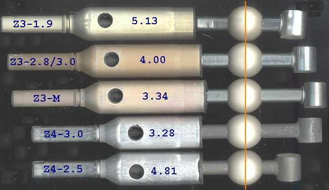

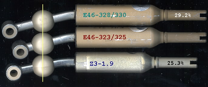

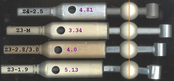

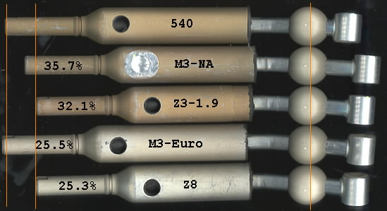

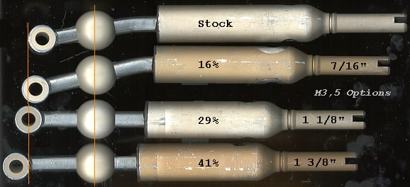

I have the 320i lever Steve references in his link. I pulled these pictures off the net years ago when I was looking for a short shifter for my 540 6 speed. These do not include the shifters for our cars, but they indicate a way of thinking about the change:

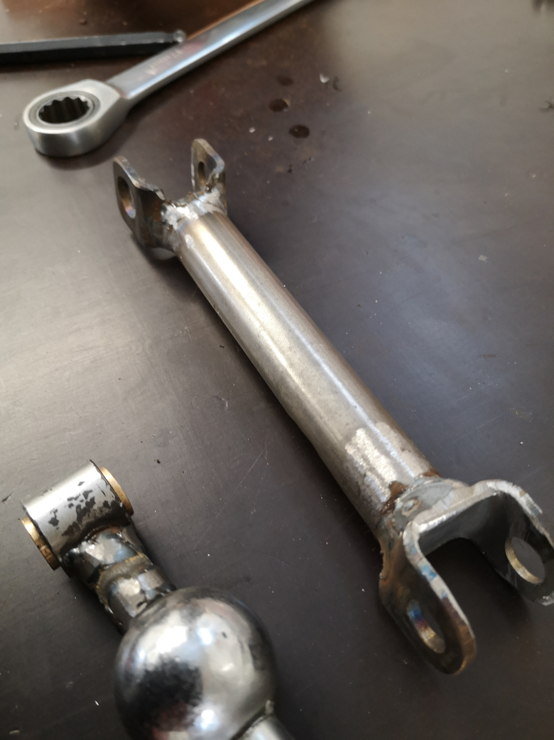

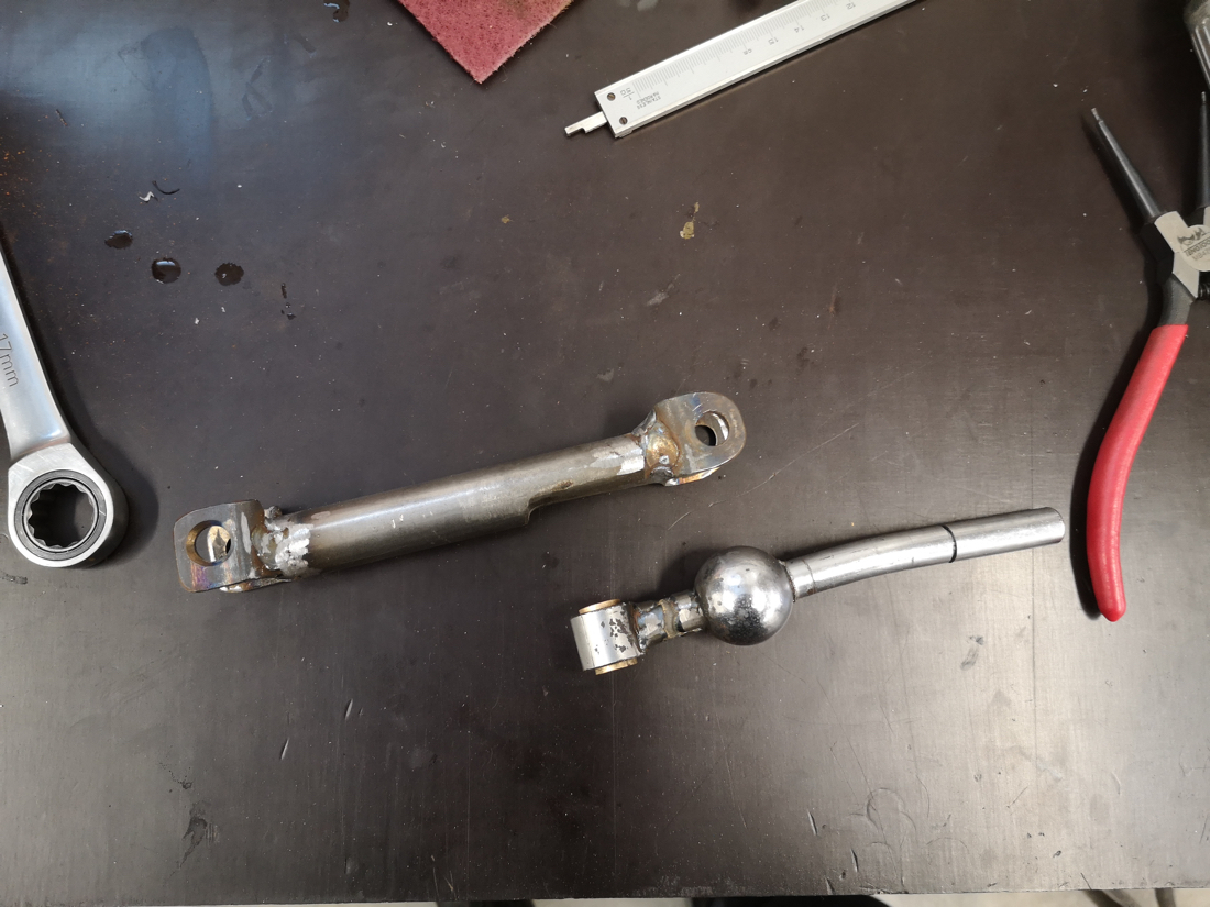

I went el cheapo on my shifter and lenghtened the rod under the ball to make it a short shifter, then continued in the same spirit and welded up my own DSSR.

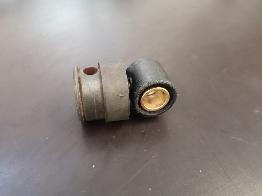

Thanks to @Stevehose and his thread already linked here, I ordered bronze bushings to replace the tired plastic/rubber bushings in the shifter + rod joint.
While they don't look like much:
They're well hidden in the car, and works very well with little slop and crisp shifts:
The UUC route is definitely easier and more elegant, but shipping and taxes killed that option for me.

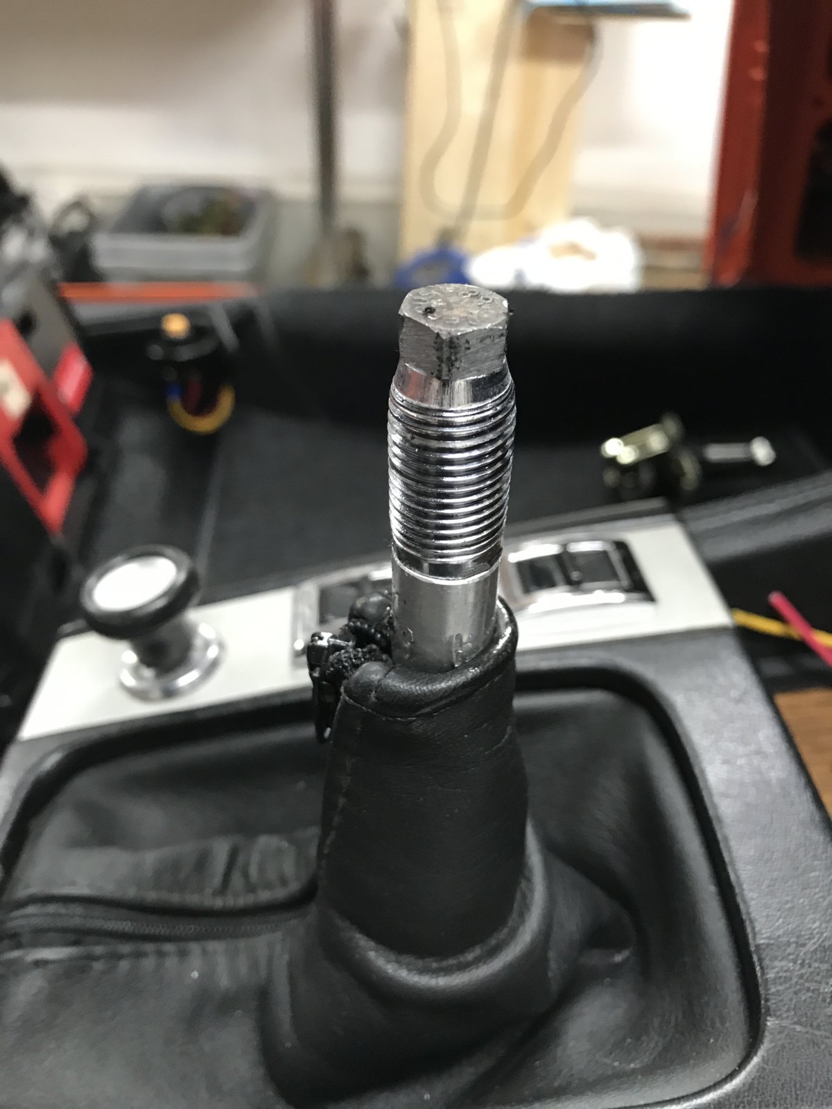

I also use a Z3 gear shift rod. Used the threaded top of the old stick and bolted it on to the top of the Z3 stick. Works fine.
The Z3 stick is aluminum and the old stick is steel so welding was not possible in this case. I think this is the way to solve it without involving workshops with advanced tools. But you have to drill a hole in the new stick and make threads for the bolt.
I used a 8mm bolt so the head had to be grinded to allow the gear knob to enter, but you can use a bolt with Allen key head to avoid this. The bolt and threads was soaked in epoxy glue before I assembled it. It will never fall apart!

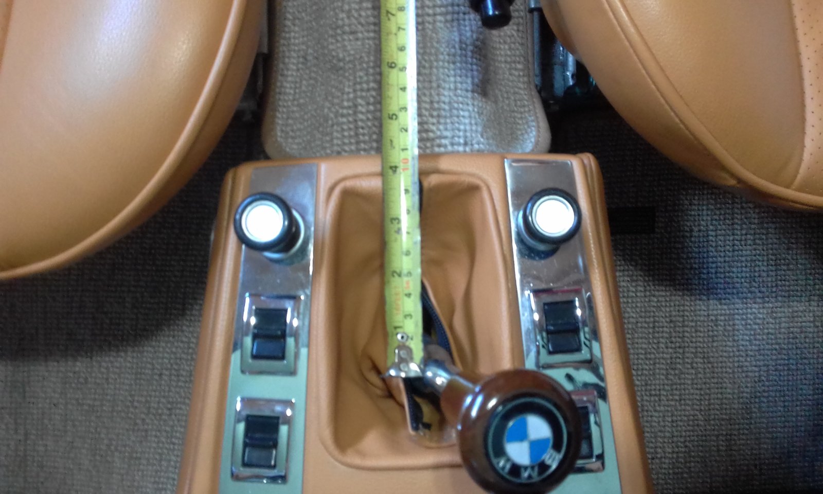

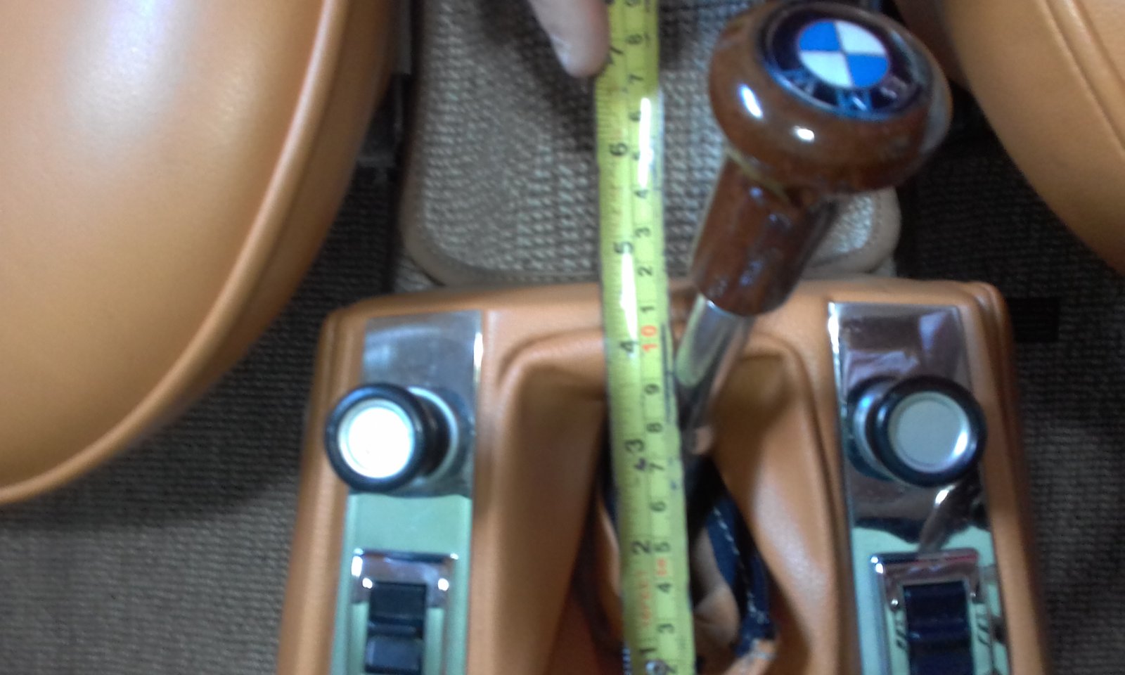

Below is my current throw 90 mm from 1st gear to 2nd.......measured at top of console.........what would the numbers be on a short shift???
Yes I'd say mine is a "shorter shift" than stock, but not clickity click like a real short shift is.

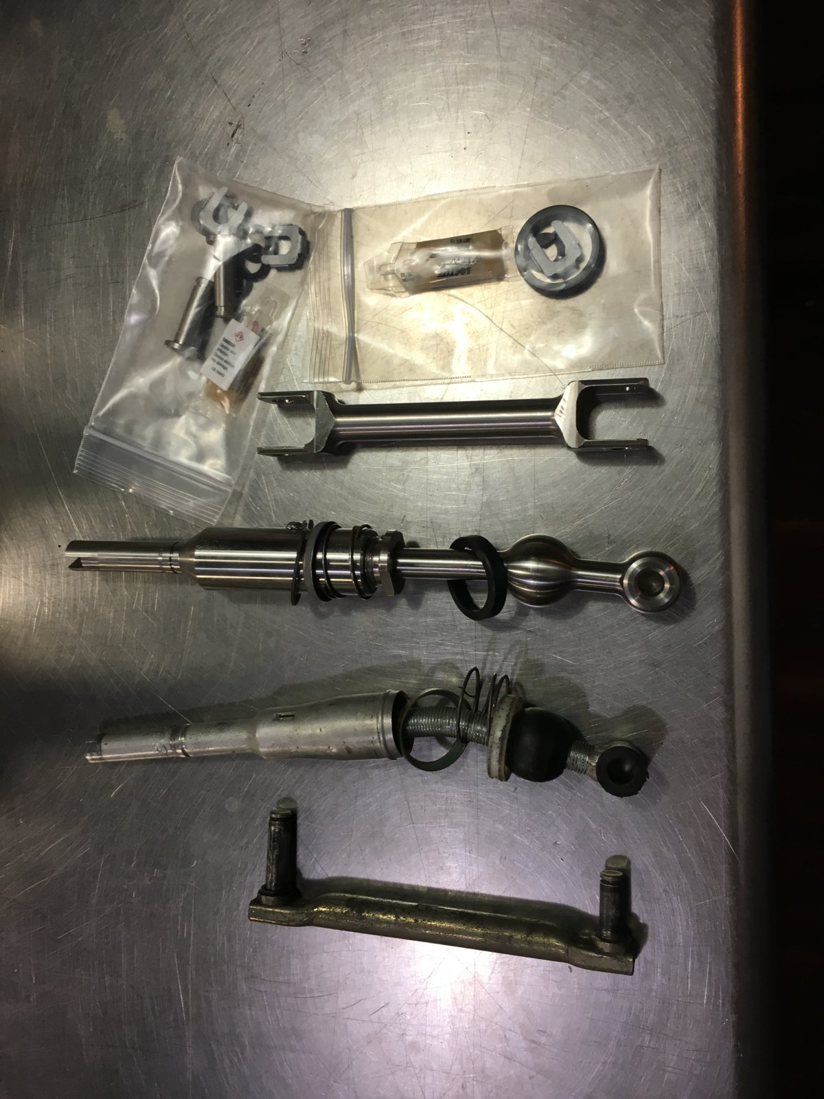

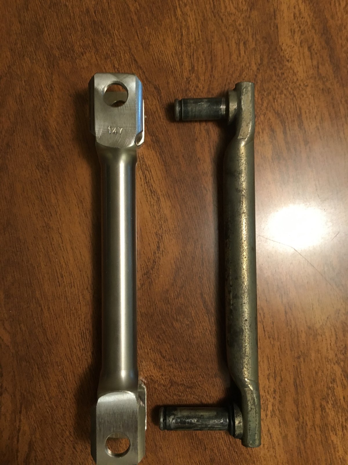

I also have the UUC short shifter on my 5 speed with their DSSR. The shift lever had to be bent to allow the shifter knob to be easily reached when in 3rd and 5th gear. The original shift lever was also bent. There are previous threads about all of the levers that have been used. The key is the positive solid feel of the DSSR. Here are pics of the UUC DSSR and what was in my car when I bought it.
