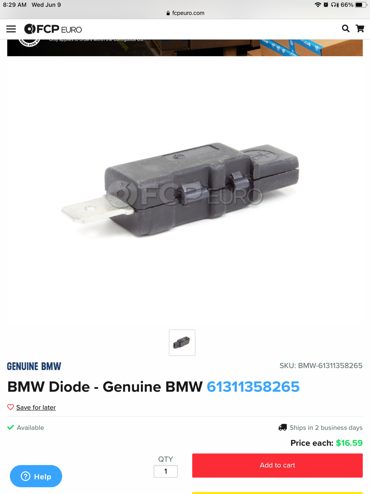

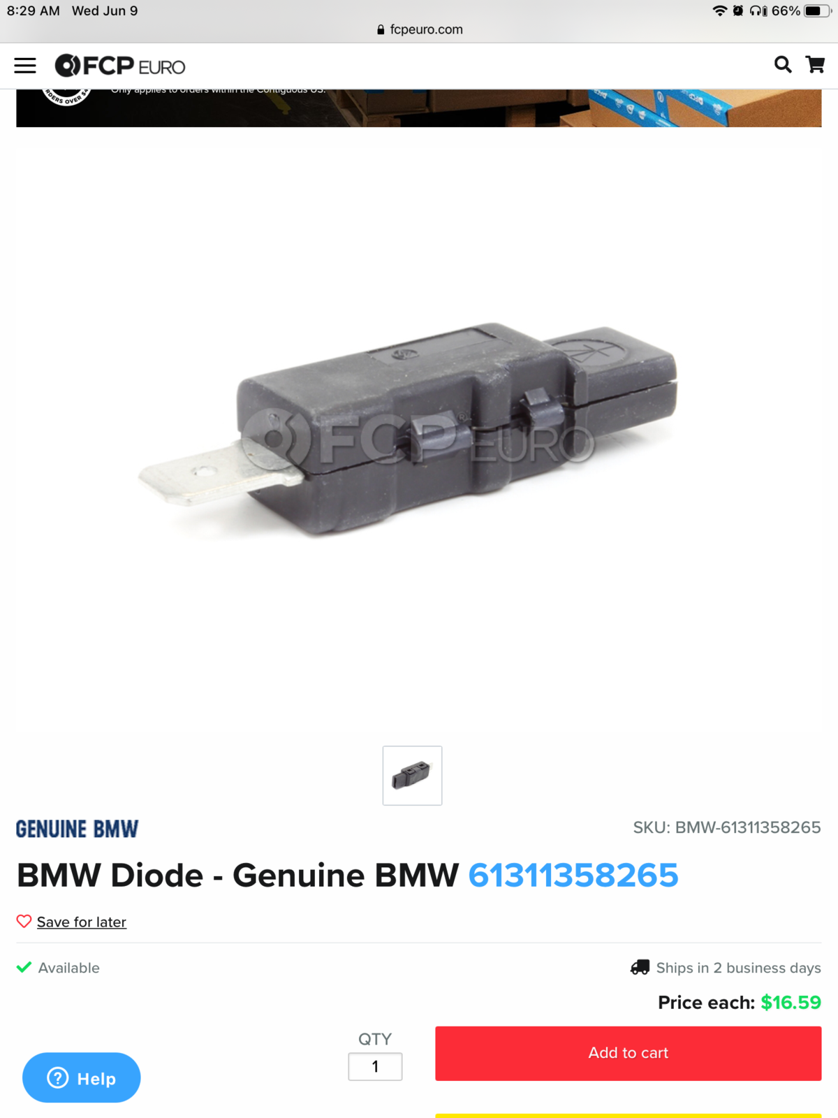

we actually run 40 amp fans so hot through sensor is no good!
to be clear— at shop we run green wire from coil to fuse to sensor.
from sensor to pin 85 of relay
from pin 85 to diode to compressor connection

Simple operation with diode - engine hot turns on aux fan but does not turn on compressor
