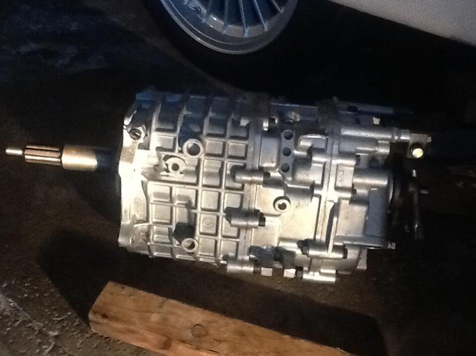

My Getrag 265 says
26205190 (the last two digits not relevant)
225 1.3
And looks like this. Buy a new slave.

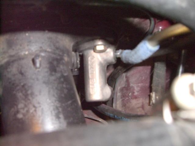

Your new clutch master if you buy one will be oriented a bit to its side so just bend pipes or modify as needed. It's the only one available these days.
