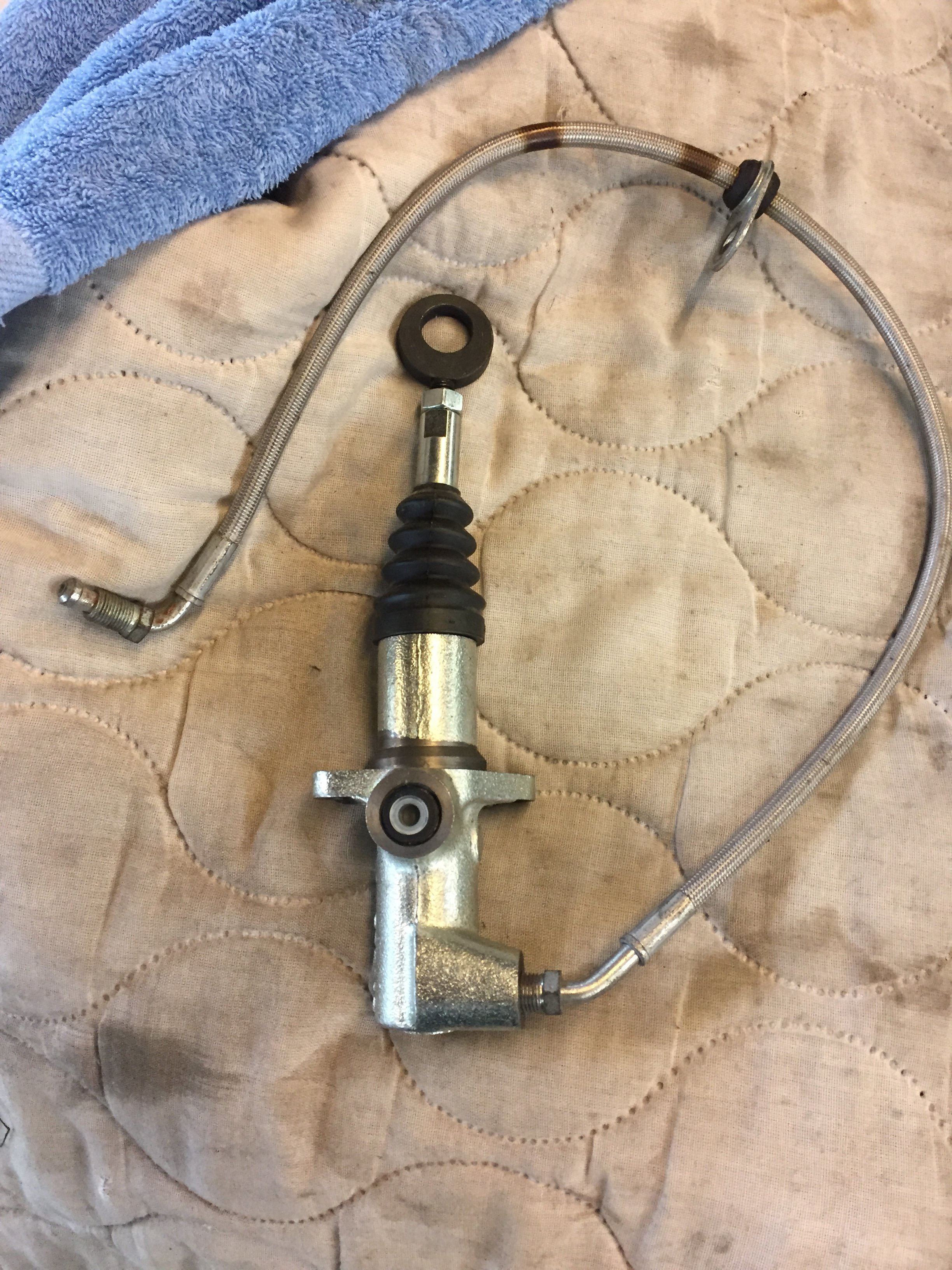

made it to Monterey and clutch went out after 400 miles, no parts available up here, looking for options. We think new slave sat on shelf so long rubber seals are bad. Four speed tube style slave.

Sorry to hear it, Chris. What was the mode of failure for the master cylinder? Hydraulic fluid leaking out? Did it come into the cab and go under the carpet? The couple of times I've been stranded by my master cylinder it has been because the retainer clip got loose. I found it under the carpet with all the fluid.

How about rebuilding the master? I did mine its only a couple pieces and kits are everywhere.

You want this?
There are a couple ways to do this
I like using the factory pipe cut at the master end about an inch or two and then hose to the reservoir
Between Macha and Burger- they can do anything.
Wyman left at 1:15 with the goods,
