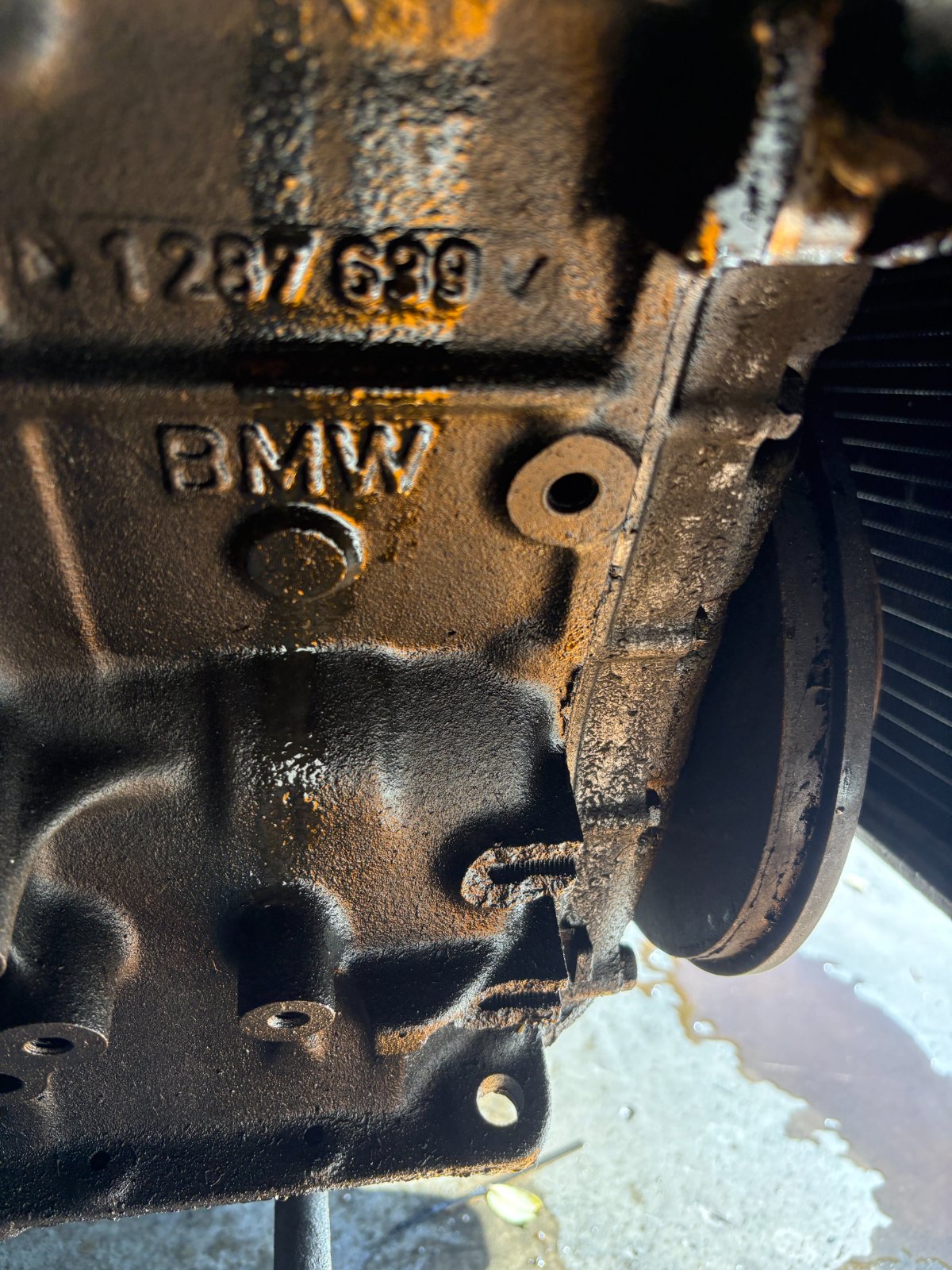

Snapped off A/C compressor bracket bosses on my 3.5L M30B34
KF6TRG
79
13
Orange County, California

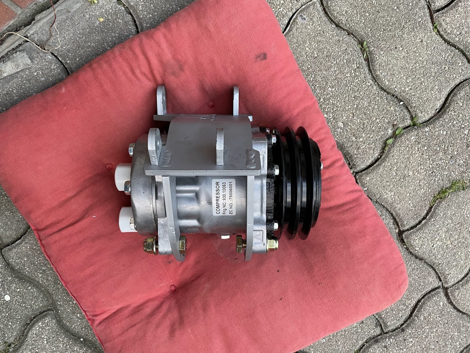

Hello all! I have this unfortunate situation of snapped-off A/C compressor bracket bosses on my 3.5L M30B34 engine in my 1973 E9. I am told that a forum member has made custom brackets that use the side-facing bosses to attach a modern Sanden compressor - I hope that is true? Please advise me. Thanks, Alex

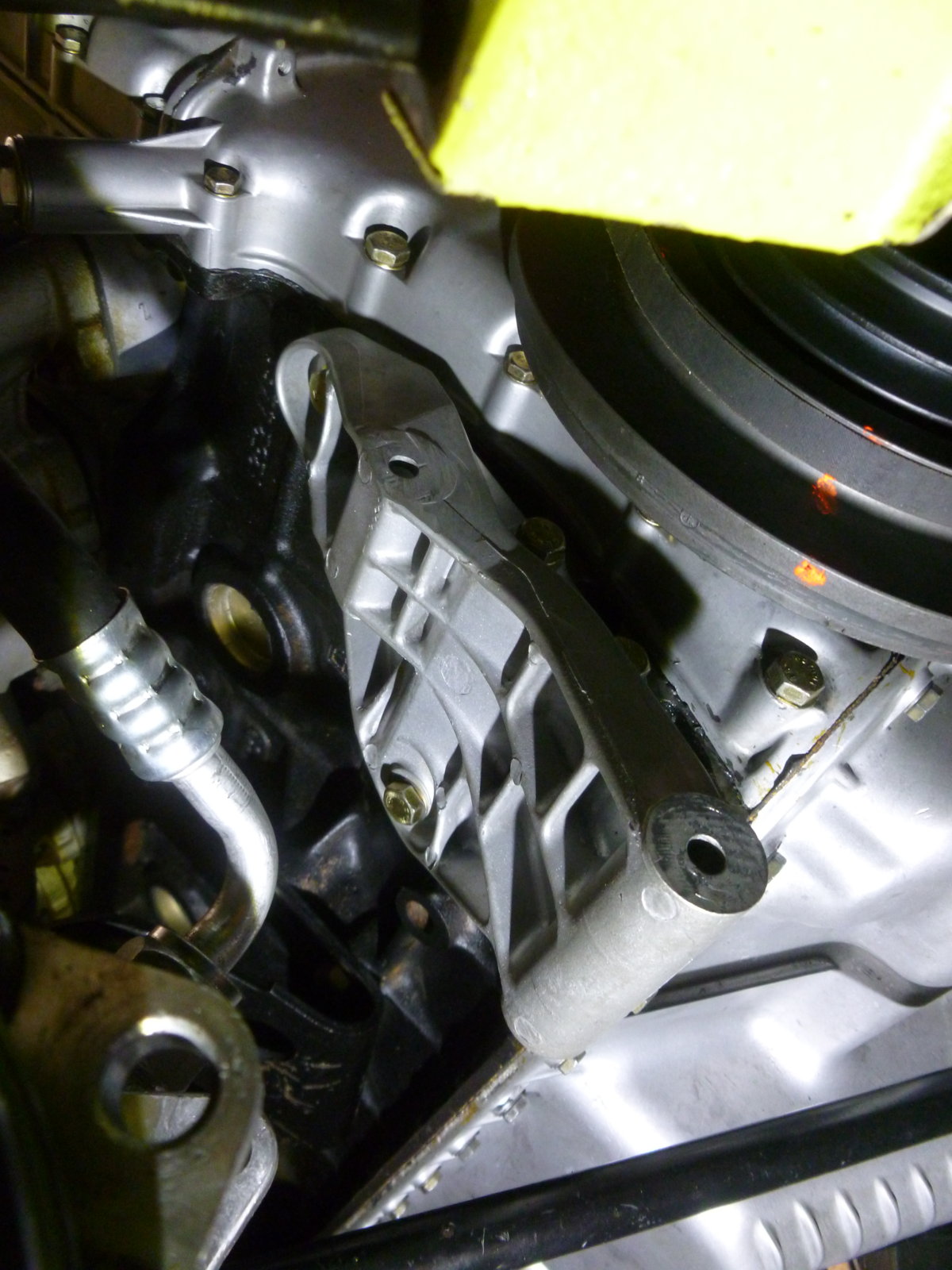

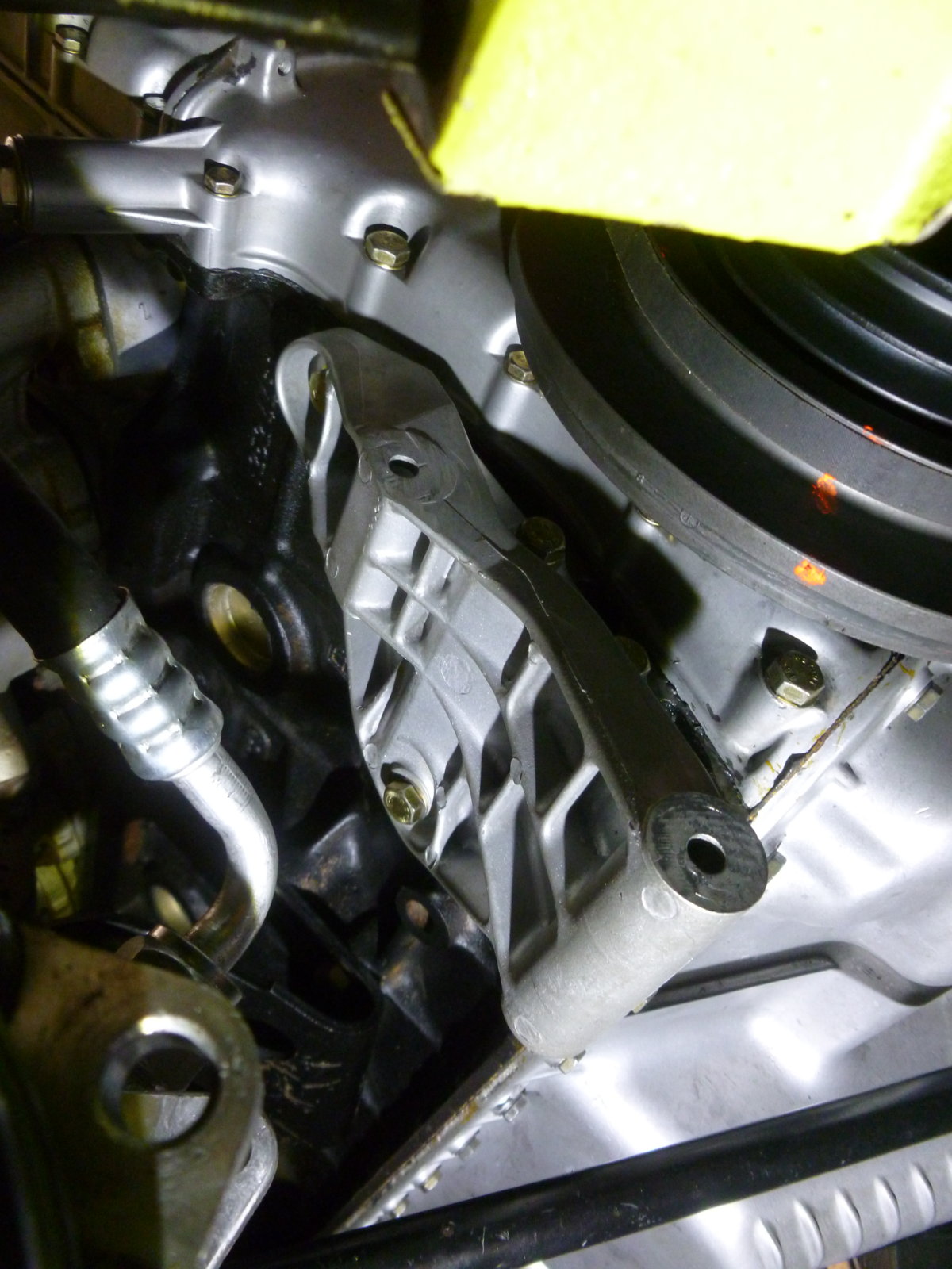

the best bet is the WC Layne bracket - look it up in the FAQ - top sources. in order to mount it, you need the BMW wing cell bracket. i have this on my euro b34 engine and it fits great.
the wing cell bracket:
The custom bracket from LC Wylie that bolts into it:

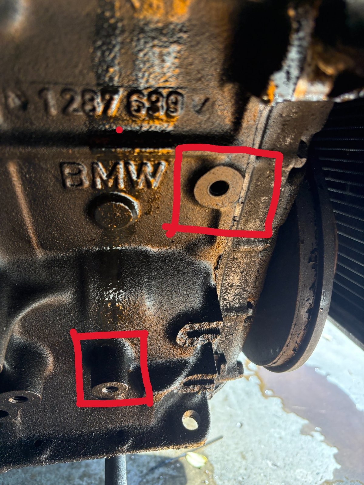

if i remember correctly, the wing cell bracket mounts like this. but in looking at the drawing, it also bolts into the 2 missing bosses
