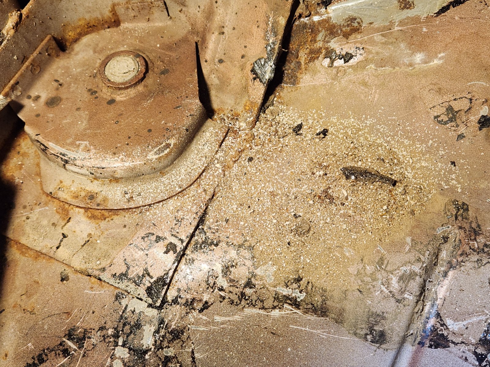

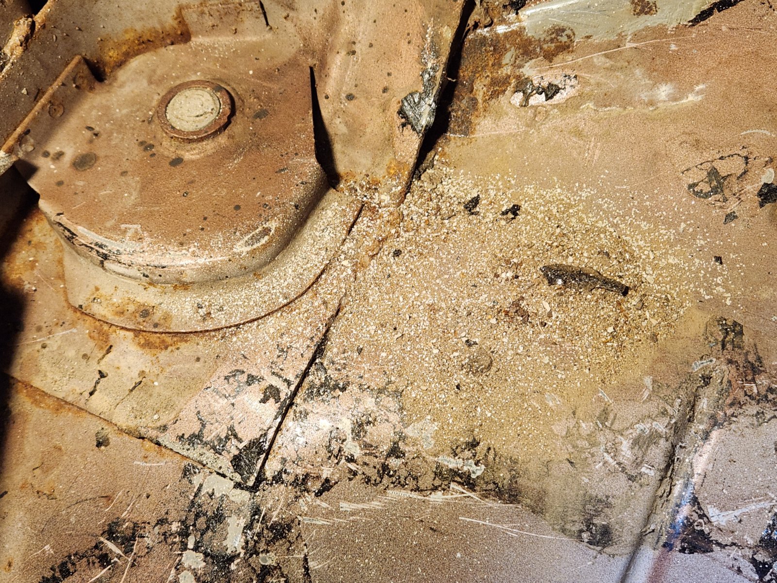

I've removed all the asphalt/sound-insulation from my interior. In the interior area under the rear seats, above the rear pushrod rubber mounting, I found half cup of sand when the asphalt peeled off. (BTW this material only contacts the metal like 60% of the area it is applied and this was a air pocket ares)
Where did this sand enter the interior? How should this be sealed up? In the picture I can see a gap under the push rod receiving bracket but shining a light in the gap does not show under the car.
Here's the pictures >>
Does anyone know?
My car began its life in the Arabian peninsula so I know where the sand came from... but what path through the chassis?

I’ve got sand… but I know why.
As long as there is no rot good old fashioned seam sealer will take care of that.

I think i know how it entered your car:
The thick steel bolt that holds your rear subframe goes through the floor trough an opening that is twice or thrice the size of the bolt. The area used to be sealed off with a foam donut piece, which almost always has disintegrated over time. So, there now is a direct opening from under your car into the shell.
I think you have sand on both left and right side?
I also think that the light may not shine through as a PO possibly has blocked it with undercoating, or just backed up mud.
Not easy, but I think the best remedy is to seal it from the bottom, when supported well, car up in the air, i think yould could remove the rubber mounts and clean it with the axle in place, but unscrewing the rubber mounts is a pain as asscess to the nuts/head is difficult. Thus possibly axle out.
Only sealing it from the top will make it a moist catcher.
I think...
