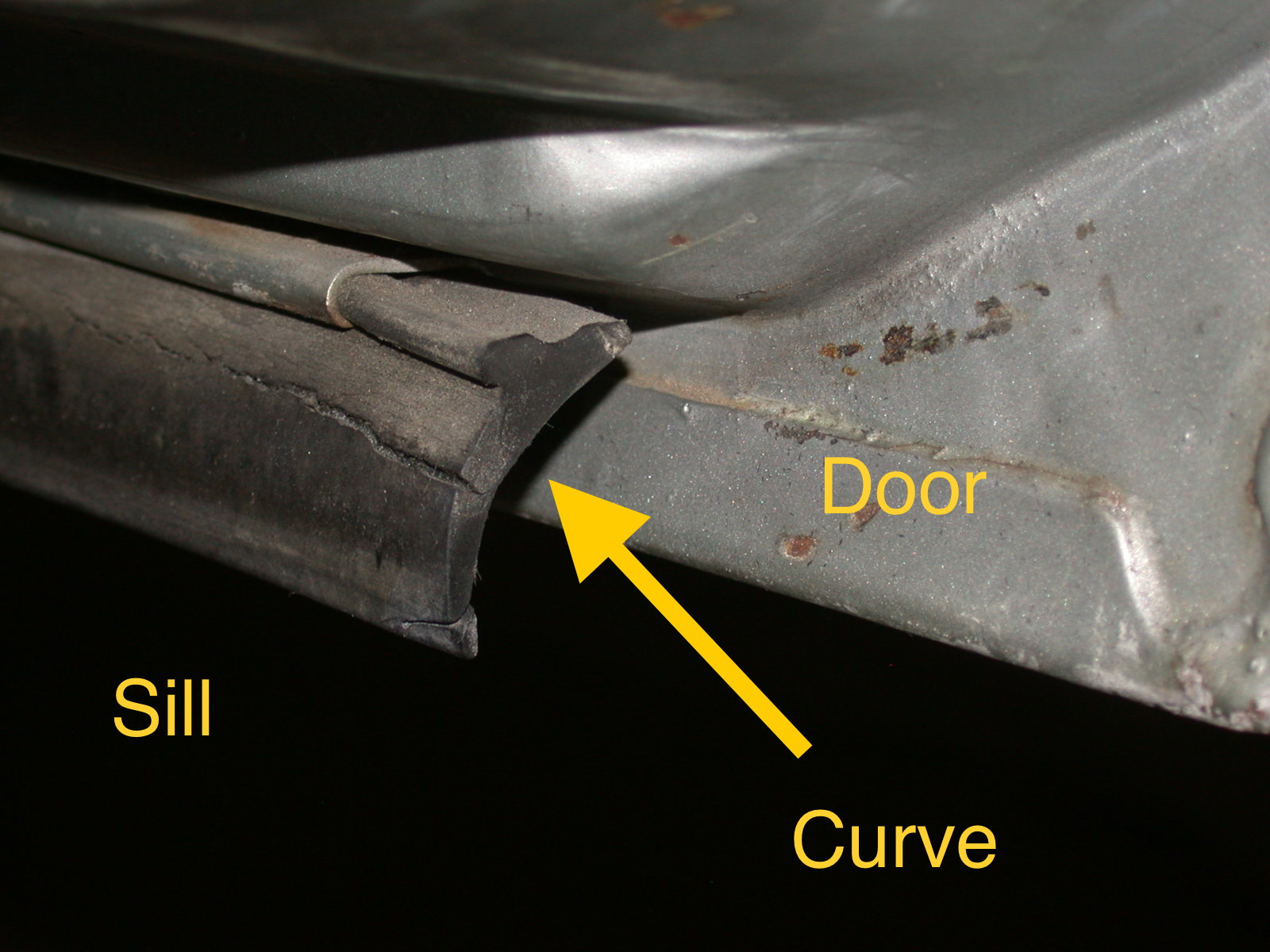

so who has a smart way to put this piece of rubber in

anybody had success with this? getting the 2 ends of the rubber into the slot. getting the outer edge in is relatively easy ... getting the next end in ... not so much. i also tried putting the inside one in first, but didn't have much success. appreciate any recommendations
Clean the rubber, and the channel, and lube both with some Ivory dish soap. The rubber will be a somewhat slippery, so you may want to try some of those gloves that have little sandy grit on the fingers.
