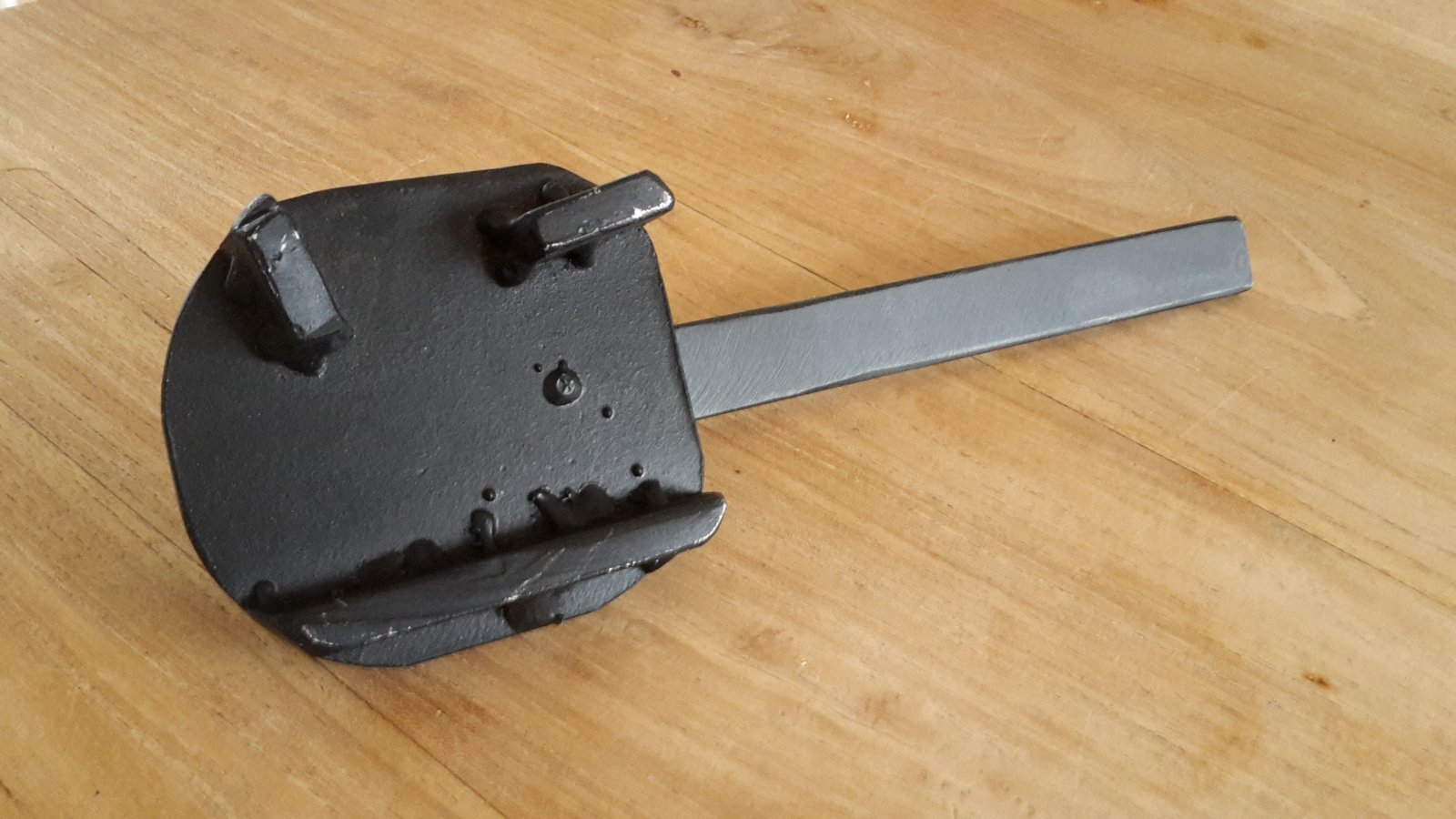

here's a pic of a tool I made to screw and unscrew. nice thing is that it does not deform the tabs on your sender unit intact.
I like the PVC alternative mentioned above. A lot easier to make, and (suprisingly! ) strong enough.
