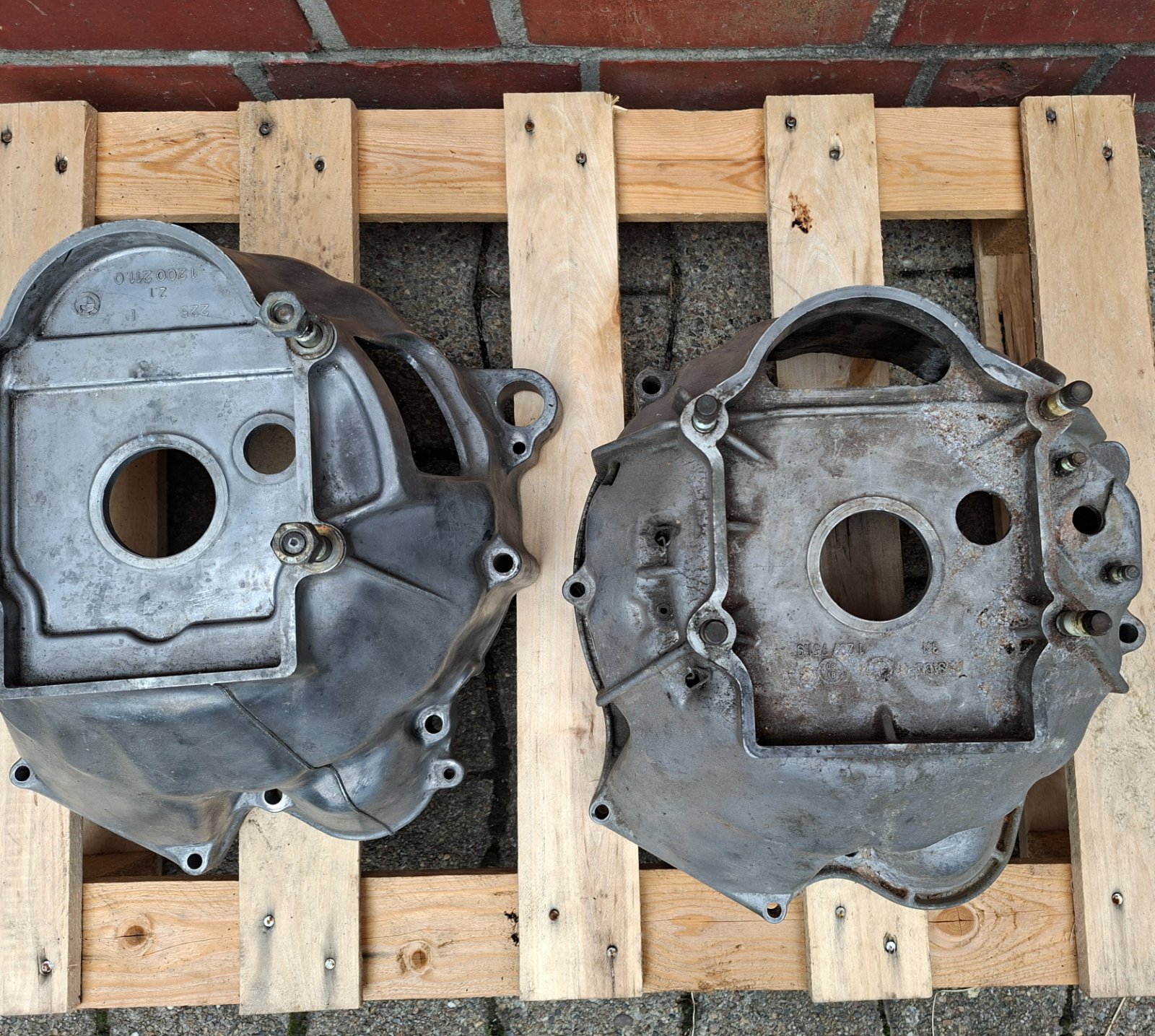

so there are two versions of clutch bell housings and their corresponding slave cylinders.20250804_152742.jpg
The early version attached outside the bell housing, the upper one.
The later version attached to the bell housing by screws.
If you want to install the "Sportgetriebe" Getrag 265/5 you may use both versions.
If you want to install the "Schonganggetriebe" 265/6 only the later version will fit.
Both slave cylinders are still available, at 270€ and 50€ e.g. at W&N

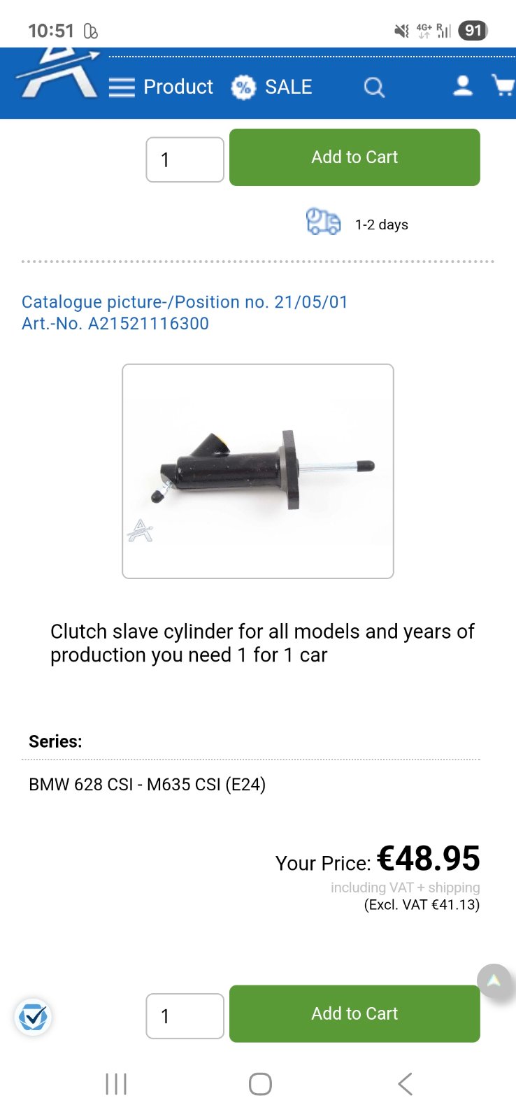

I also learn that the clutch bell housing I have (with the large rectangle opening) is the wrong one for my 265/6 Getrag.
Would you happen to have the later model bell housing with the screw points for sale as well?
Is this the correct slave cylinder (I looked it up on W&N through the 6 series parts):

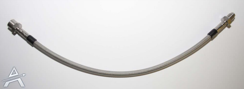

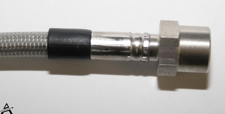

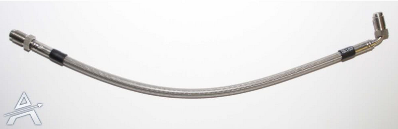

Thomas, is there a difference in the hose type at the clutch master between the early and late models? my hose is most like the top hose. there is also a difference in length - 330 for the early hose and 370 for the later. notice the end difference on the later hose. bottom line is, if you have both types, i would prefer the early type ... if you only have the later type, i can just buy a new hose.
these are pics from W+N on their stainless hoses

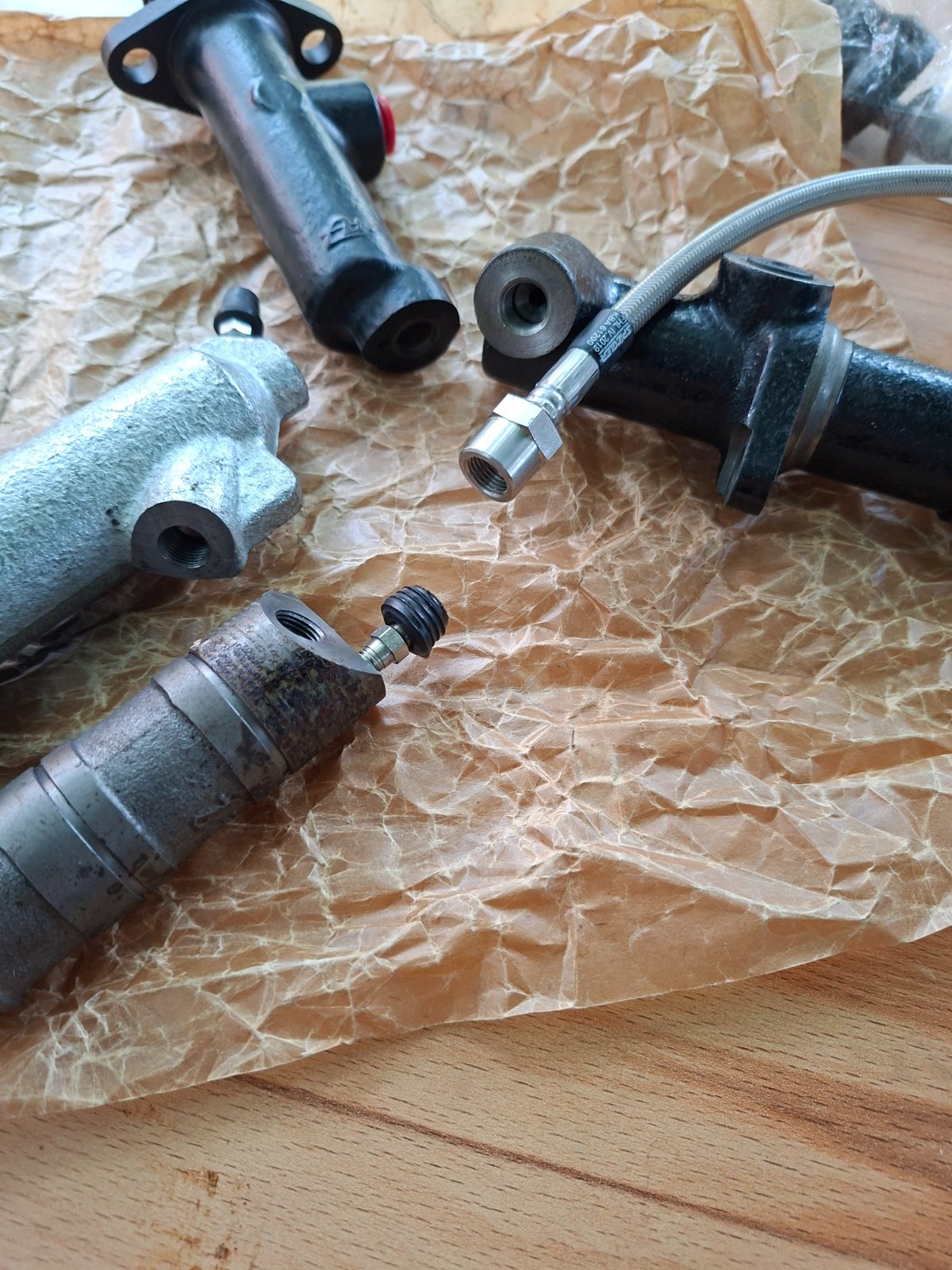

Well,
let's have a look:
Two different types of masters, two different type of slaves but only one screw joint that fits all.
This W&N screw joint does not fit any cylinder.
You may have to install a short brake line between this pipe and the cylinder.
Anyhow, I guess the one which is already installed in your car should fit!
