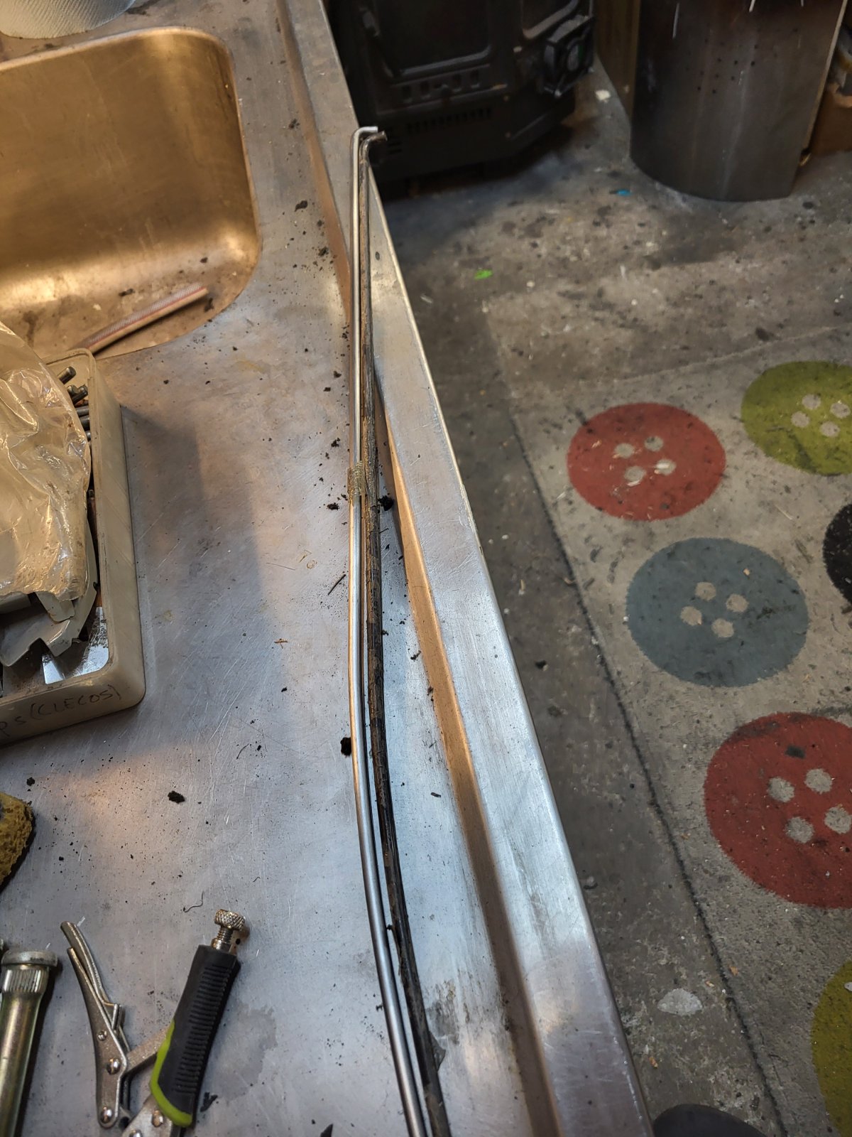

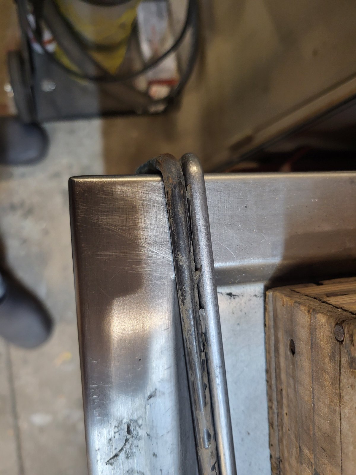

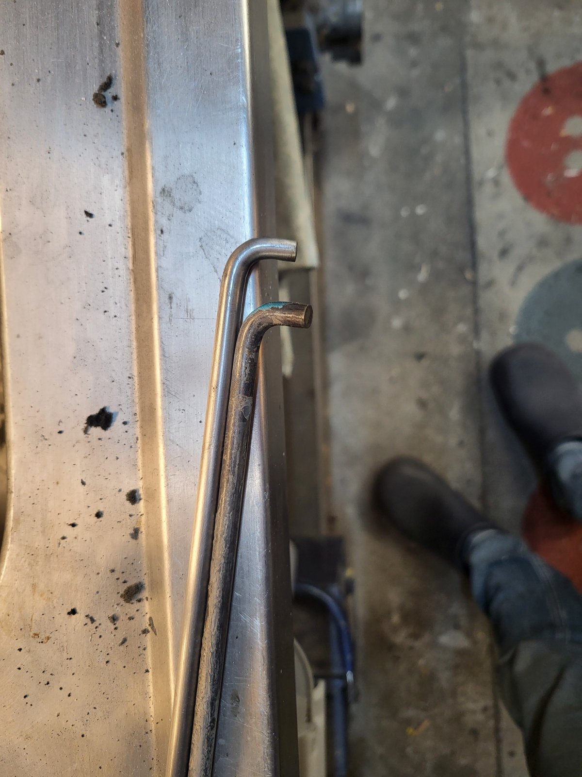

As i couldn't understand why the tubes of the 2 systems described above are different in length, I decided to pull the springs from my old (now refreshed) system and also from the recently purchased green one which appears to be 20mm short.
What would you guess?
Different lengths of the springs as well!
Why on earth would bmw have made 2 different widths? Is the narrow one a 2000cs system? Do they have a comparable mechanism?
