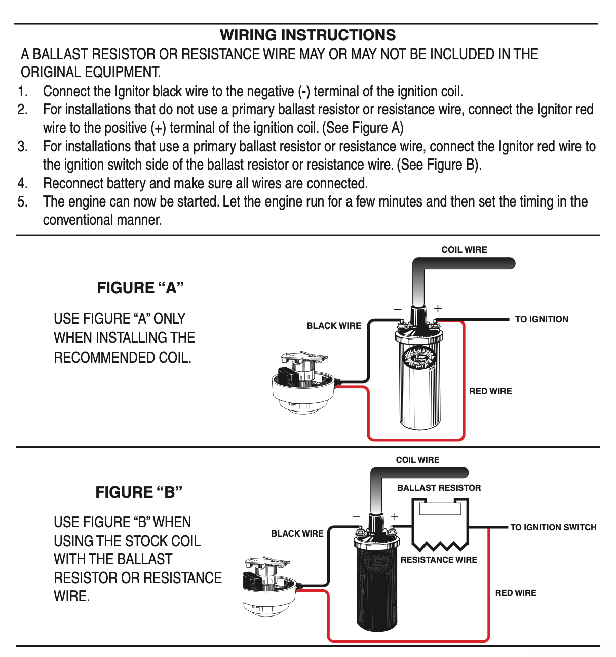

2. Using multimeter to test, ignition coil has 12V at its positive side and had 5V at negative side (with MDS black coil). Ballast resister had 10V on top dropping to 1V by its bottom. Under Don's direction, removed ballast resister from system and wired both ECU lead (white wire) the other wire going to ballast directly to the ignition coil. Getting 12V on one side, 5V on the other. Firing the starter did not give me a spark out the top of the ignition coil. Question became whether my new ignition coil is the problem so I re-installed the old Bosch blue that was in the car at the time of it running. With that one, see 12V at positive and 1V at negative. No spark out the top when firing starter. Interestingly, when removing the black wire going from ignition coil to the distributor, the voltage at the negative side of the coil is 12V and voltage at tower is 12V. So when distributor is connected and car has key turned on but not cranking, the distributor being connected is causing 11V drop across the two leads of the ignition coil.

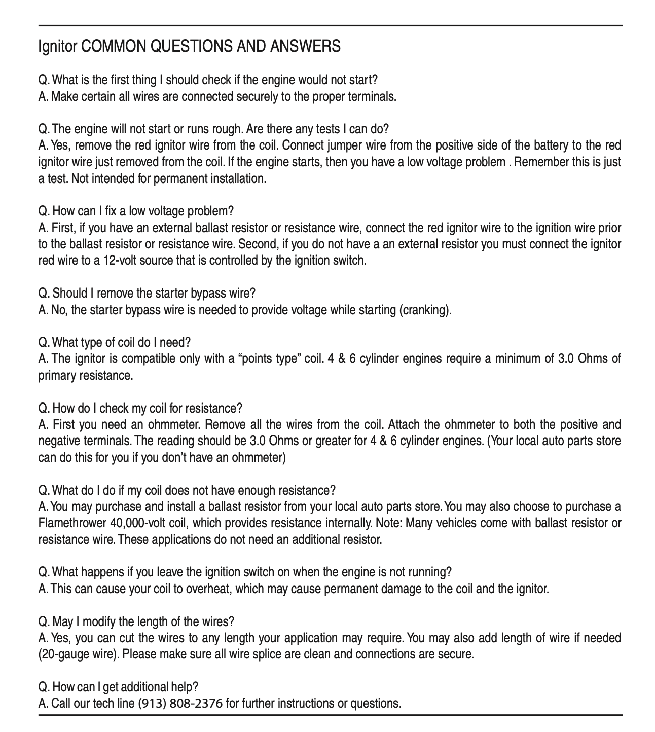

1. Utility in changing out the Pertronix unit? It does not have a model number on its side, only a lot or serial number, but from assessment online should be replaced with a 1868 Pertronix unit

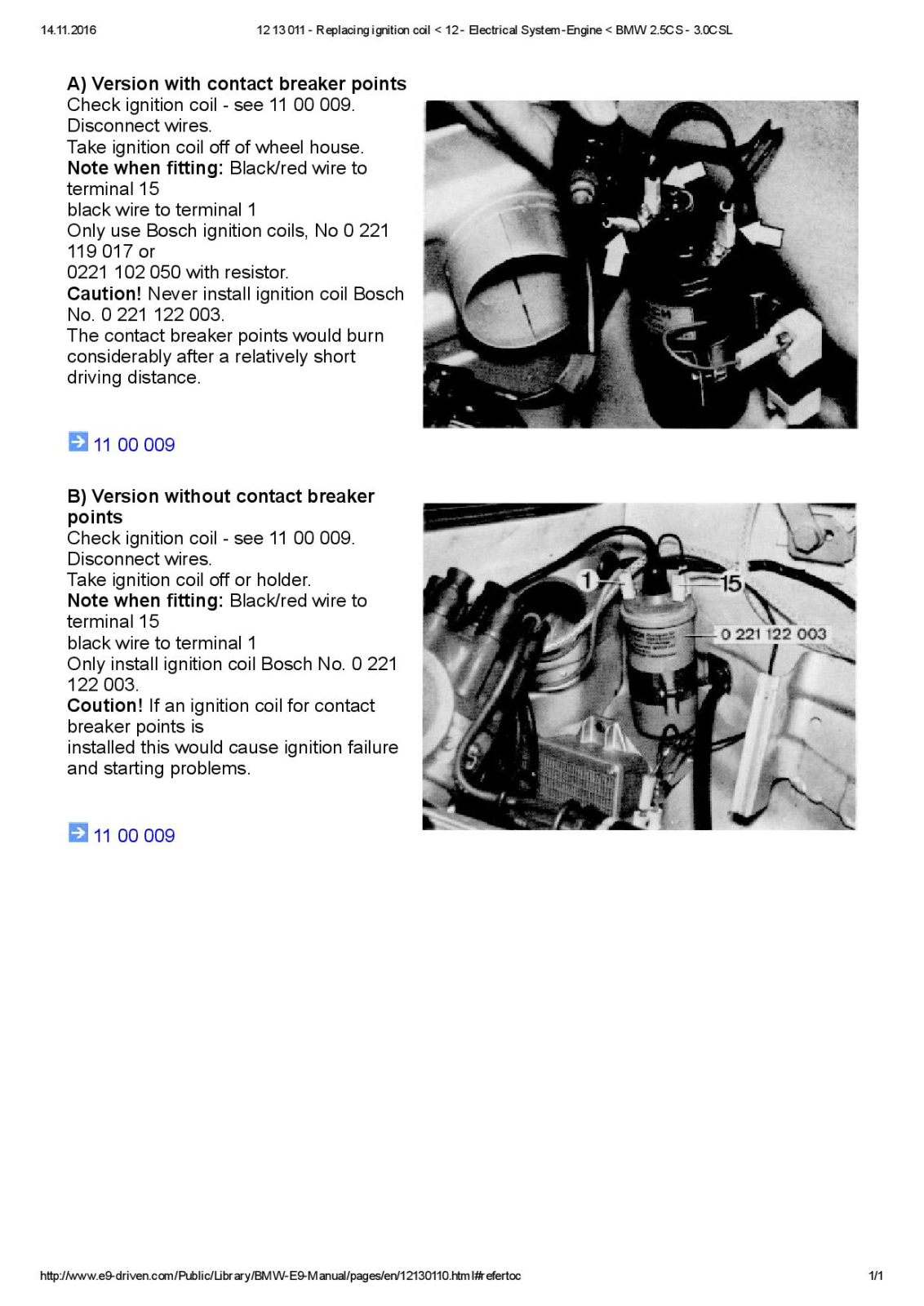

2. Utility in a new Bosch blue ignition coil? The blue appears to have internal resister so would allow me to keep the ballast resistor out of the system, which may simplify things.
