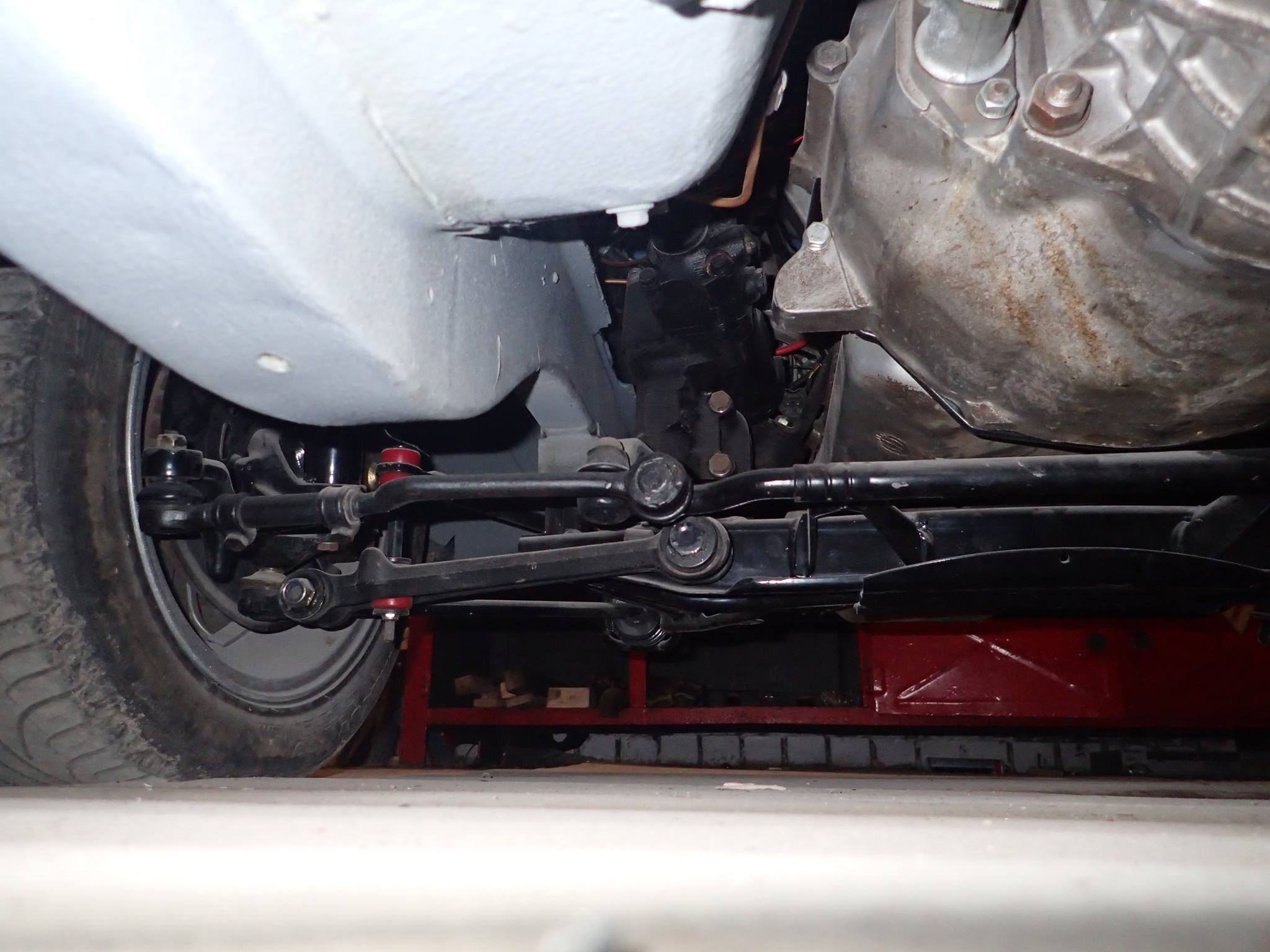

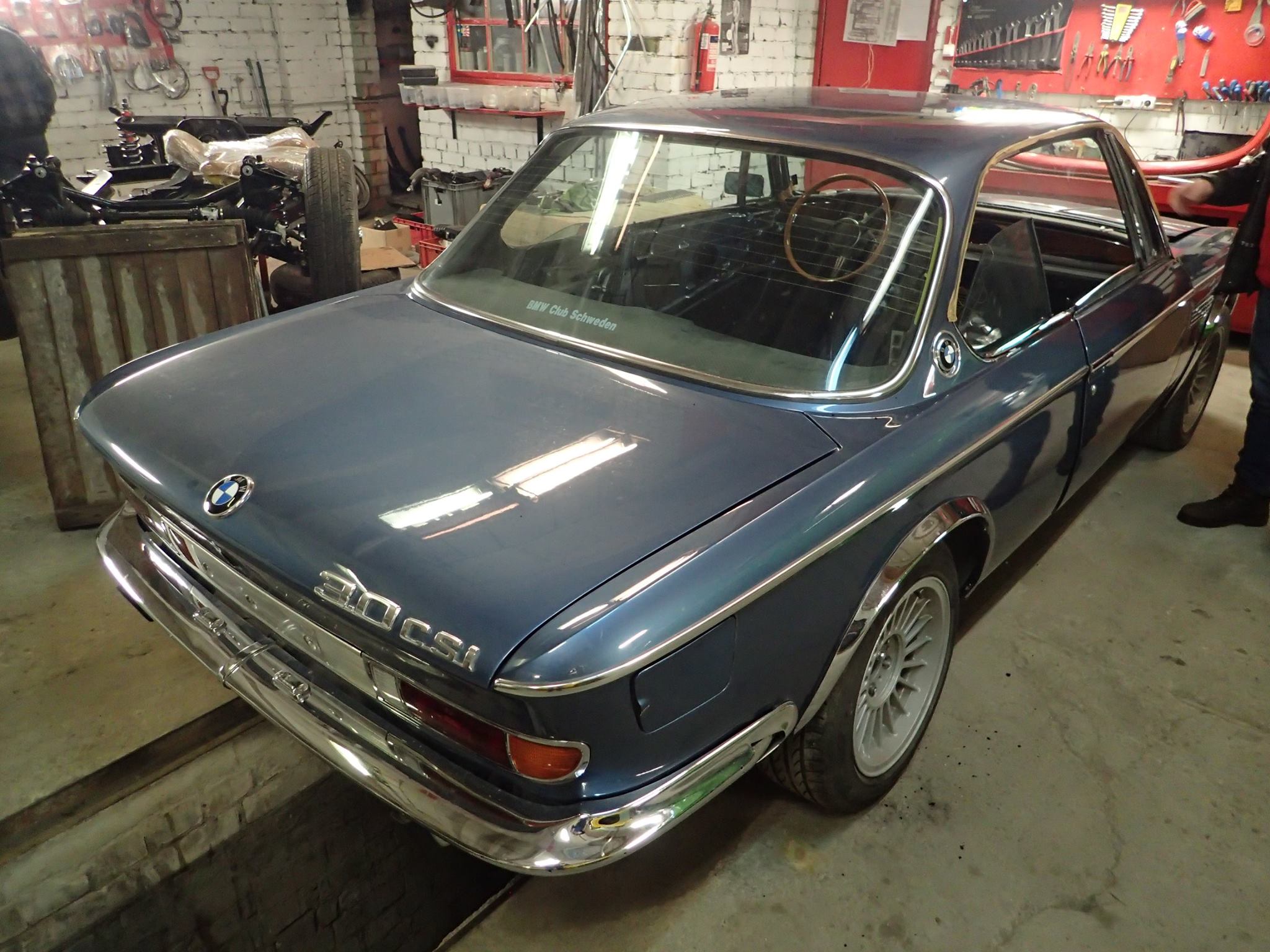

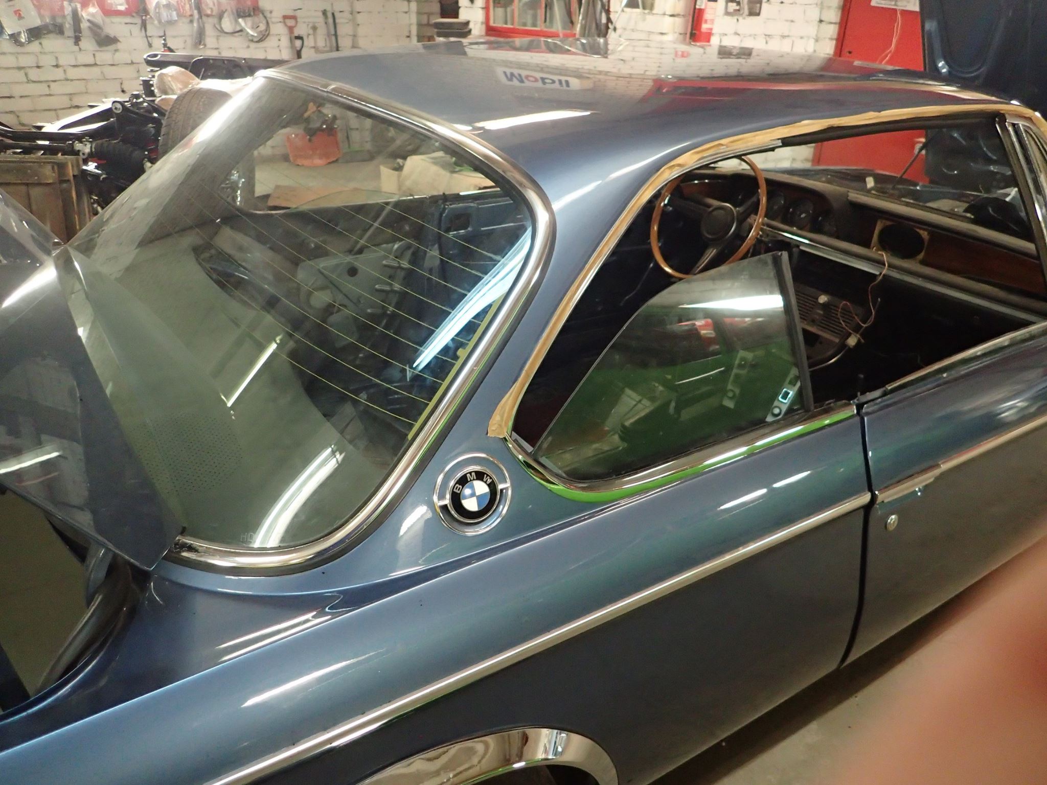

Some new pictures from my restoration project
johanaxelson
651
147
Swedish, working in Panama

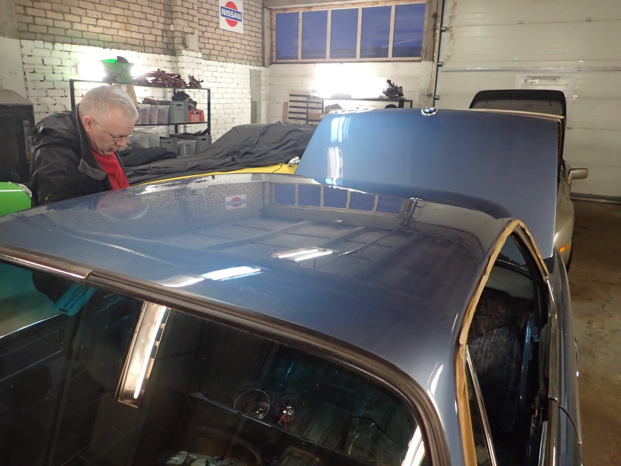

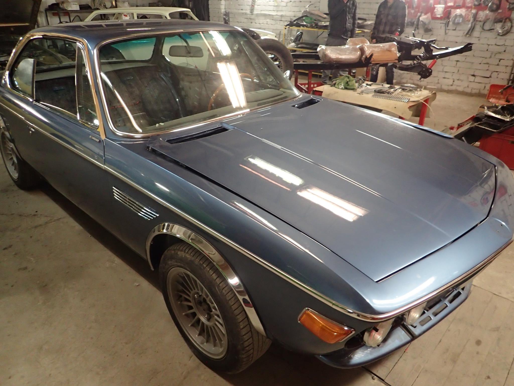

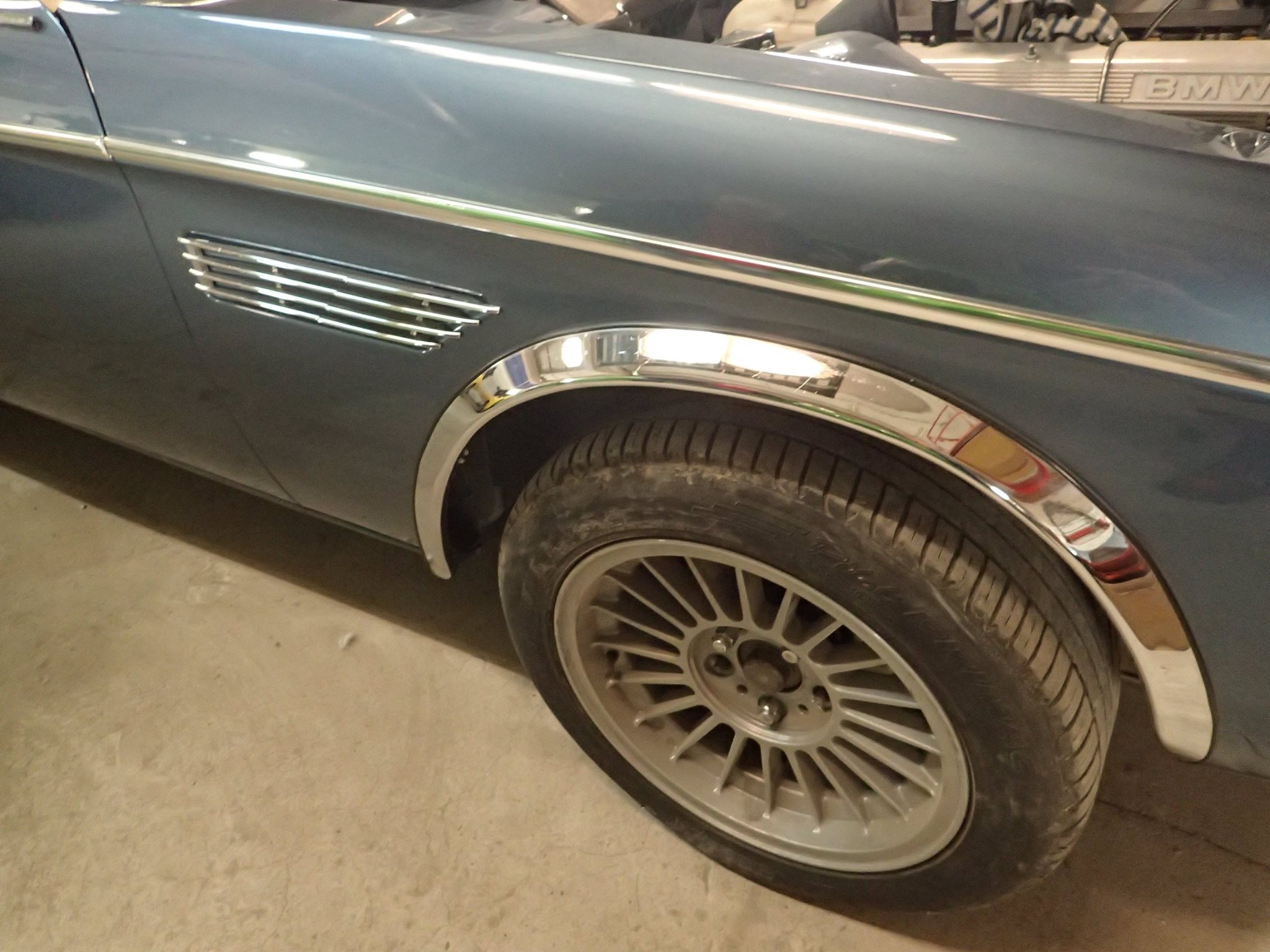

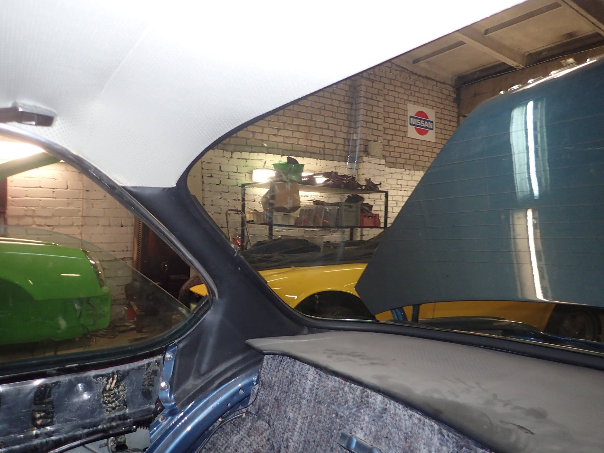

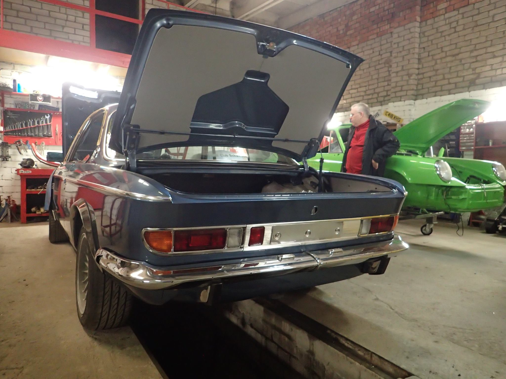

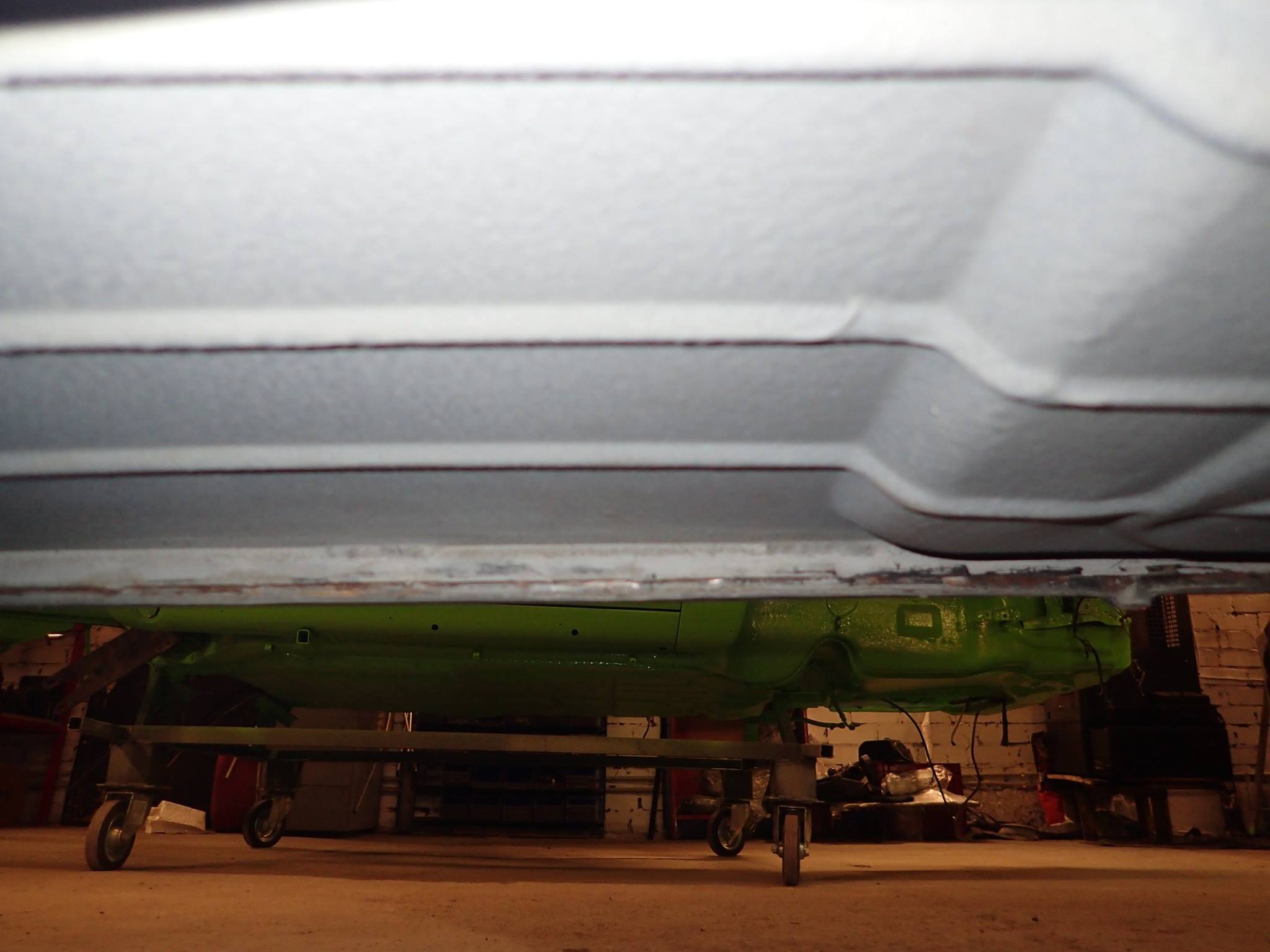

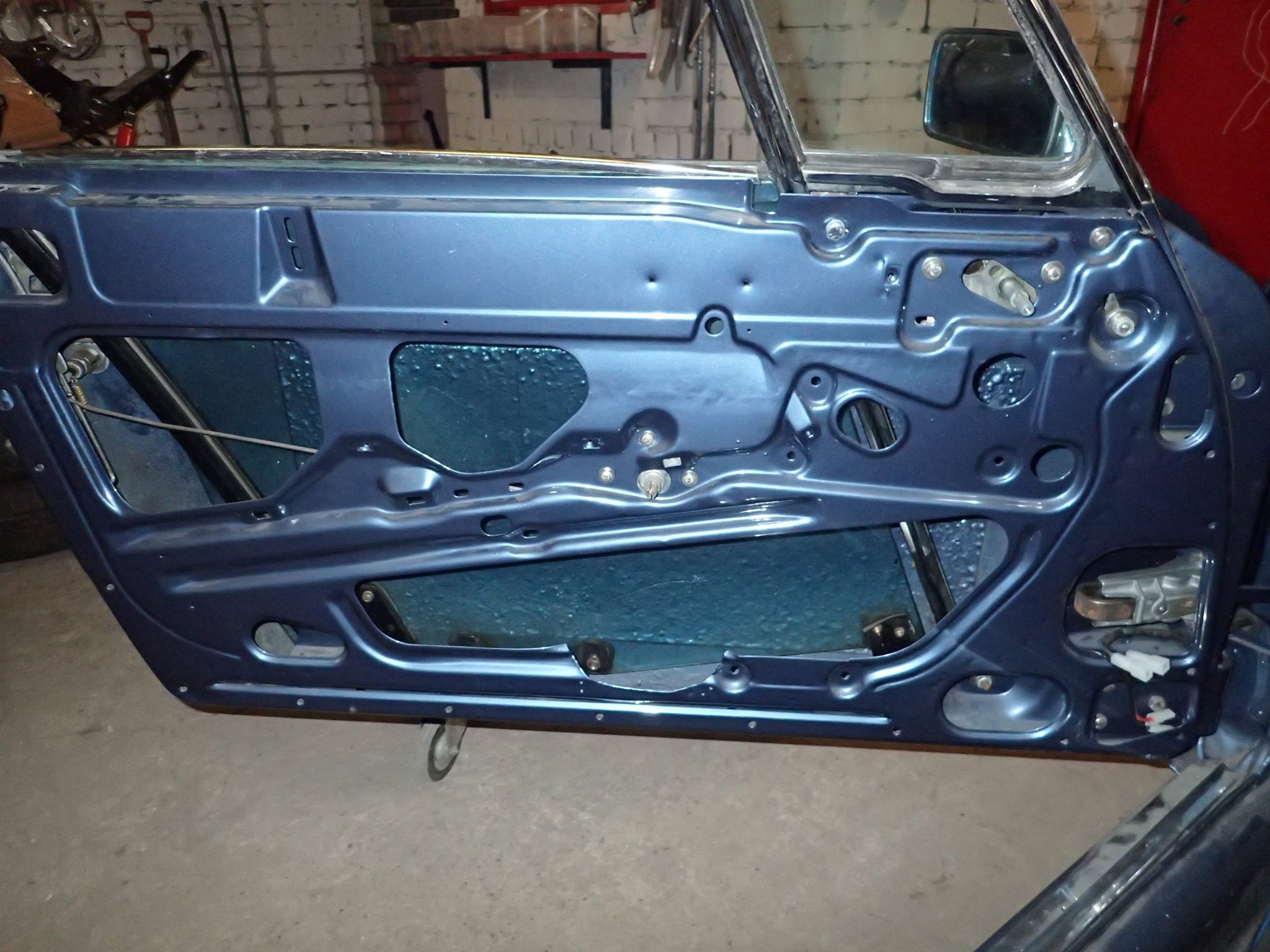

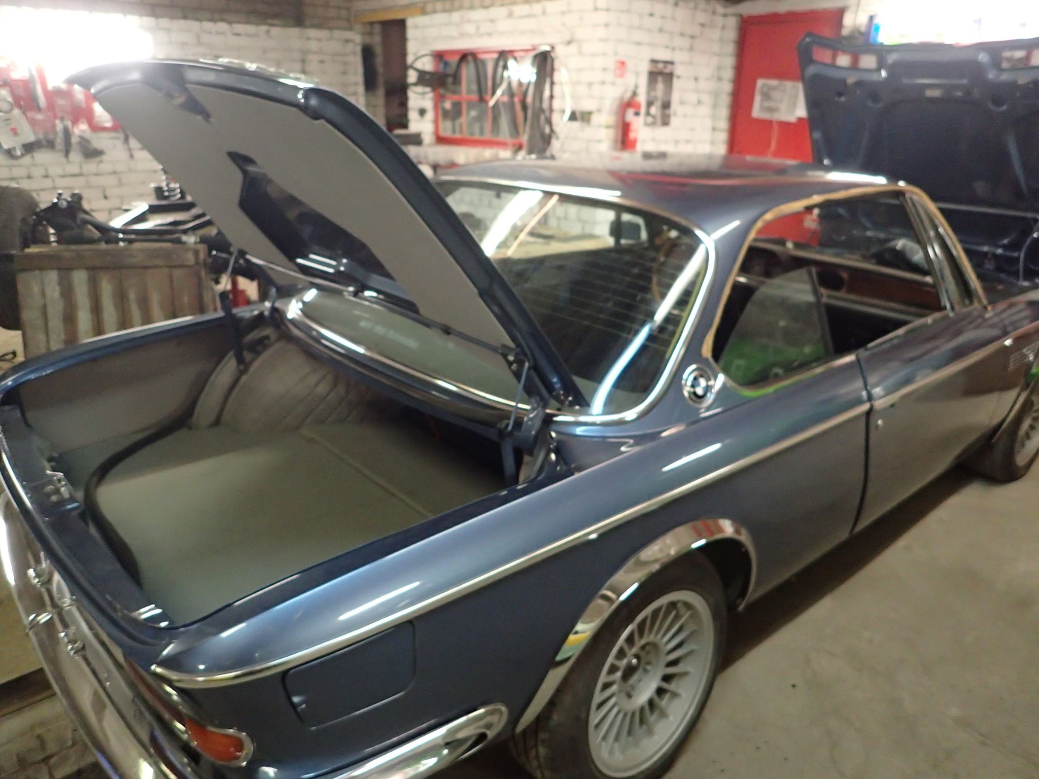

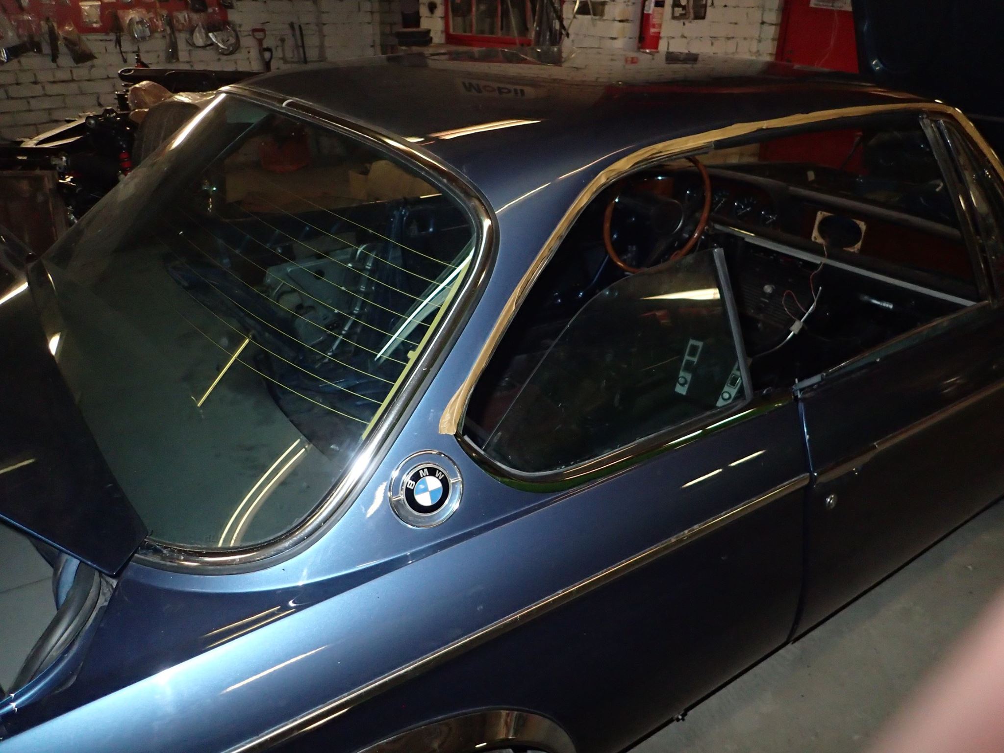

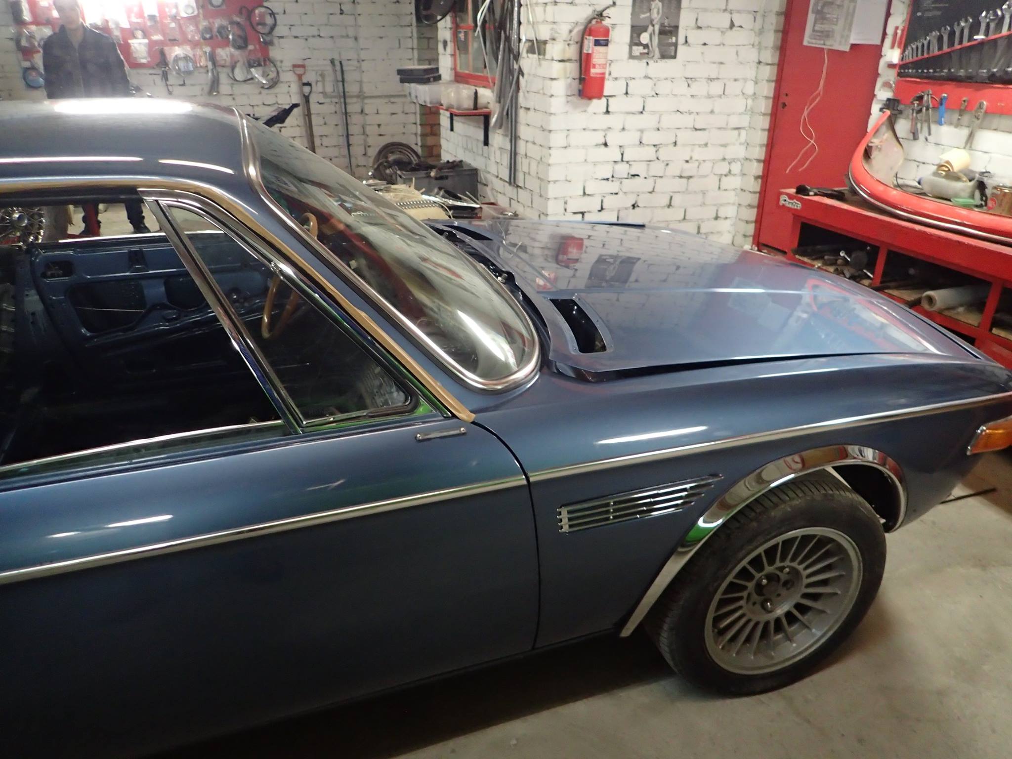

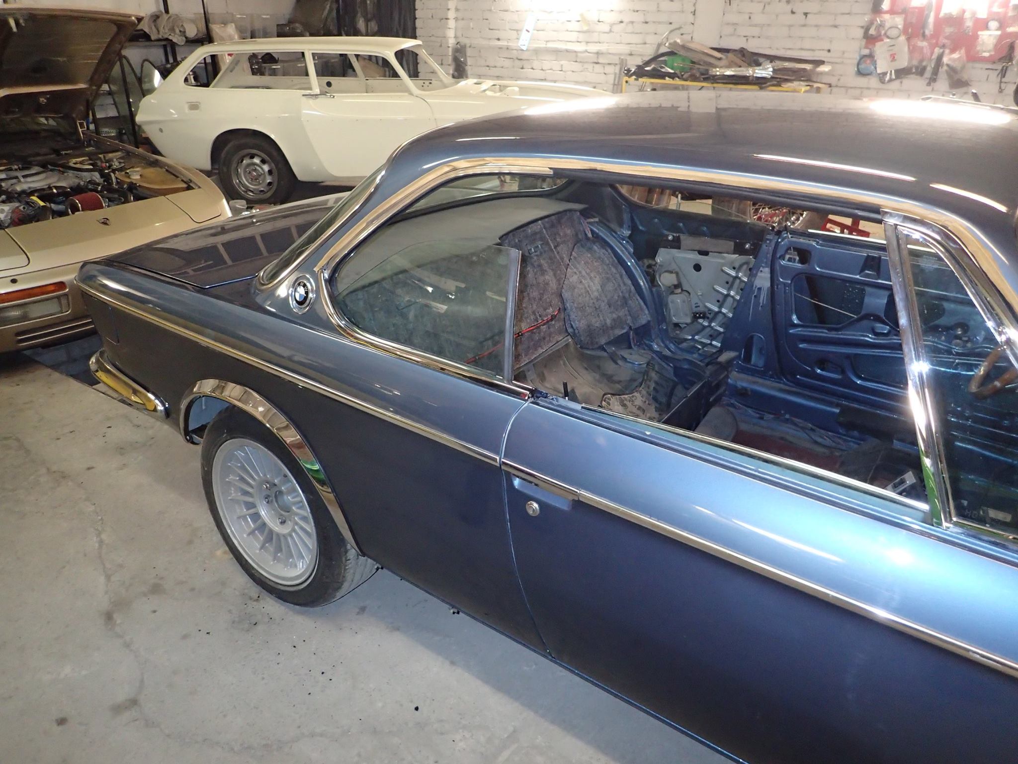

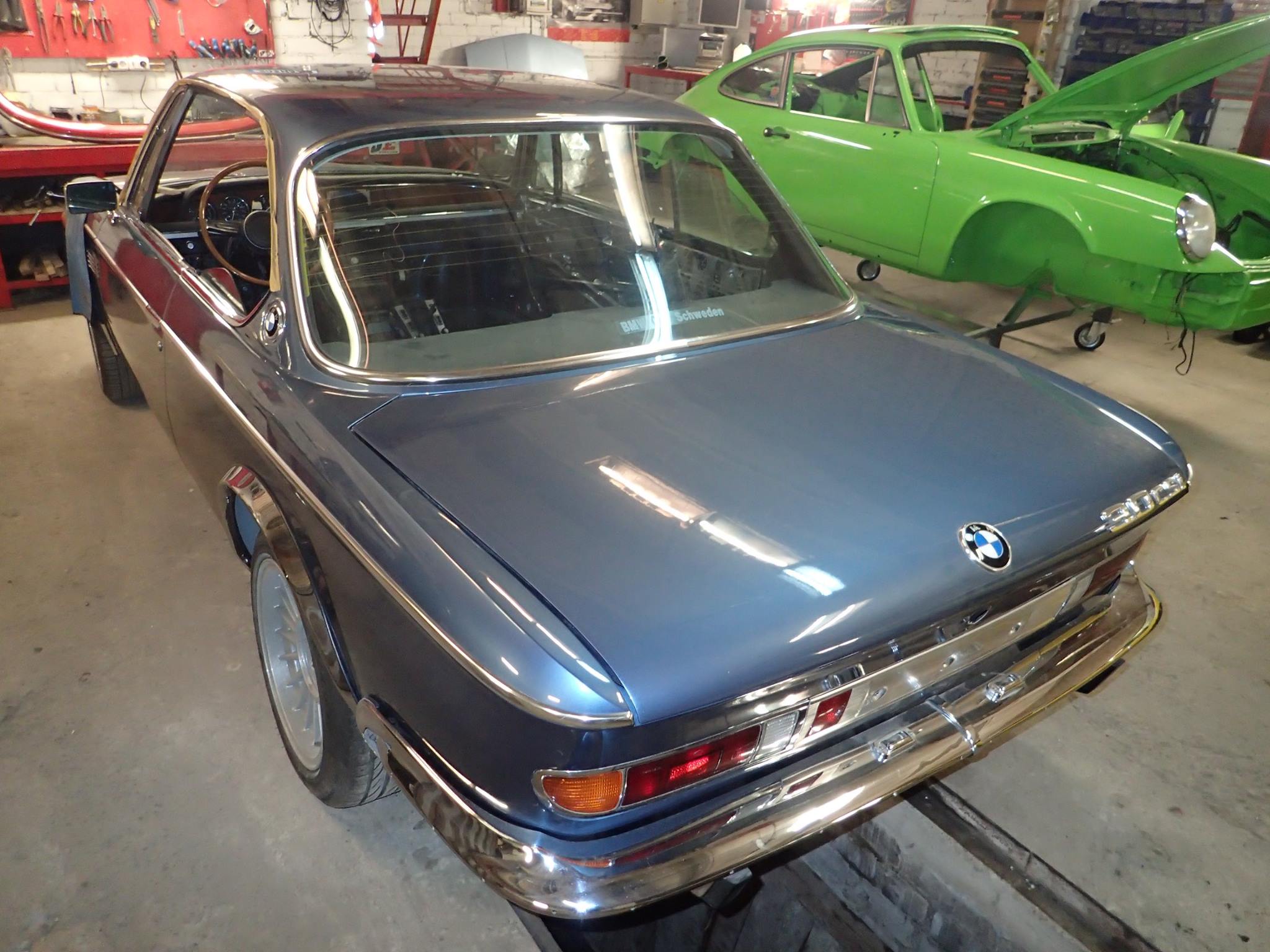

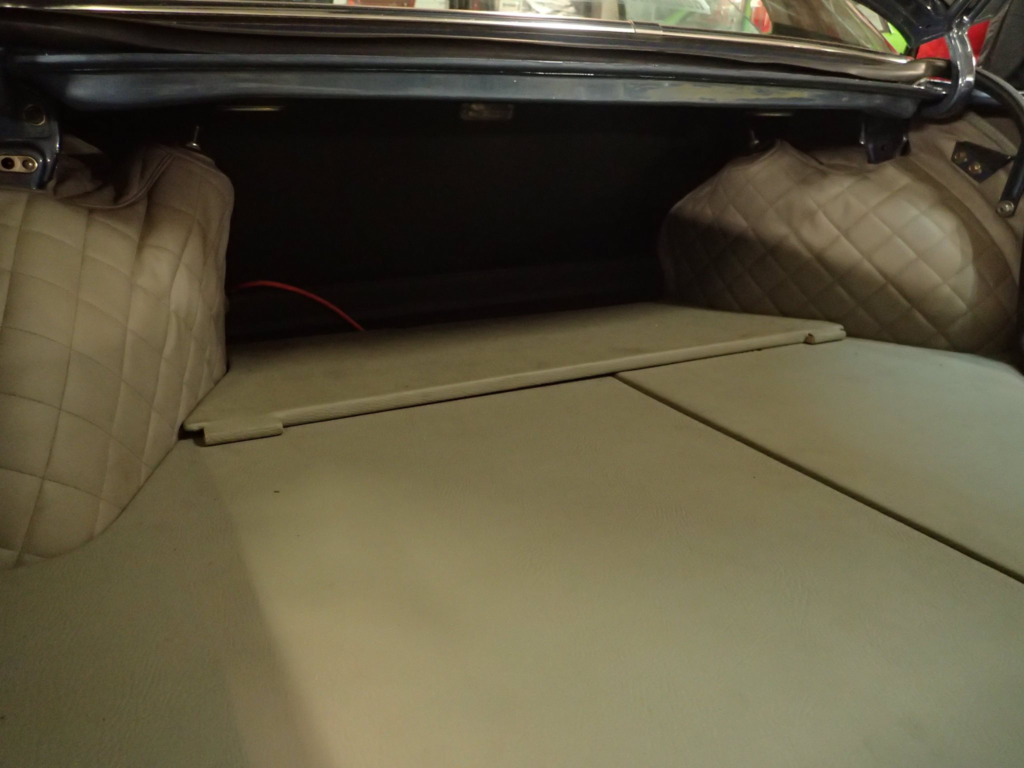

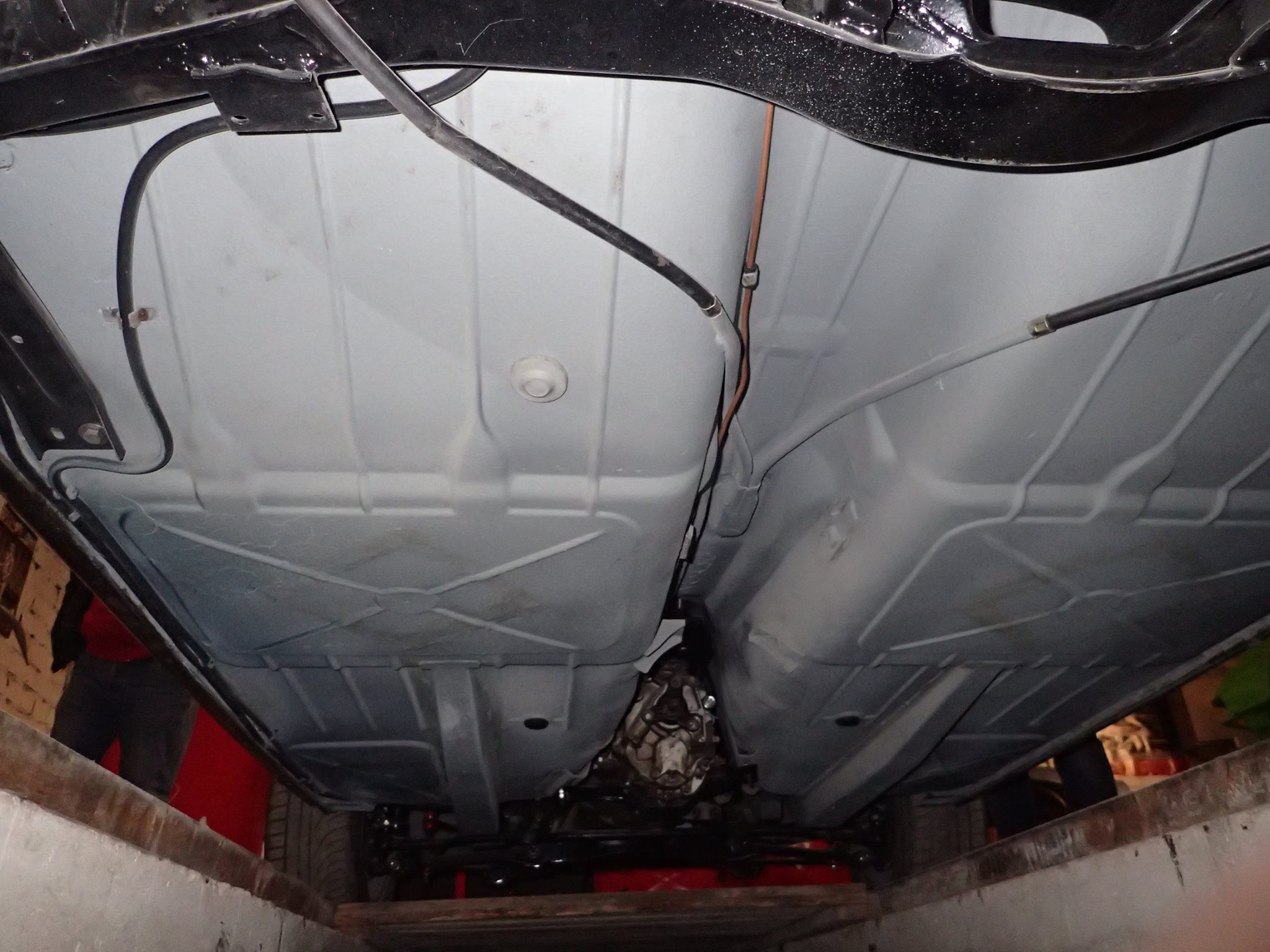

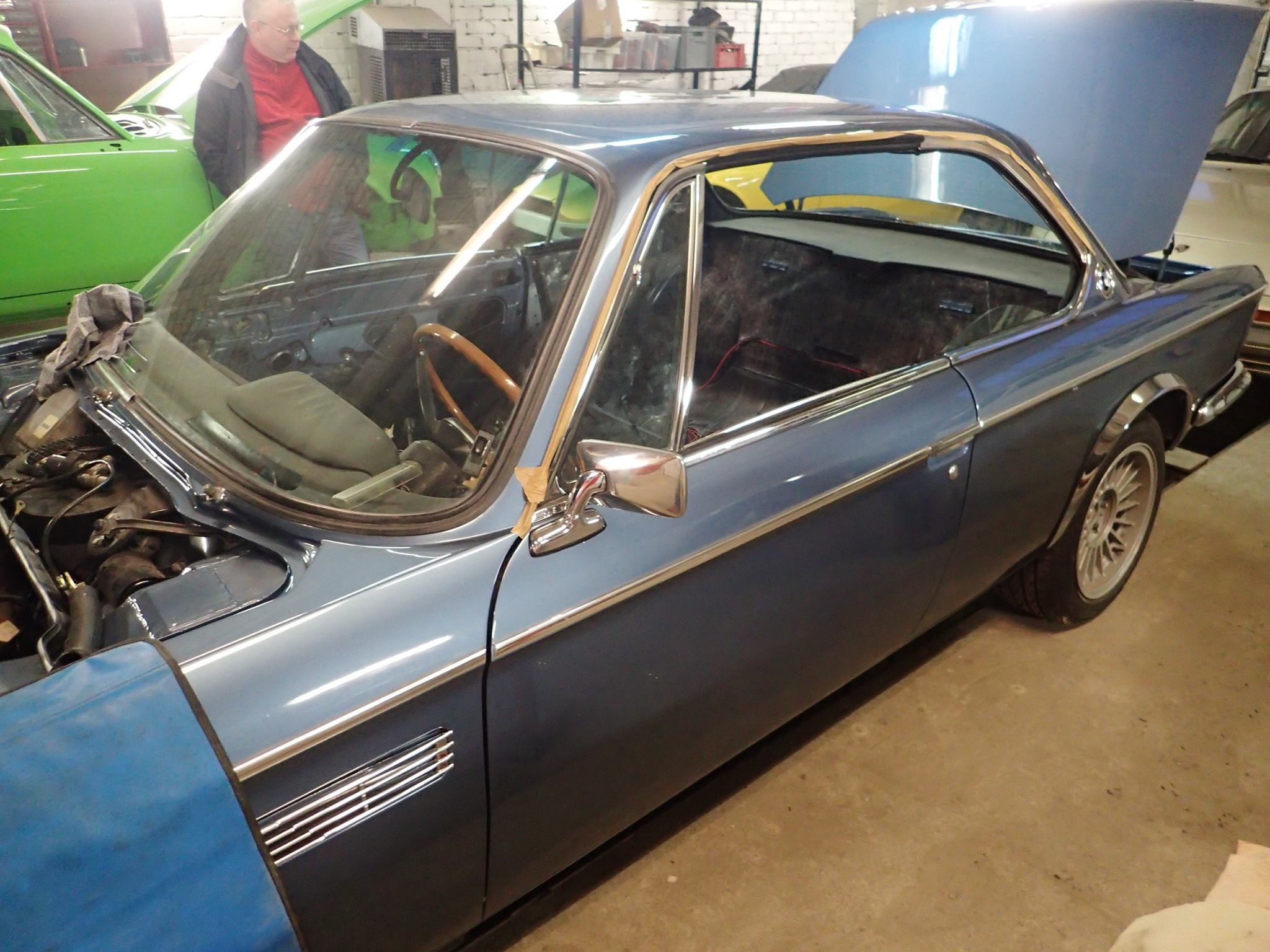

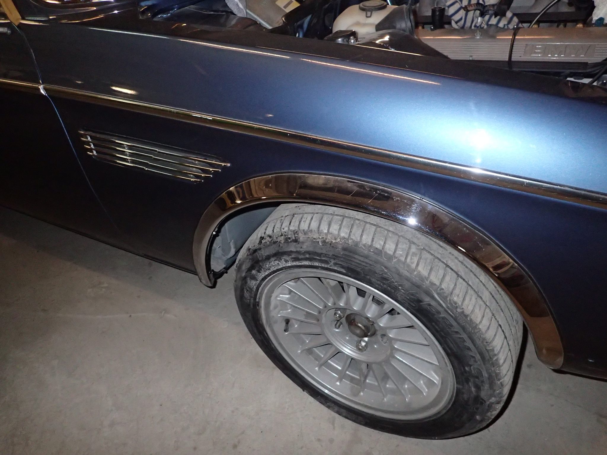

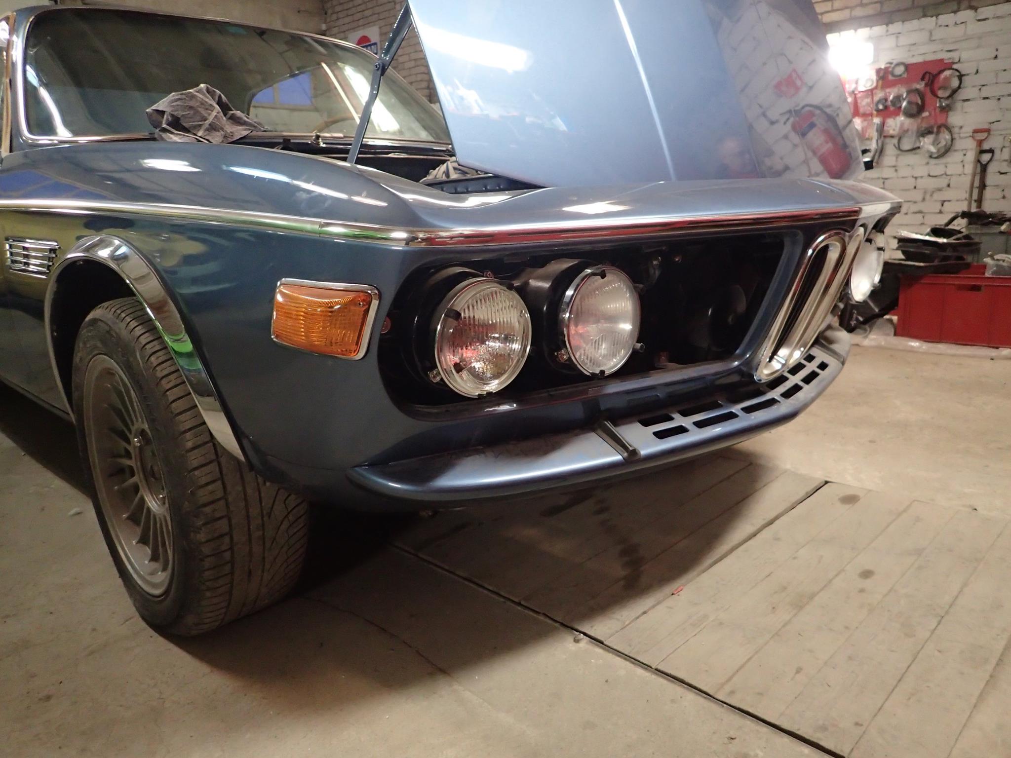

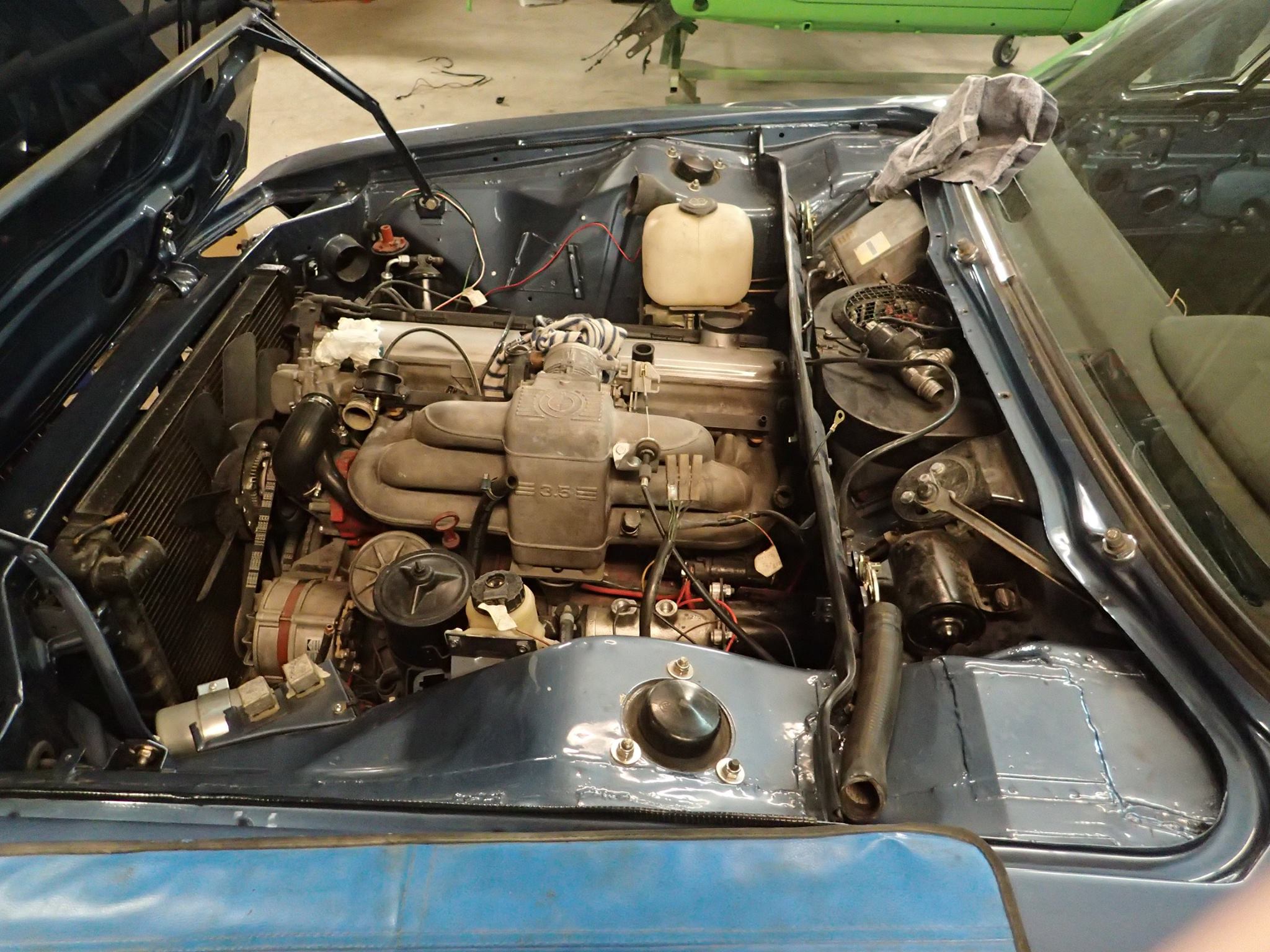

It's been a while and I have been off working abroad and the garage busy so work has been slow but now it is starting again and I paid the car a quick visit.
It is close to being finished and the last bits just need to be put back together. Electrical system and interior. This will of course take a little time as it is detail work but it will be done by summer.
- it is dirty as work is in progress
- detailing of engine and gearbox will be done last
- proper polish will do done towards the end
- the lighting is florescent indoor lighting, hard to get colors right so there are often a flash and no flash version, flash makes the color look more true. I think the picture in this post is the closest but hard to tell....
-It is Baikal (glasurit)
And sorry, it was a new camera. Still learning it...
Please, any comments are appreciated. Not only positive ones, I want to know what to improve.

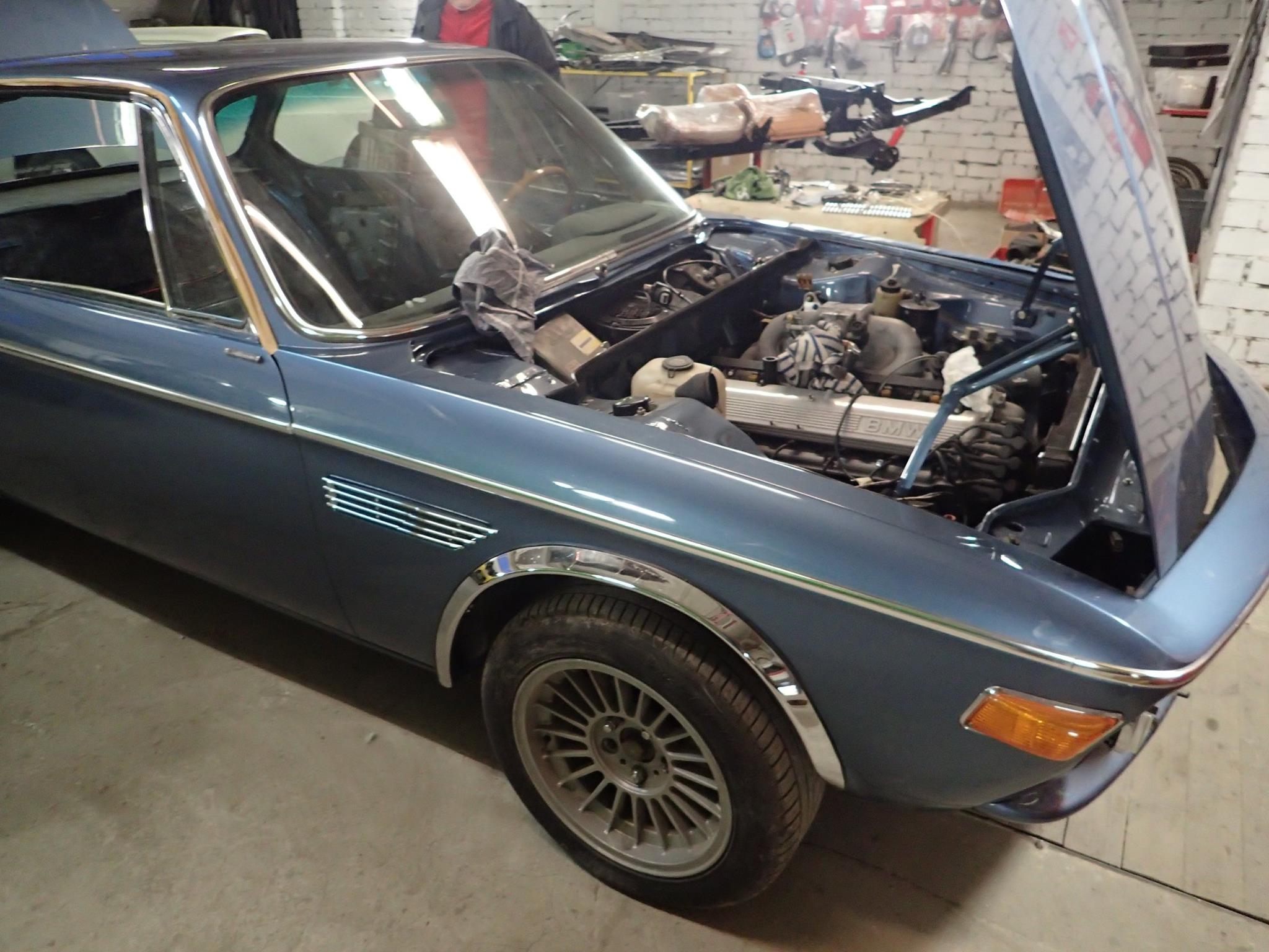

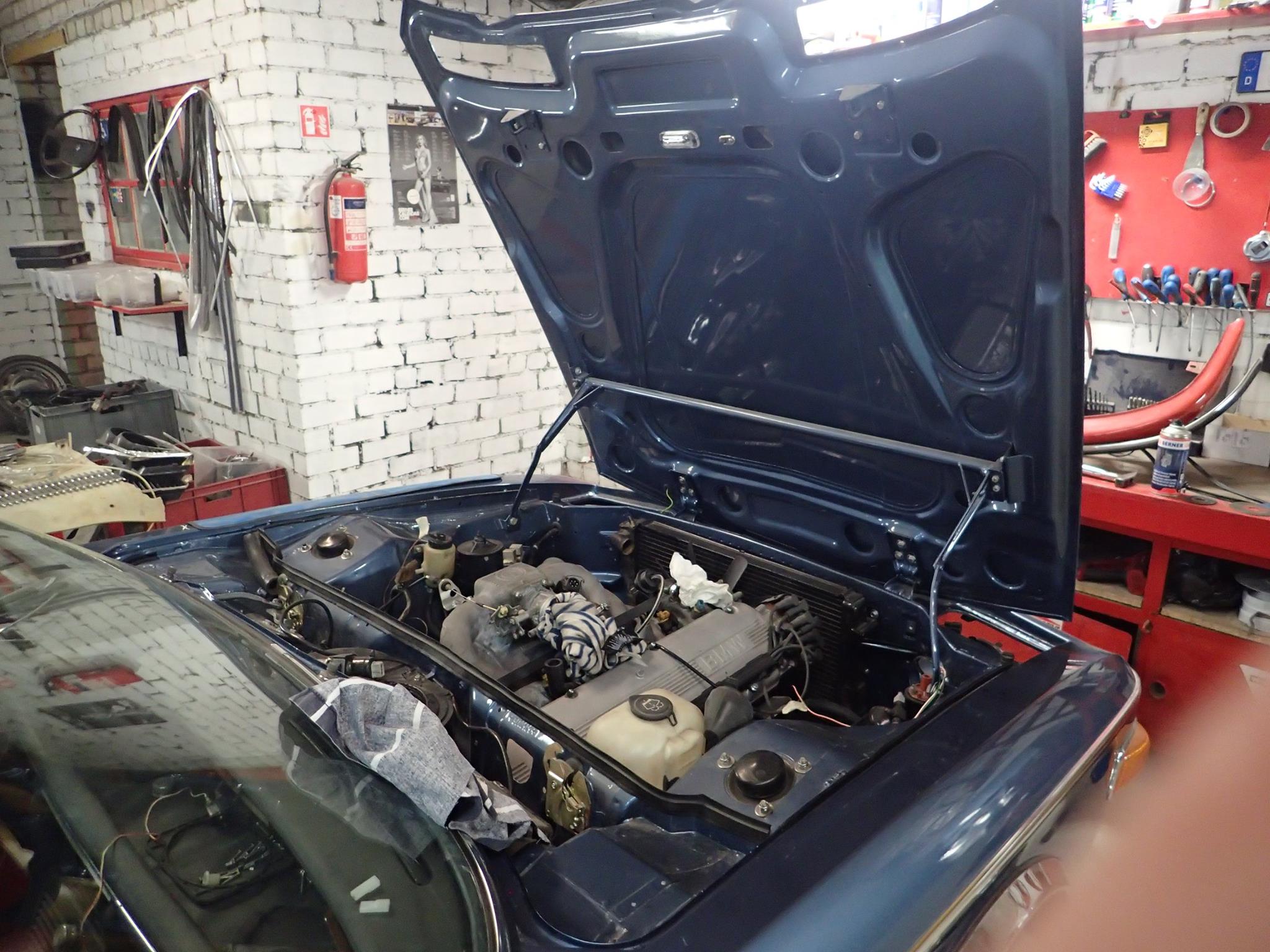

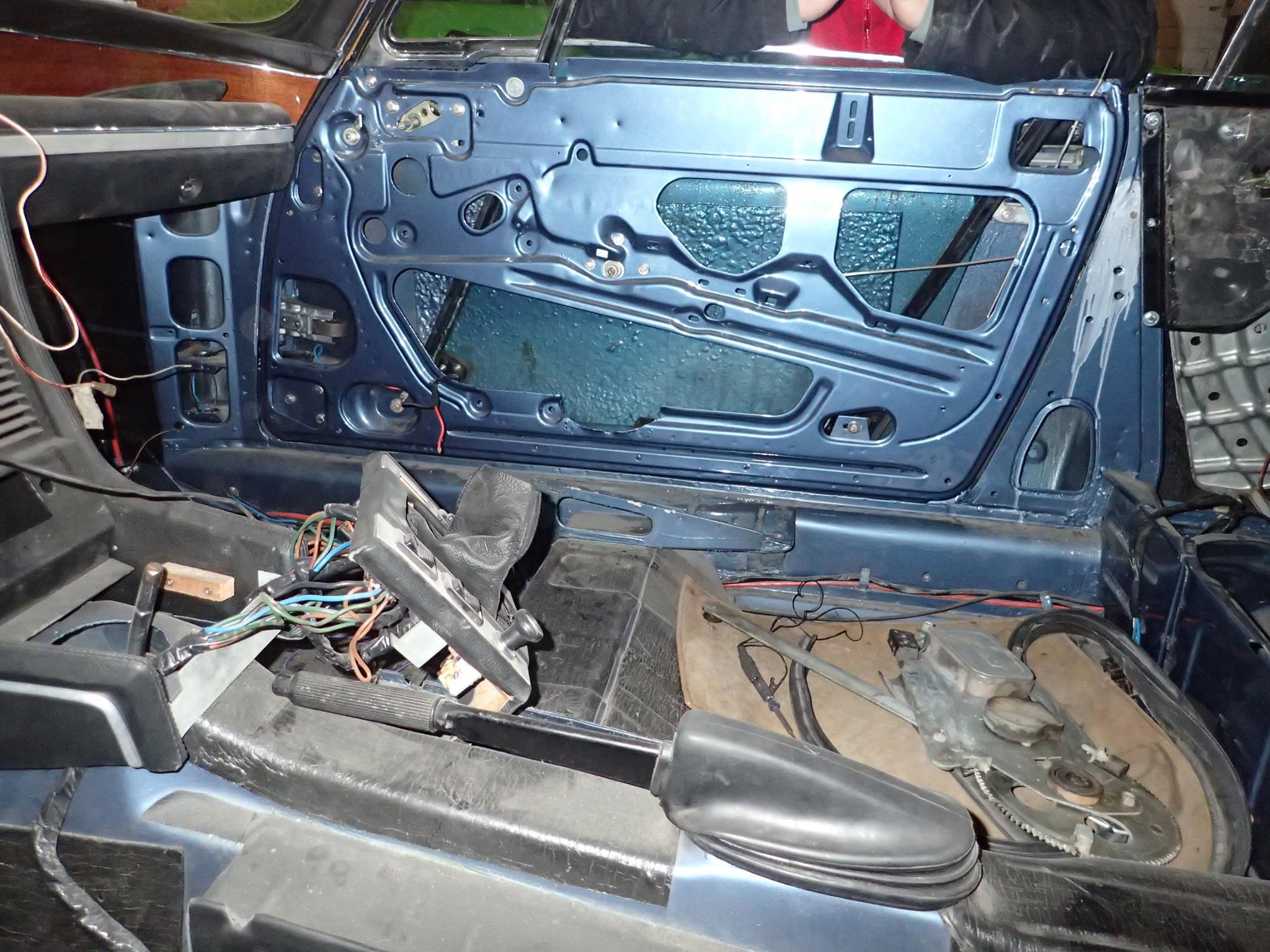

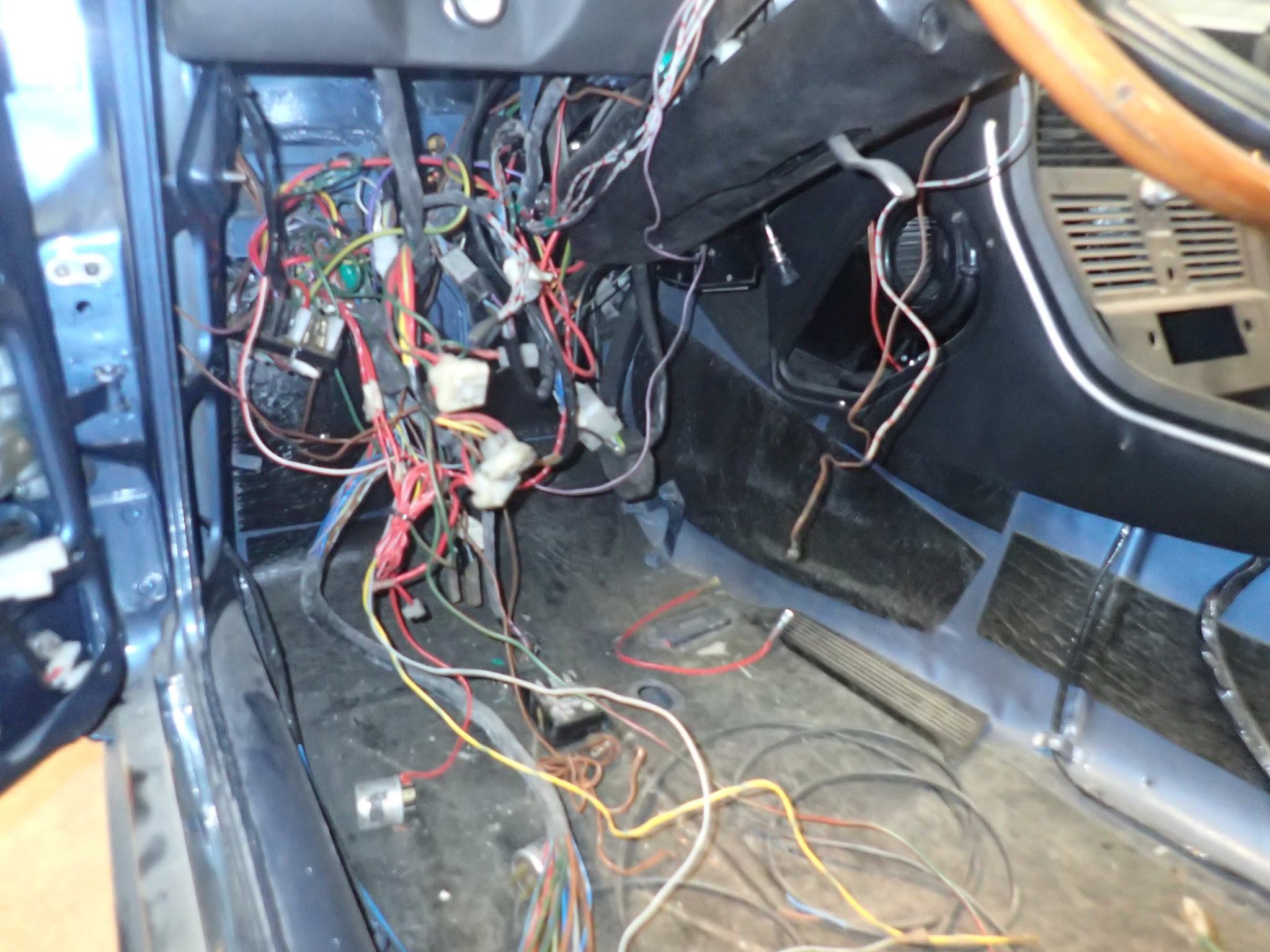

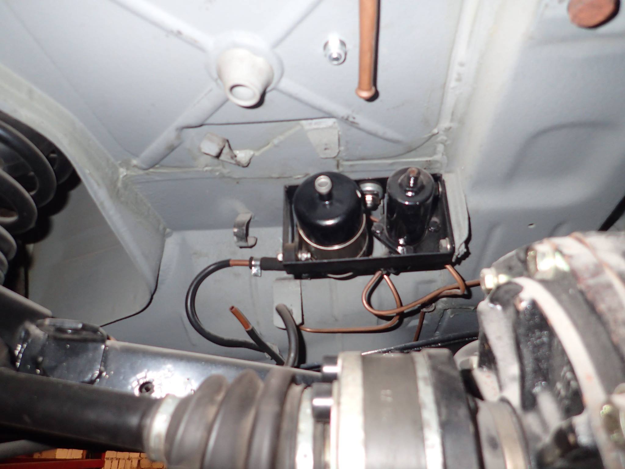

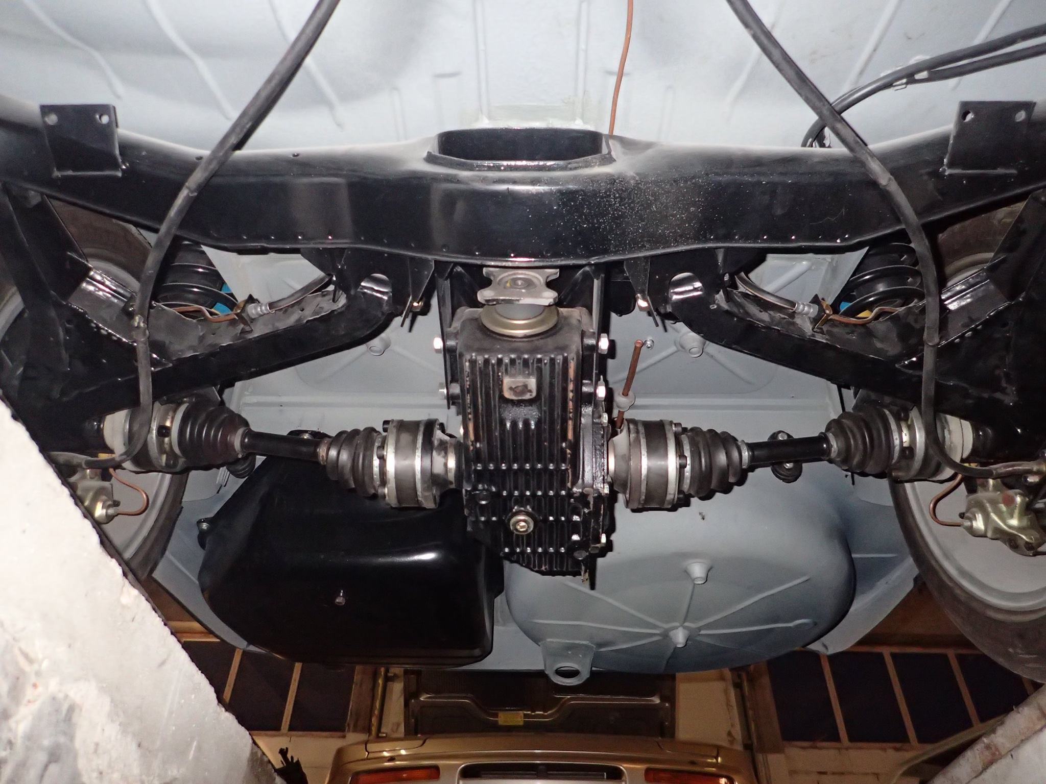

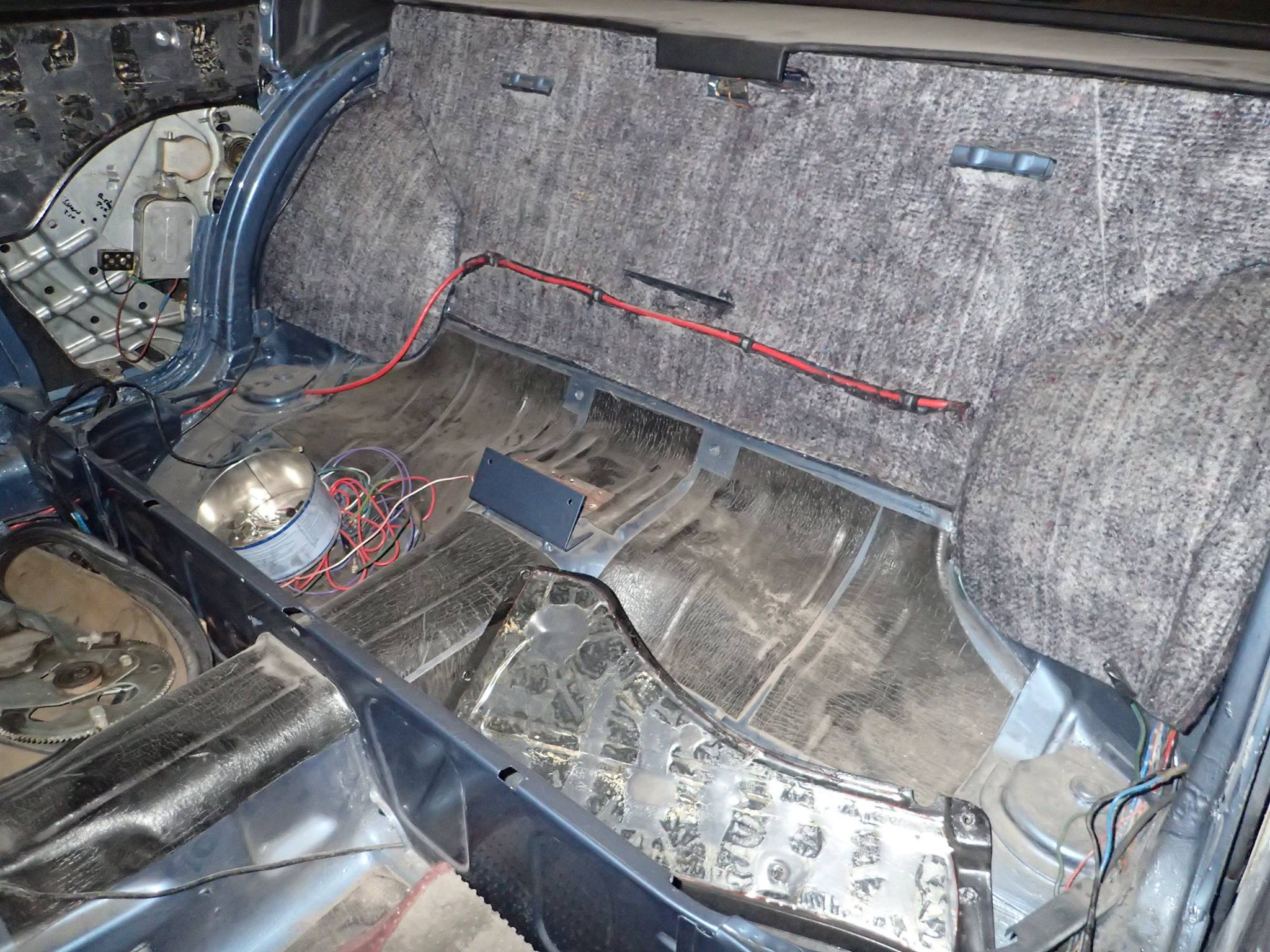

Since the engine is a 3.5L transplant I will use a MegaSquirt the engine wiring will be done from scratch. No point in using old loom, much cleaner and safer with a new one. So much of the old cabling is not needed.

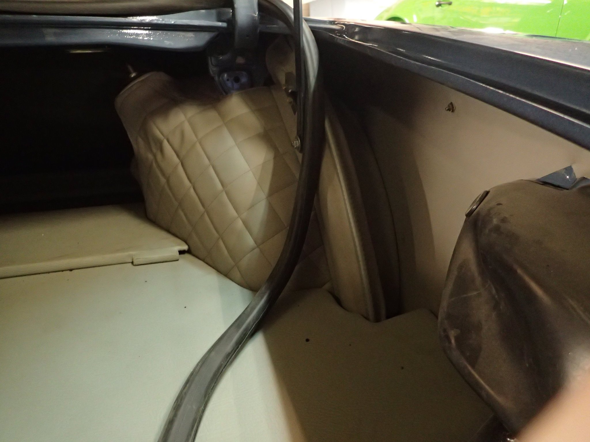

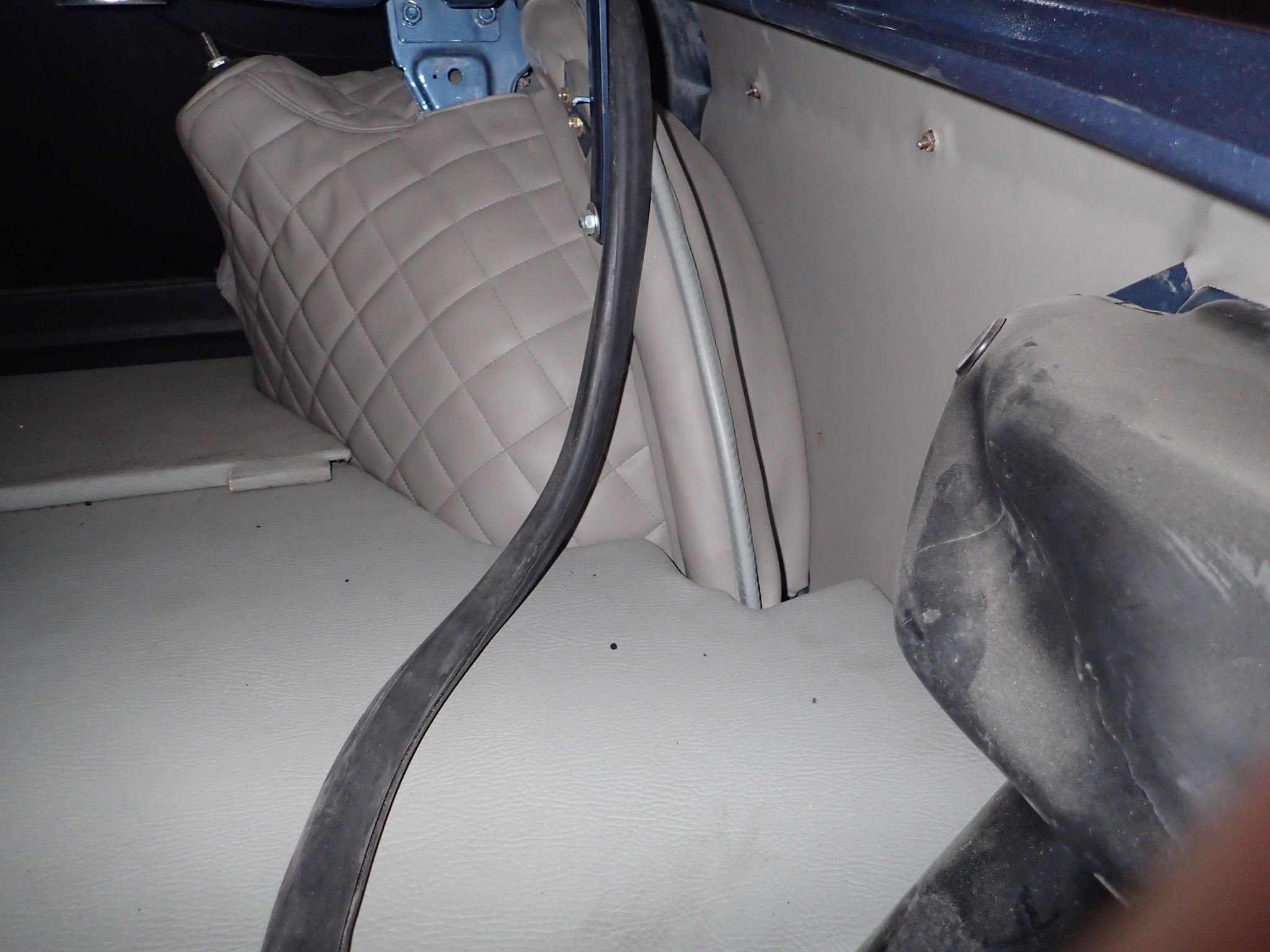

Wheel house covers are somewhat temporary until I find nice original ones

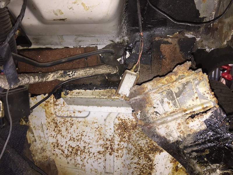

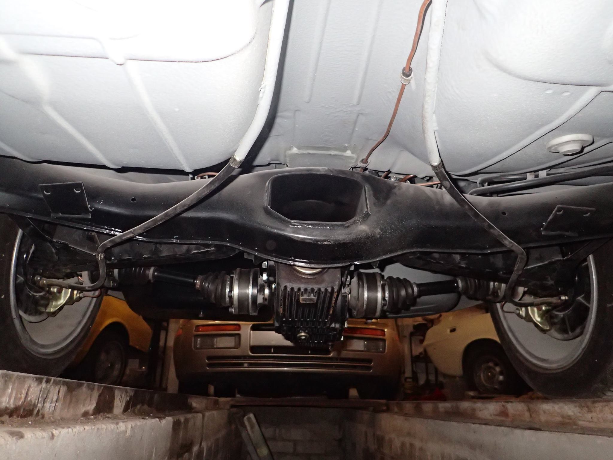

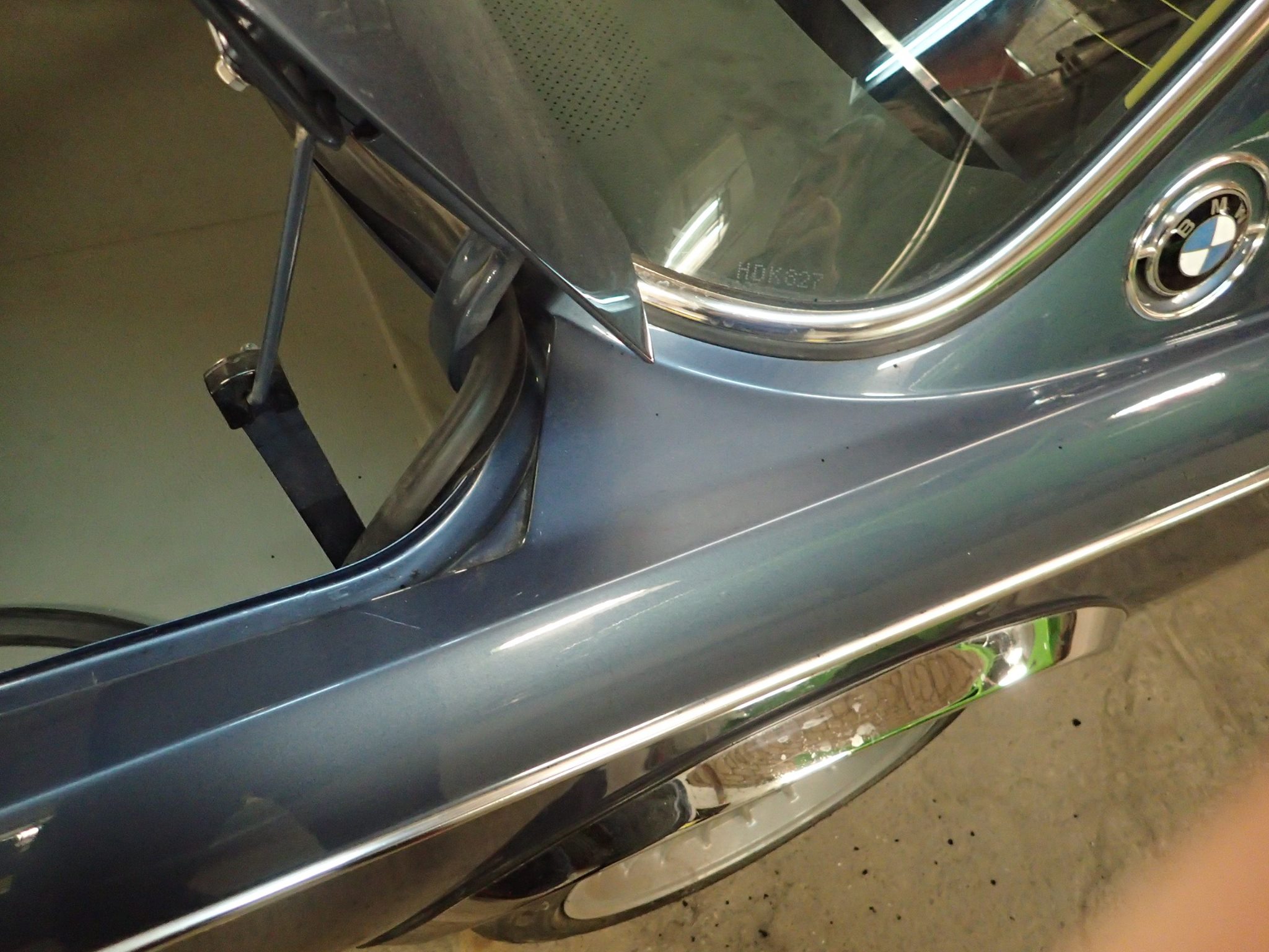

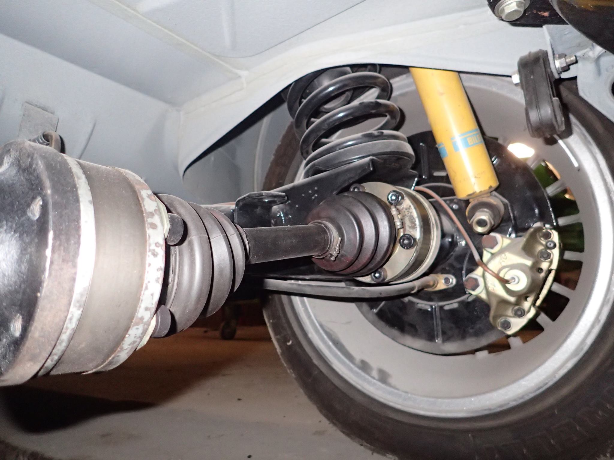

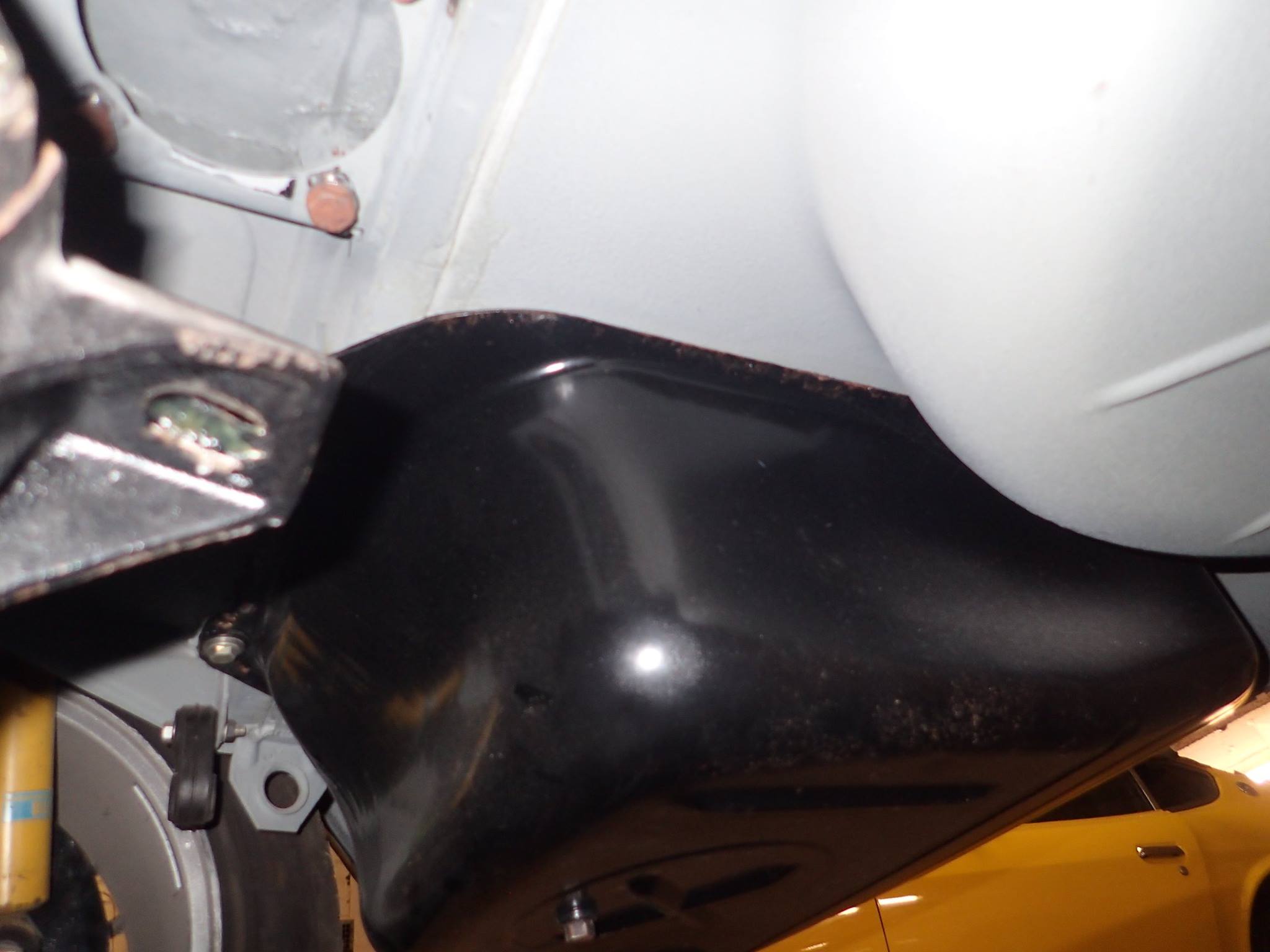

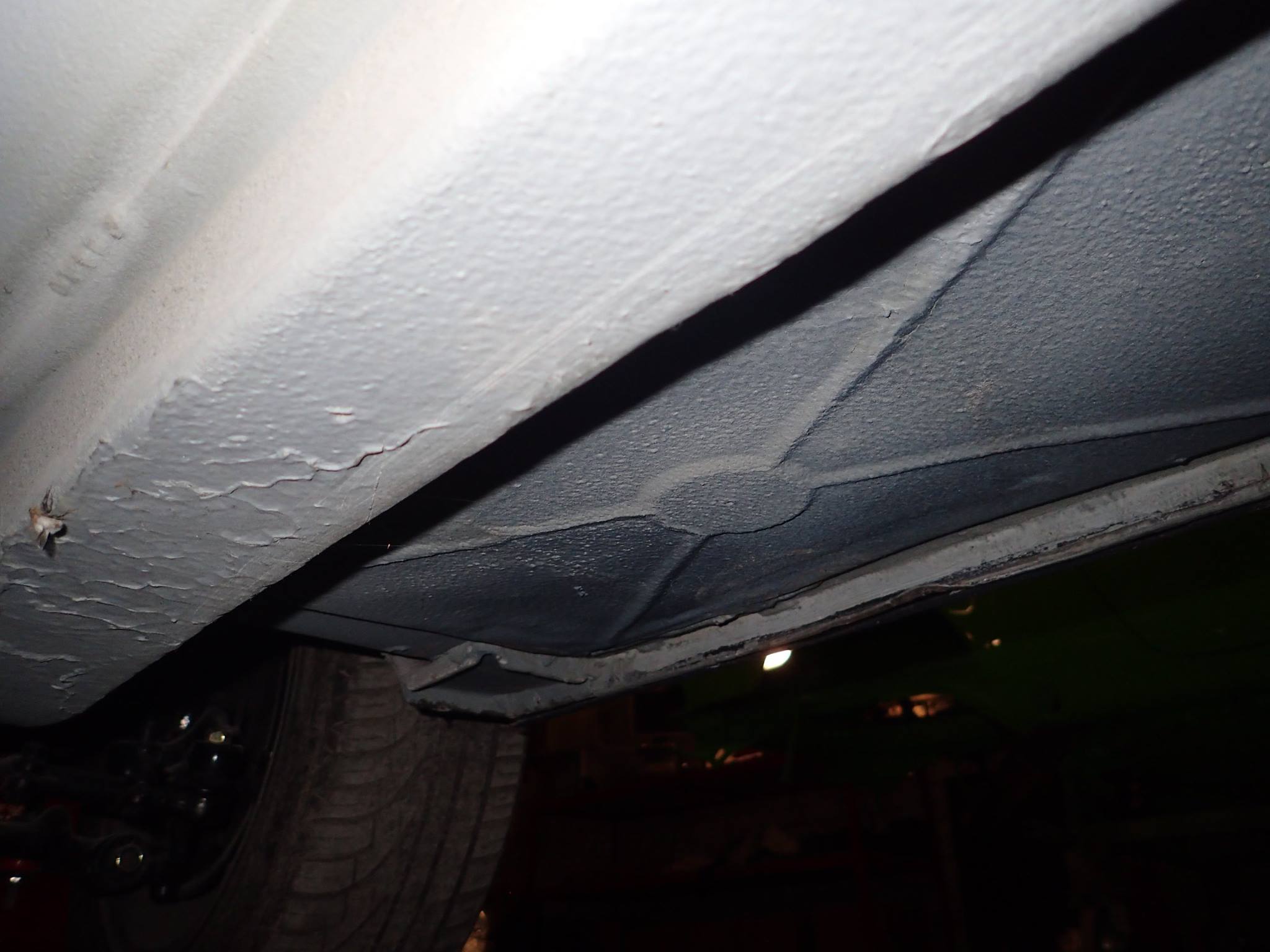

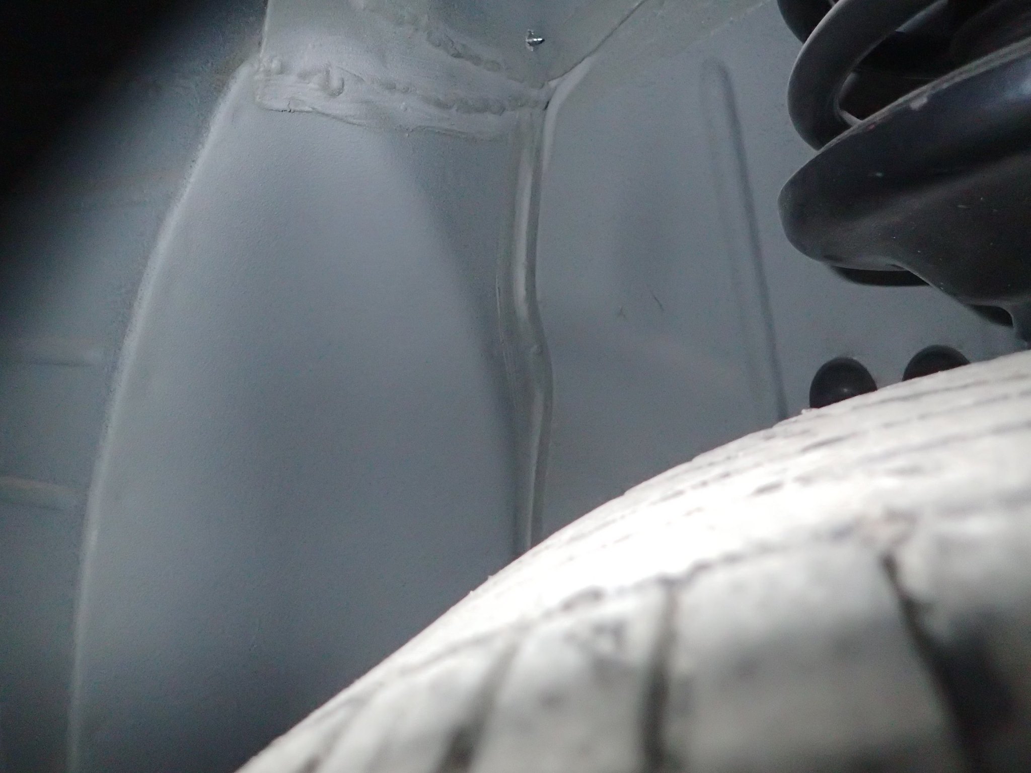

Not sure I like the paint on the wheel well

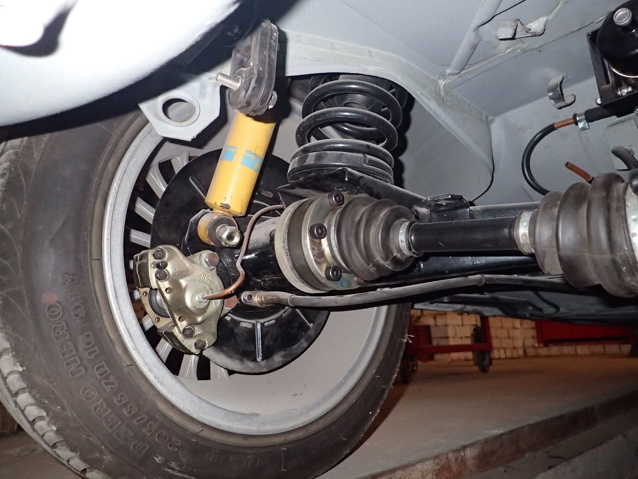

Old shocks were OK so I might keep them

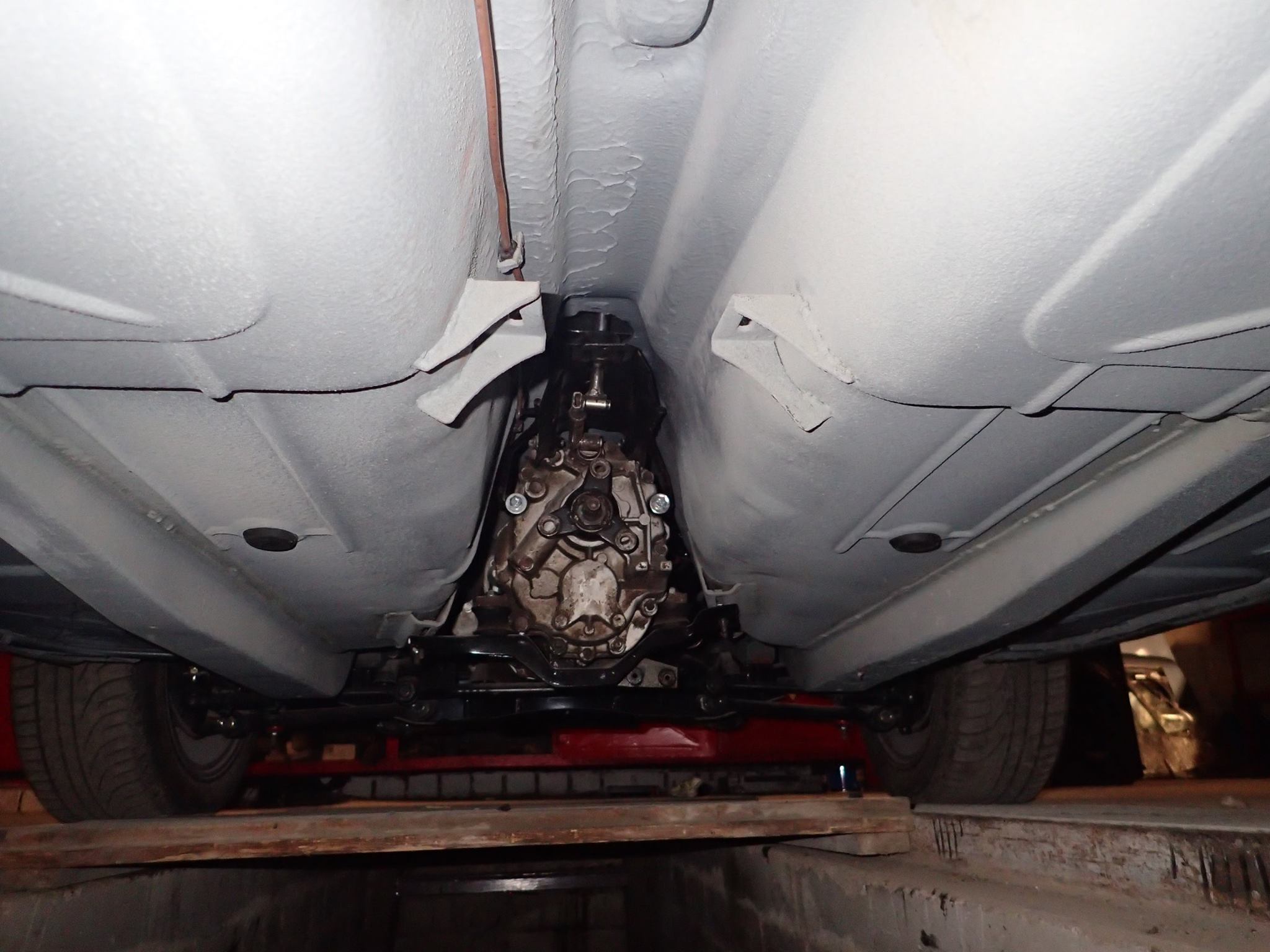

Pic 38, not too happy with the undercoat not being smooth

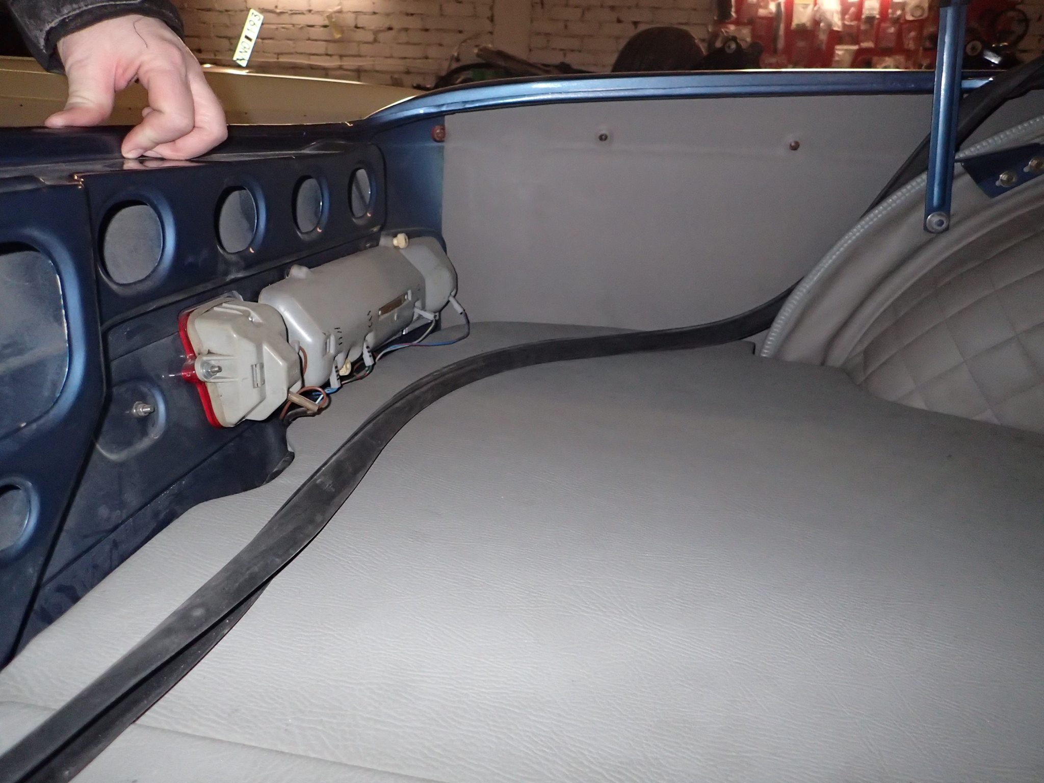

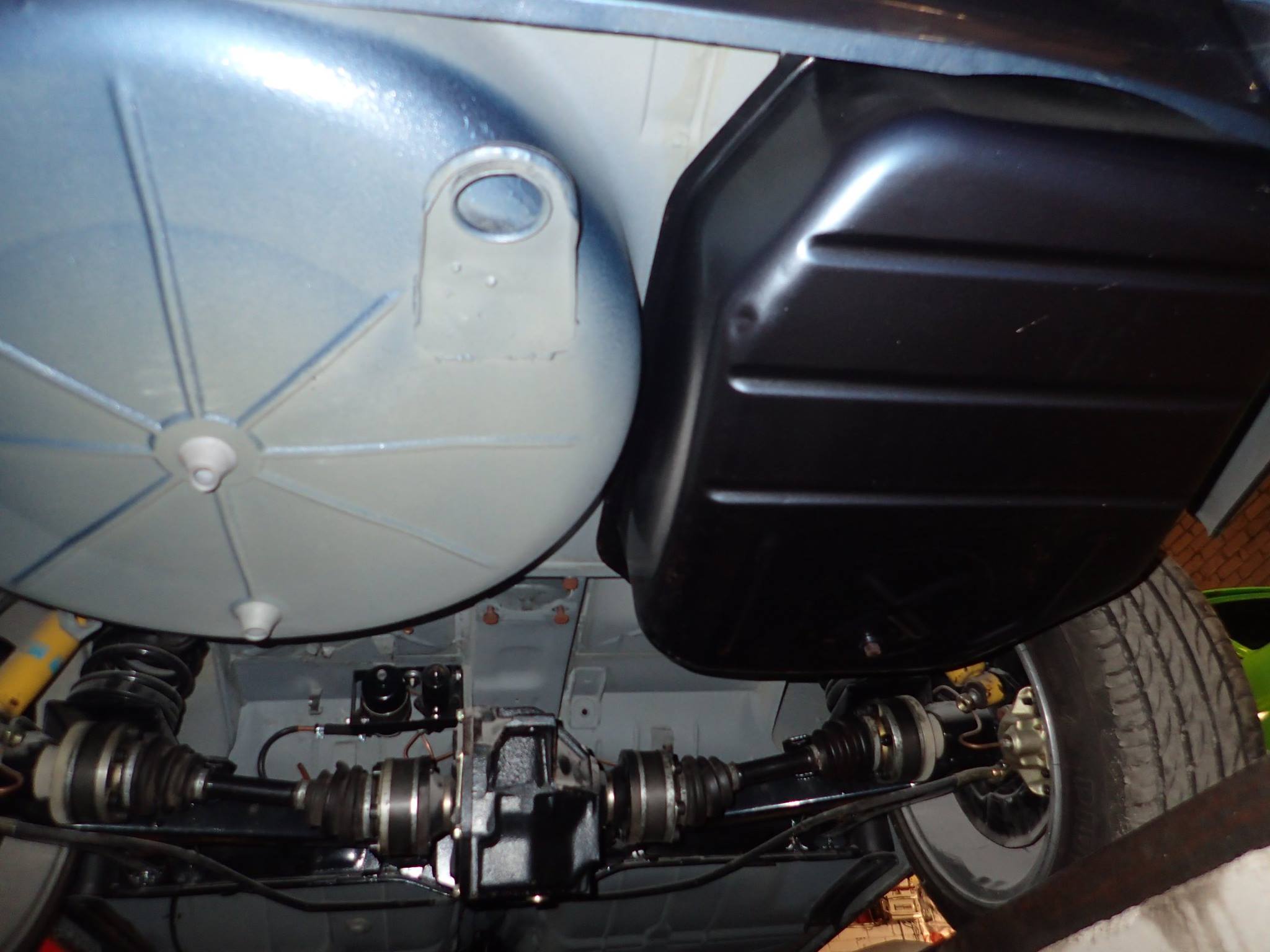

44- the lip needs looking at
46 - paint on the tank seems to not cover properly?

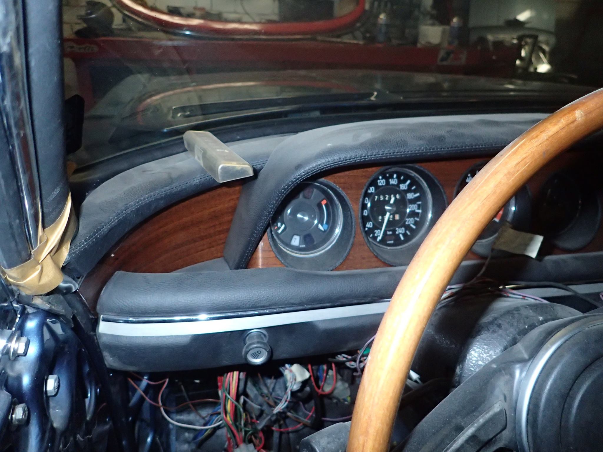

53 - old weld, not too pretty

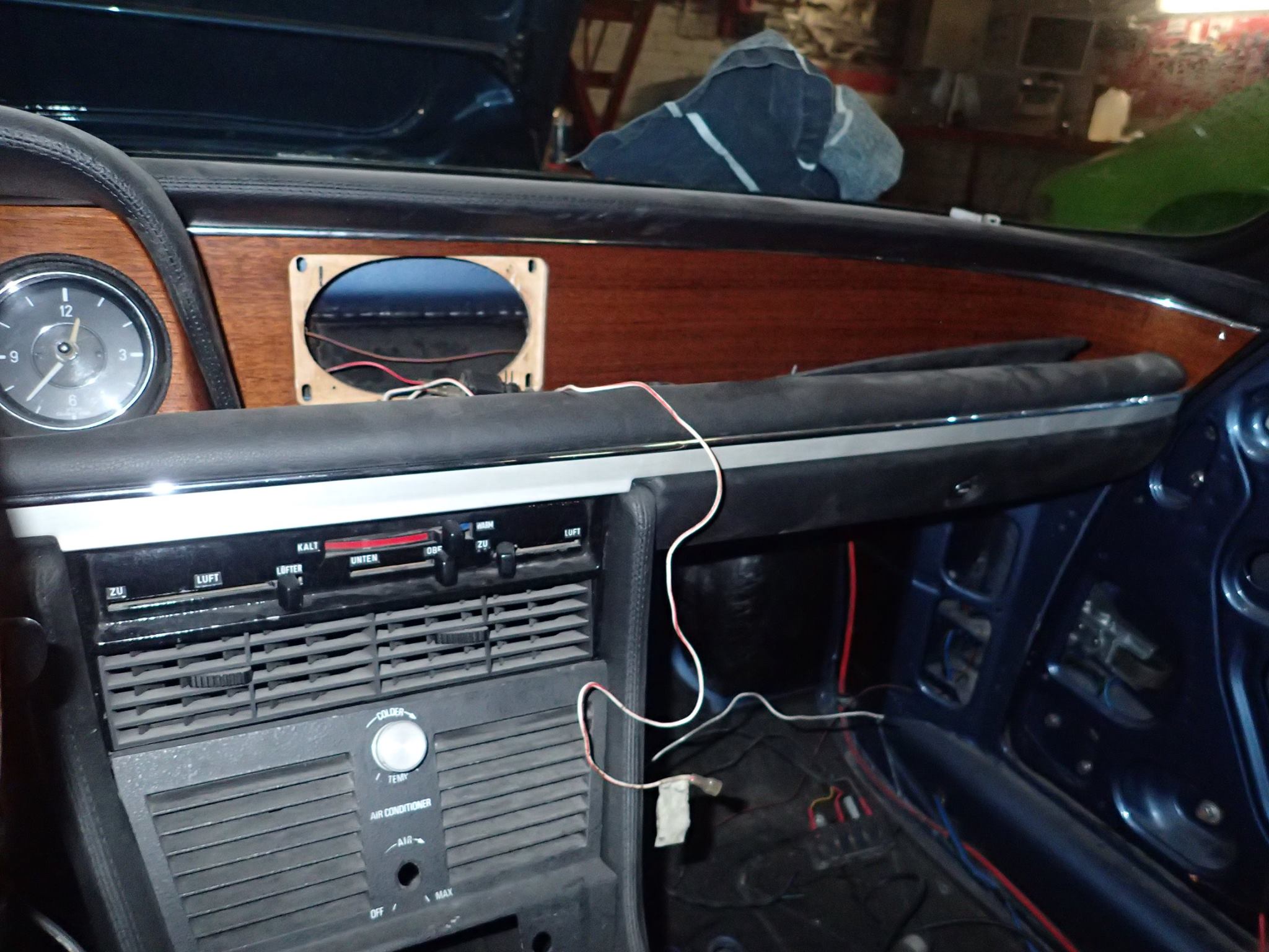

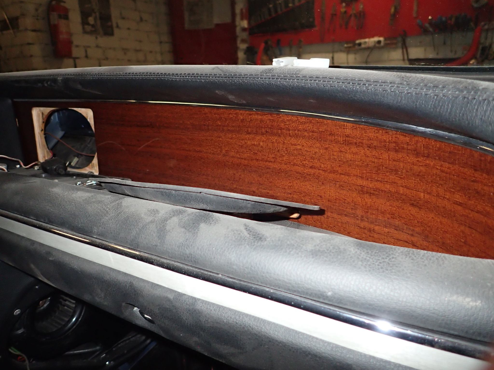

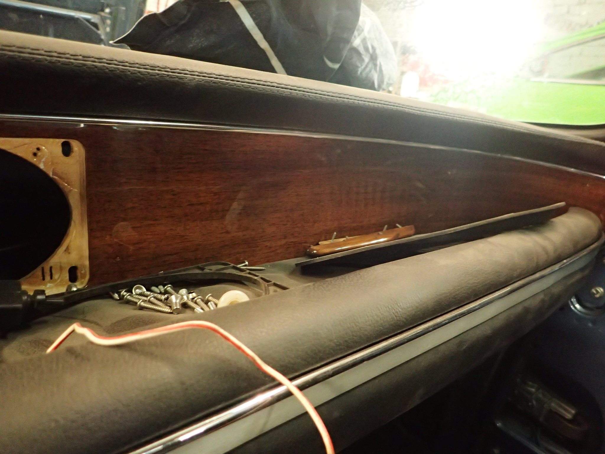

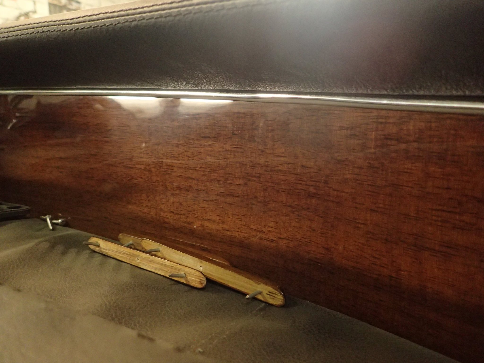

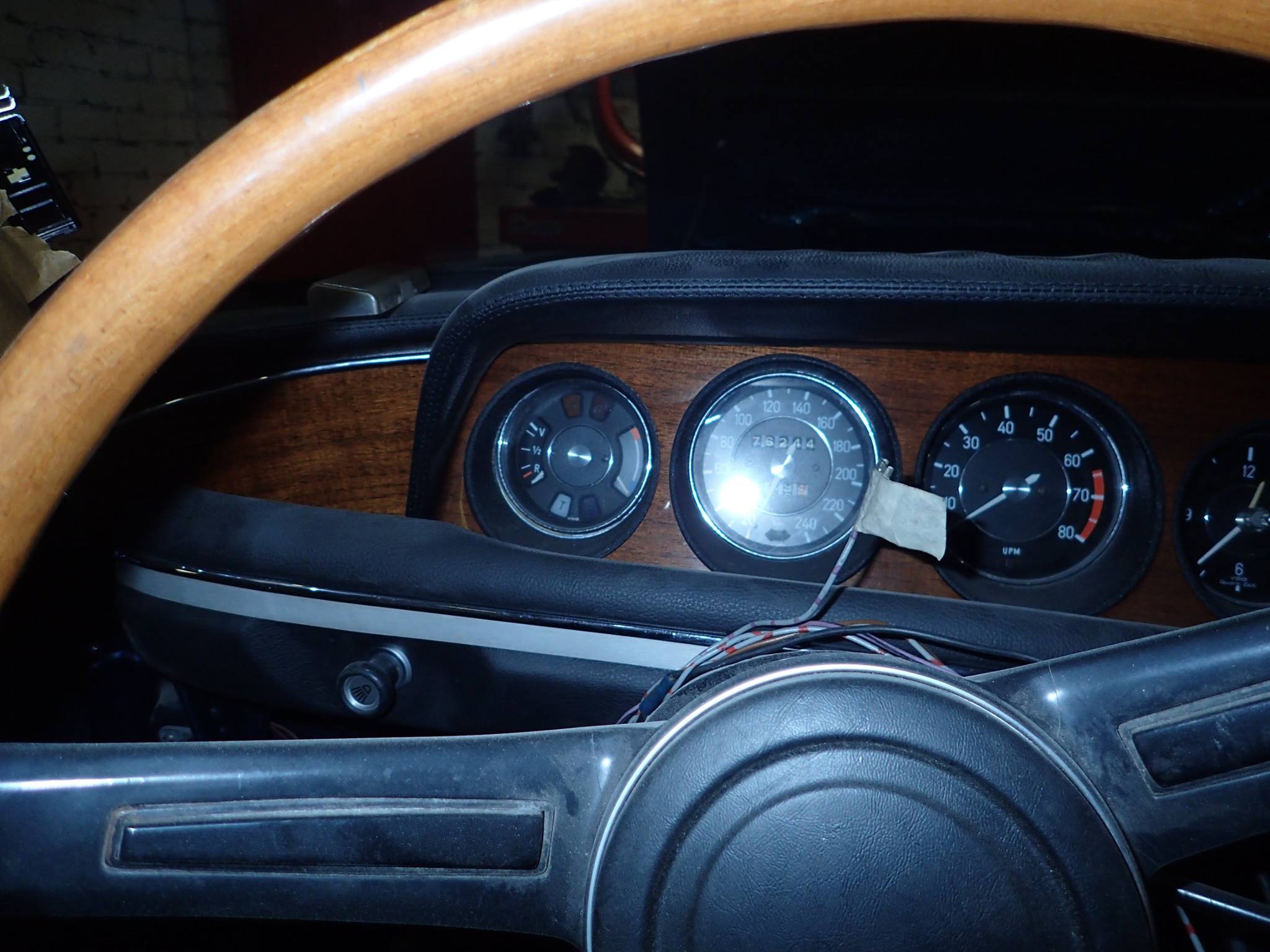

54 - old dash was cracked so we covered it in leather
Am happy with the wood

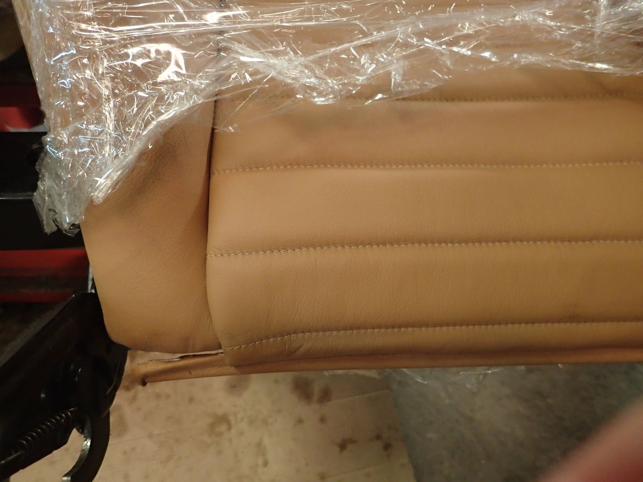

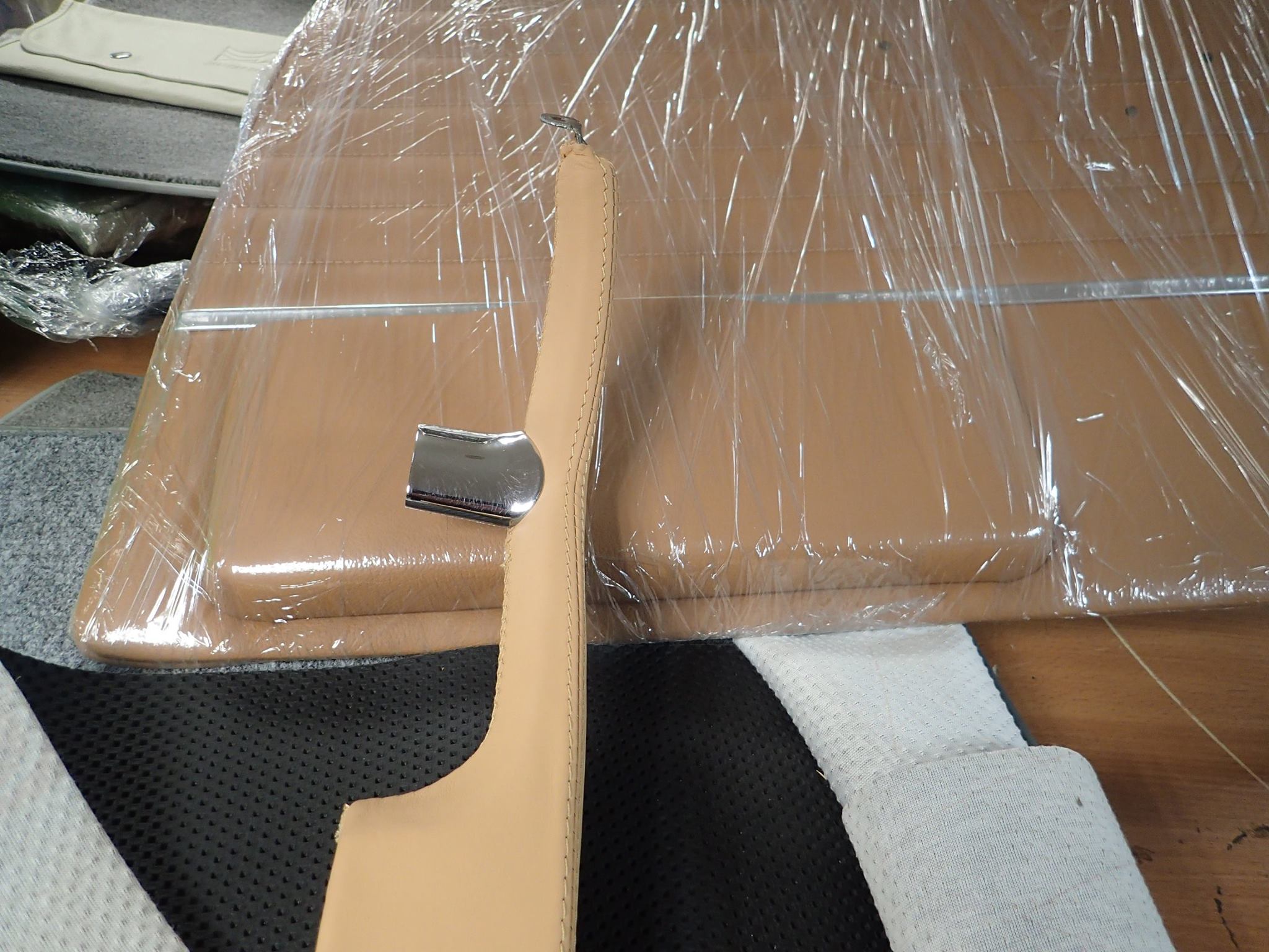

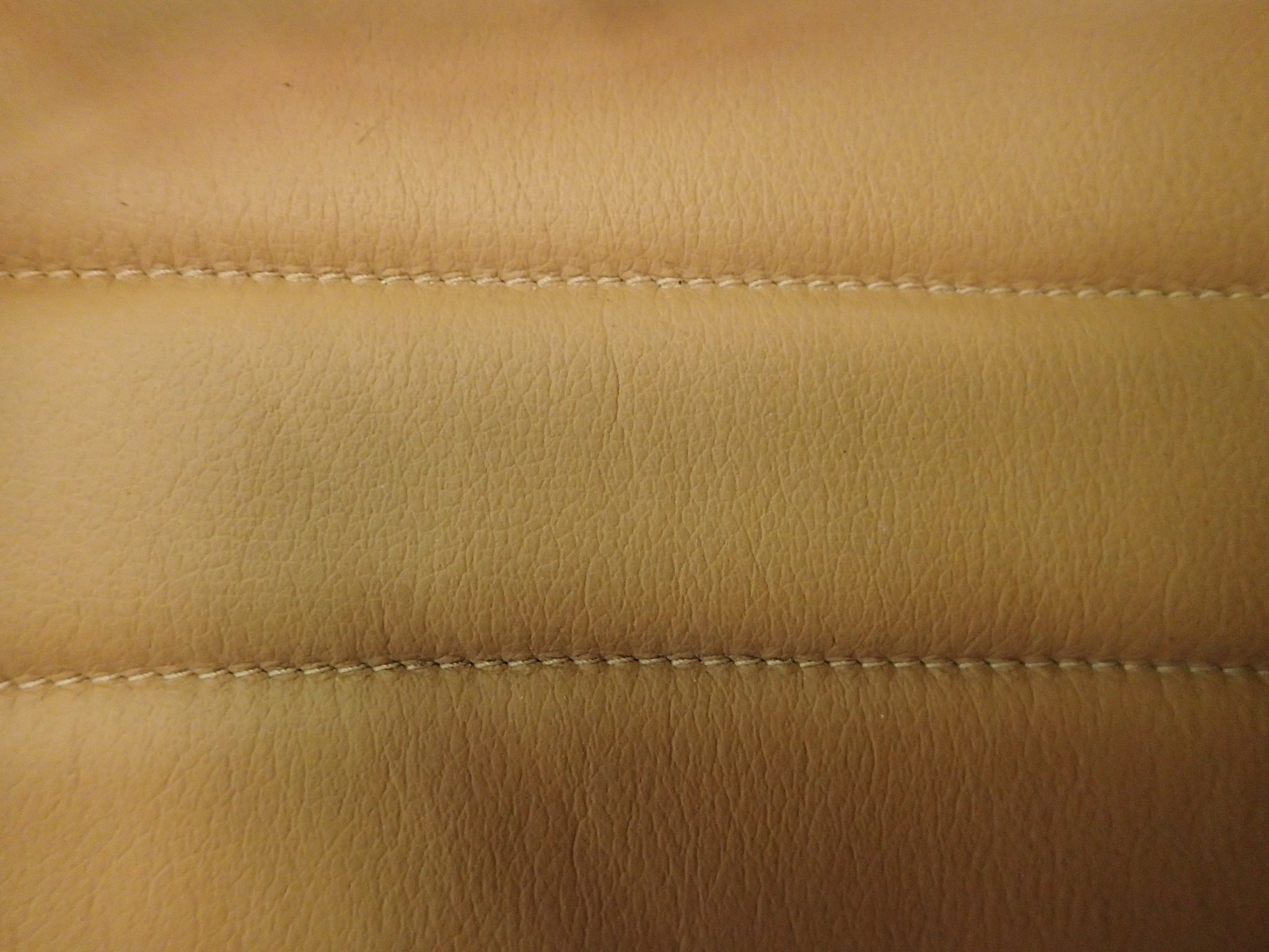

61 and 62 are my chairs (recaros), leather is a little darker in real life
65 - not my interior, for another car. Just to show the work. All my stuff is covered in protective plastic.
66 - my door vs the other piece

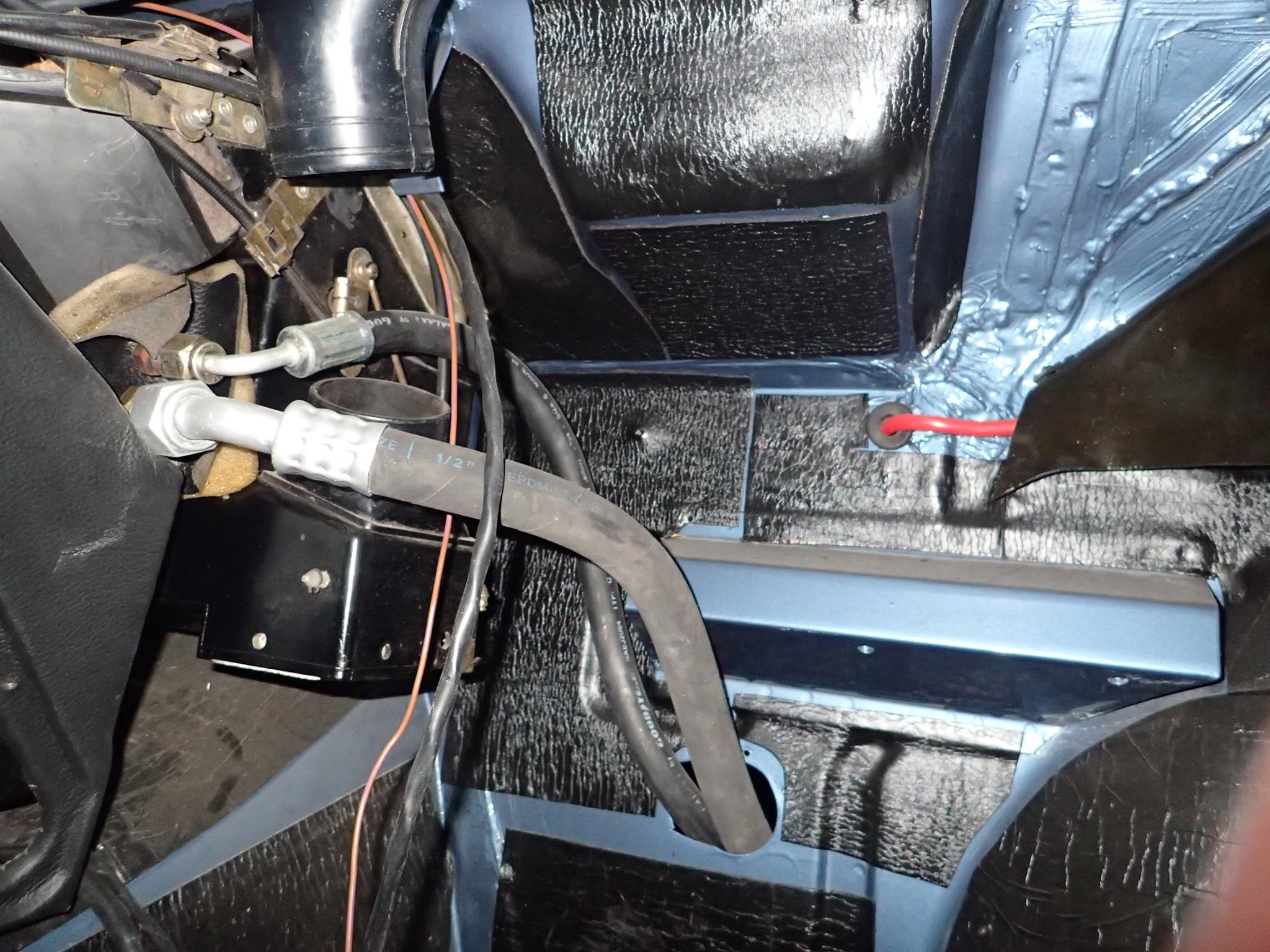

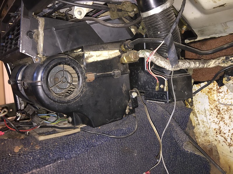

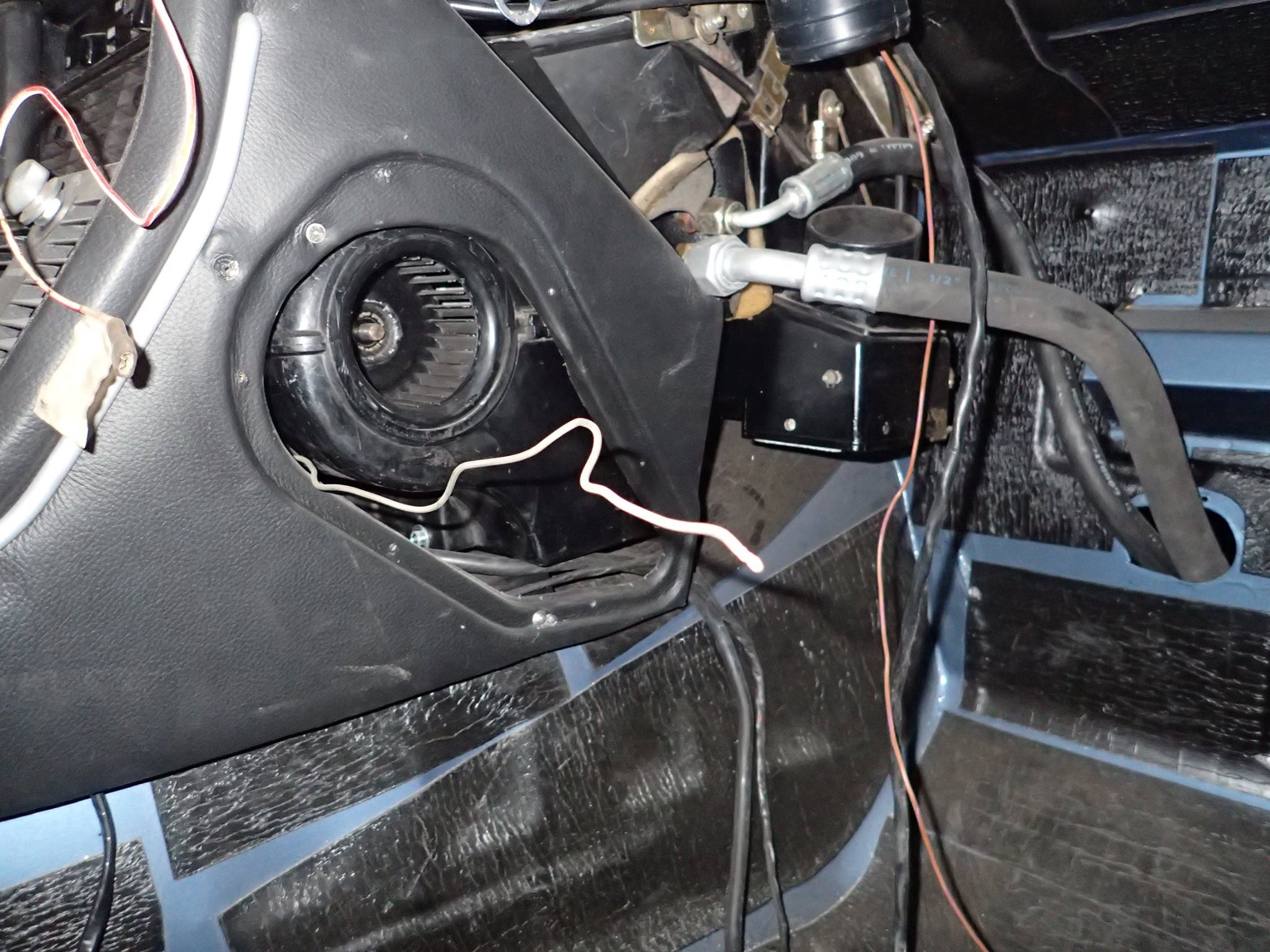

The A/C lines in US coupes are steel inside the passenger area, your hoses are going to interfere with the glove box. Be sure to insert the temp sender probe into the evaporator box, the hole is tiny and it needs to fit into the fins. I would touch up the spare tire well as you suggested too. Nice seeing so many photos of a very nice coupe coming back together.
AC is sold but here is a pic from my parts car for illustration. Ignore the giant hole to the right of the AC lines. If you look closely you can find a red tricycle across the garage.
Thanks both :)
I assume they will make sure the hoses will not interfere with the glove box. I can see why that is easier with the metallic ones like in Markos picture. I will also send a note about the probe and ask for the well to be touched up.
