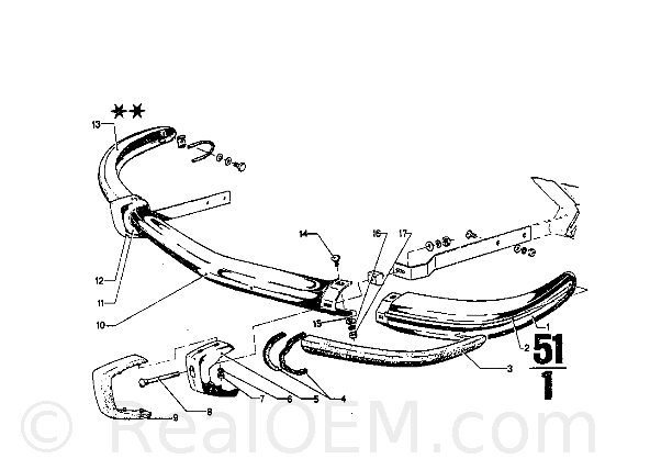

Looking for the bolts that mount the bumper 'arms' to the body/chassis, 4x needed?
Not listed in RealOEM, but here's a link
http://realoem.com/bmw/diagrams/q/f/30.png

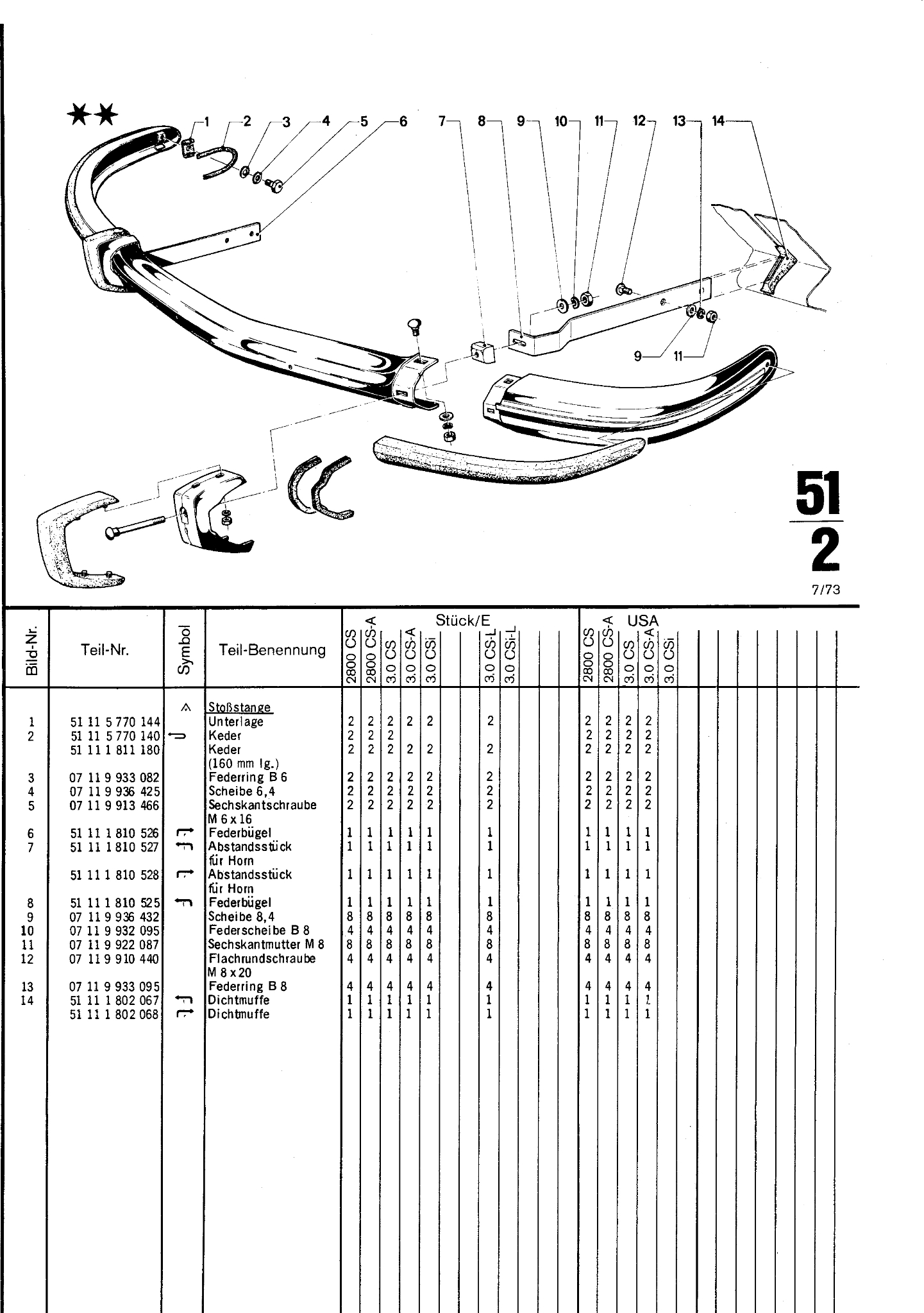

thx!
shanon
According to the original orange parts book, for the pre 73 bumpers, the bolts used were M8X20mm. These were probably carriage style bolts that slot fitted into the outer sides of the 2 engine support rails. As to how the factory fitted these bolts inside the rails, it will be good to know. If these bolts were to somehow drop into the rails during work to change out the bumper support brackets, they will surely be impossible to retrieved. Suppose when this happens, the only remedy is to drill though the other side of rail and use longer bolts long enough to accommodate the thickness of the rails and mounting brackets. Believe the 73 bumper mounting brackets utilized this longer bolt (M8X70mm) installation method.

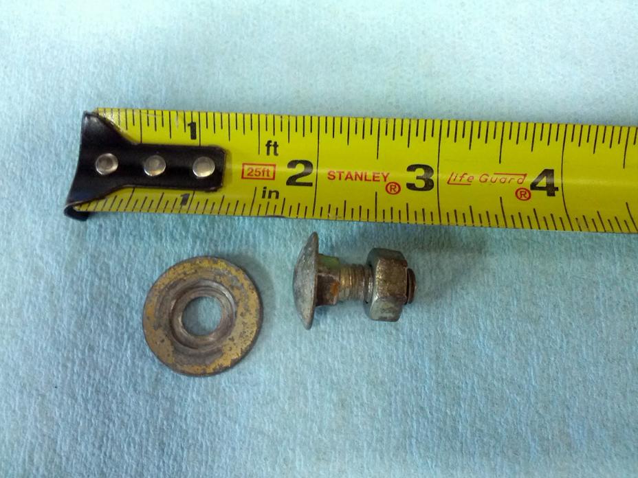

I just happened to have my front bumper and brackets off the car. The bolts are basically a short carriage bolt. I have included a picture for reference and sizing.
Looks highly crash-resistant! :-/
