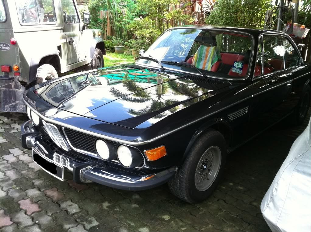

the front headlights have actually been fogged out, me n my dad will either try and have them cleaned, or try and source for replacement ones. anyone know where's a good place to get them? also, its not visible in the picture, but the BMW badge has been discolored, where's a good place to get replacements?

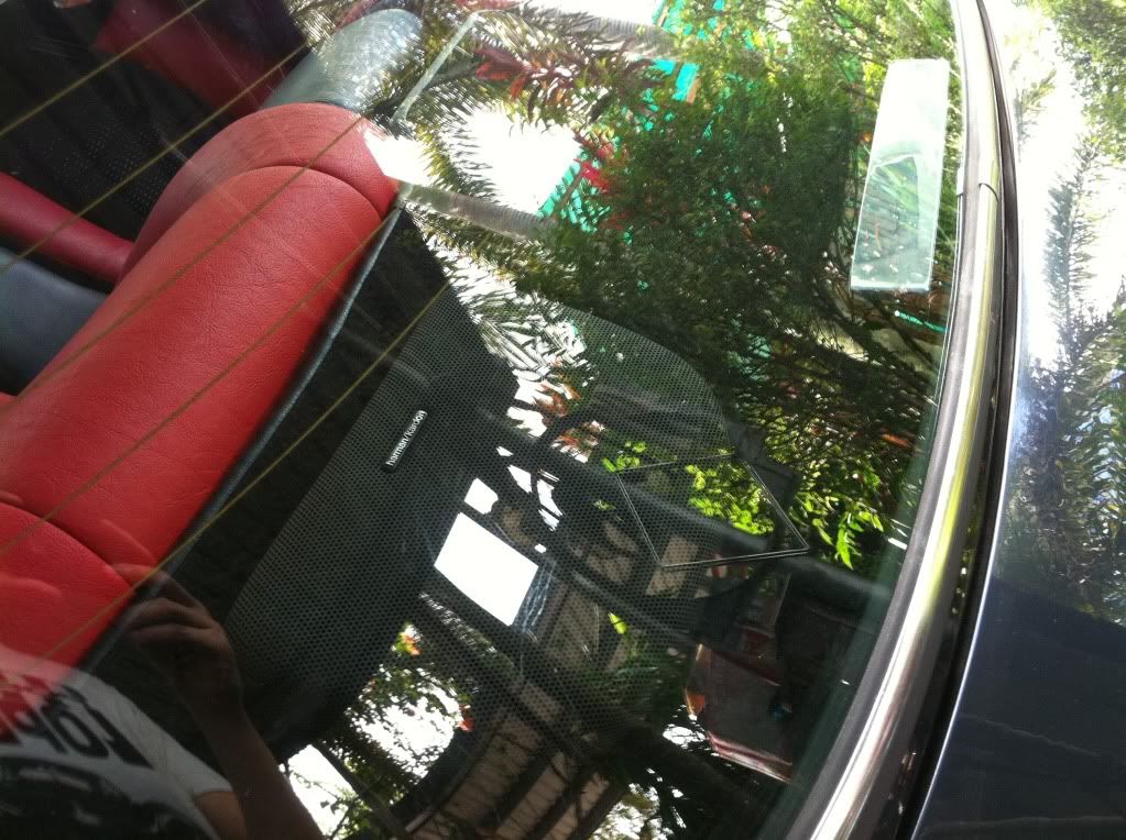

the speaker system was from another donor car, a pretty beat up Daimler Double Six we had lying around. a Harman Kardon system, its a really good system, only we havent gotten round to installing the stereo unit yet. i'm gonna try and convince my dad to opt for a more retro looking radio unit to go with the speakers, as he intended to bring over the Daimler's radio unit into our E9, it's gonna be sacrilege as the radio unit has the Jaguar logo on it....

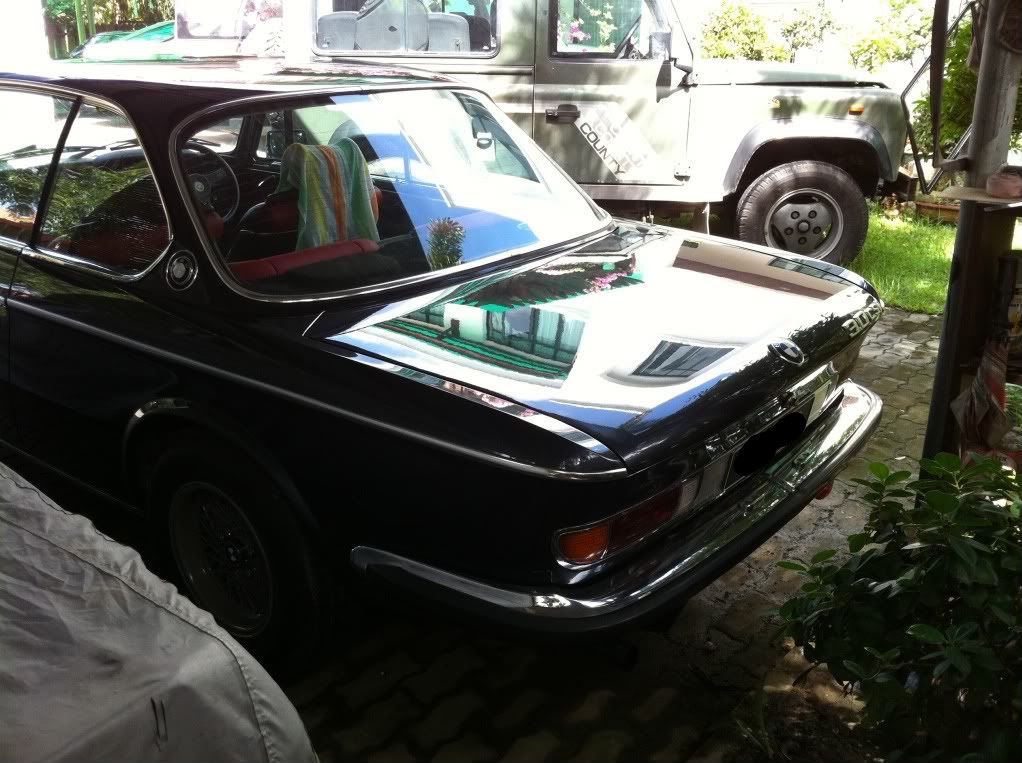

again, the BMW badge on the rear quarter panels have been discolored, recommendations for where to get replacements please!

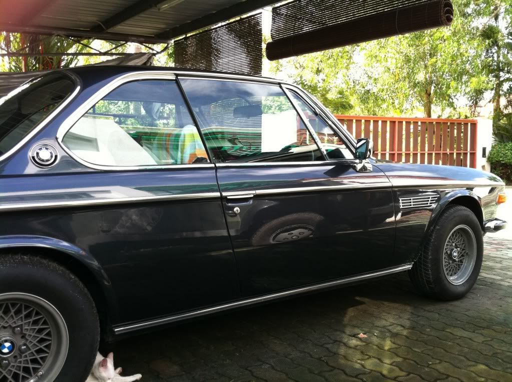

also, our E9 now has only 1 side mirror on the driver's side. having just one side mirror really lets down the overall look on the car in my opinion. anyone knows where i can get new ones? would i have to look for similar looking ones or are they all more or less a universal fit? i'm just abit worried that we might have to drill in new holes or something like that on the door, so preferably a new side mirror that'll fit in the current driver's side would be ideal. i'll try and get better pics of the current side mirror sometime soon, but for now these pics will have to do :p

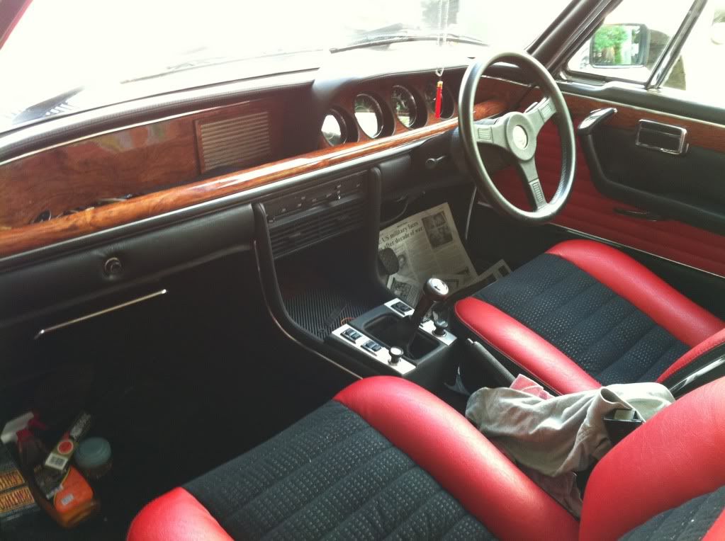

the interior, custom restored to as shown. only missing the radio head unit, and needs abit of tidying up. i'm gonna try n look around for a nicer steering wheel as well, those Nardi woodrim ones look really good but are quite pricey from what i've seen offered on the internet.... anyone knows where i can get one cheaply?

headlights available in bmw or w&n
bmw lateral bagde = very difficult to find an original (not available any more) only second hand
yeah: new parts made in china available, but the blue is not blue, but "violet" !!!
do not put another mirror, please !

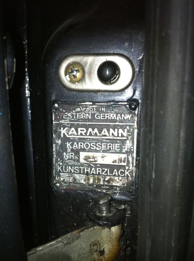

anyways, tried to register my coupe on the registry, but the VIN's been scratched off the plate....
know anywhere else on the car i might be able to find the VIN number?

The plate in the door jamb is the color code. VIN is stamped on passenger side of firewall and on motor above starter as well as on the steering column.
