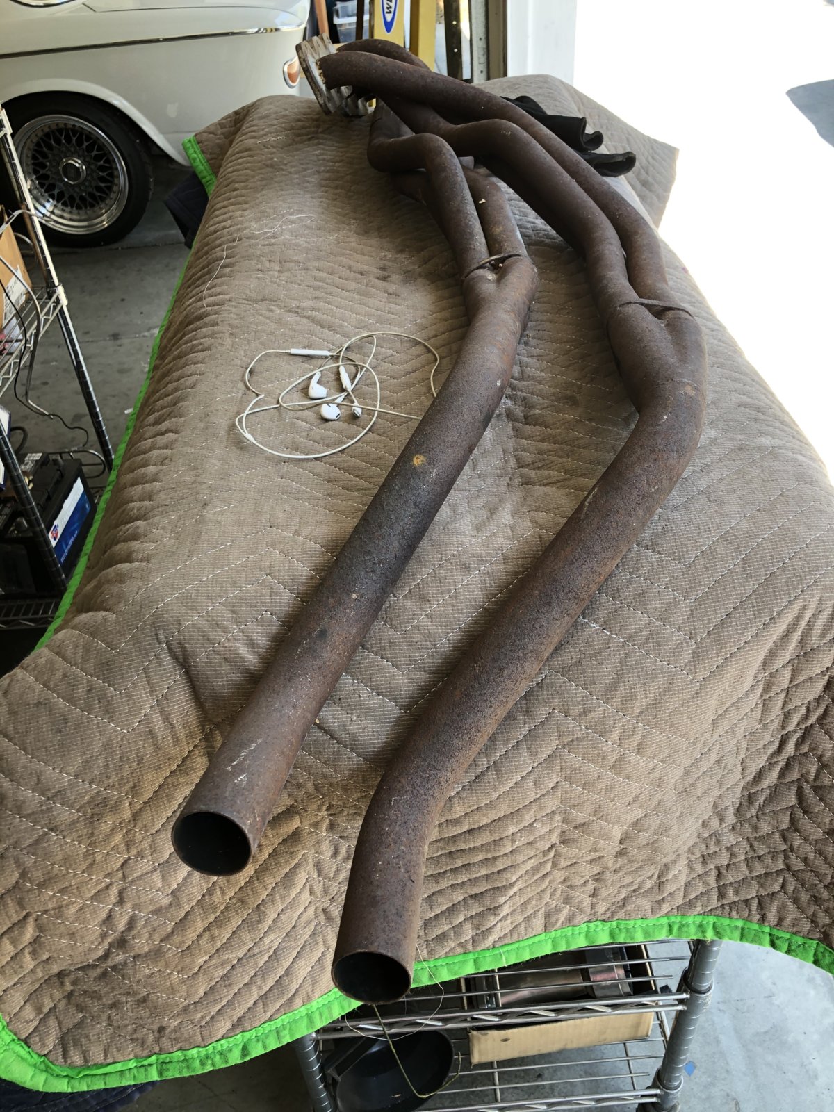

I should have posted this pic. I’m not sure what model they were for. The collector ends are 1 & 5/8” outside diameter

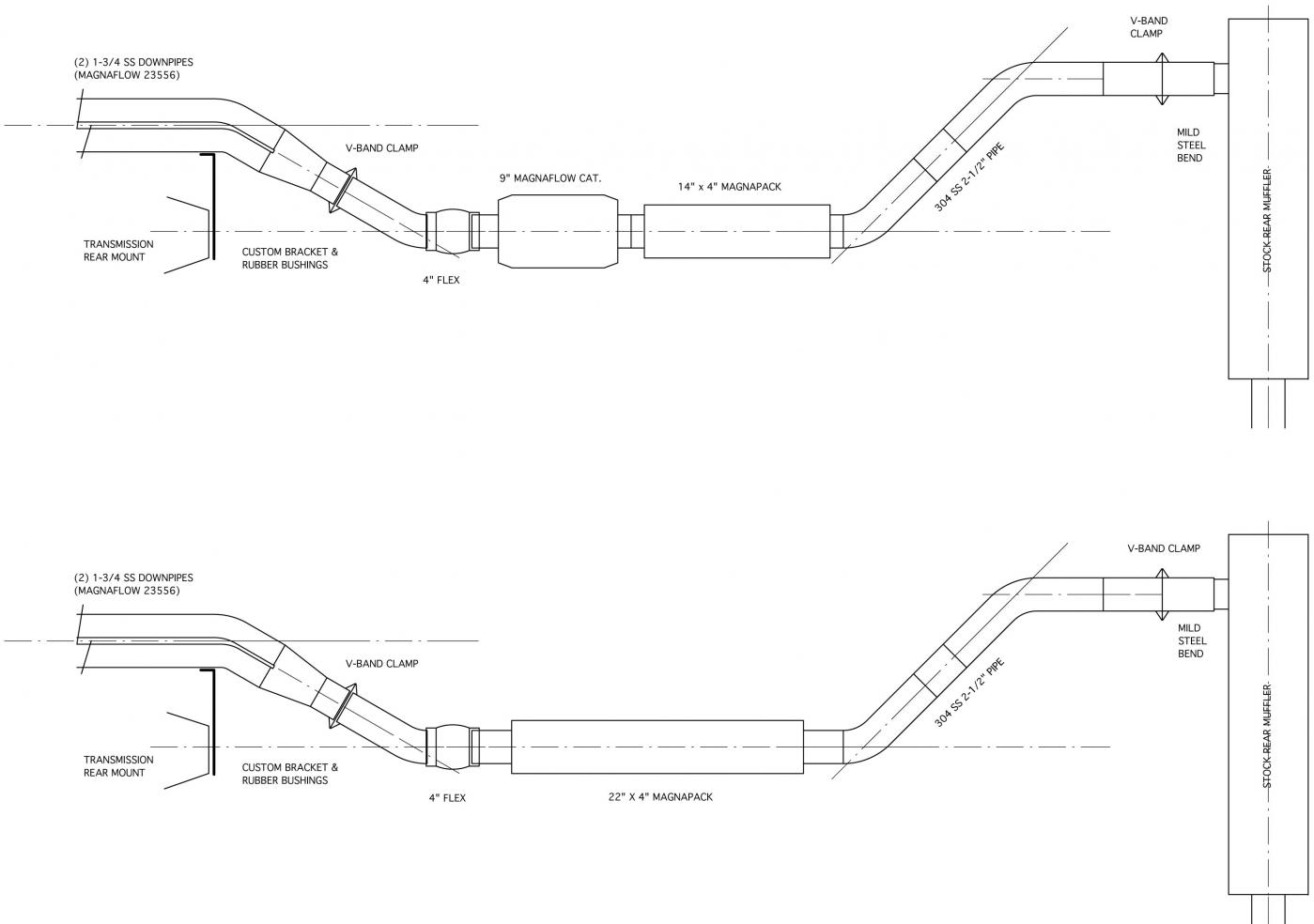

Barry, this might help. here is the drawing of a custom exhaust from @Sven. he joined the downpipes together and had a connector to the rest of the exhaust.

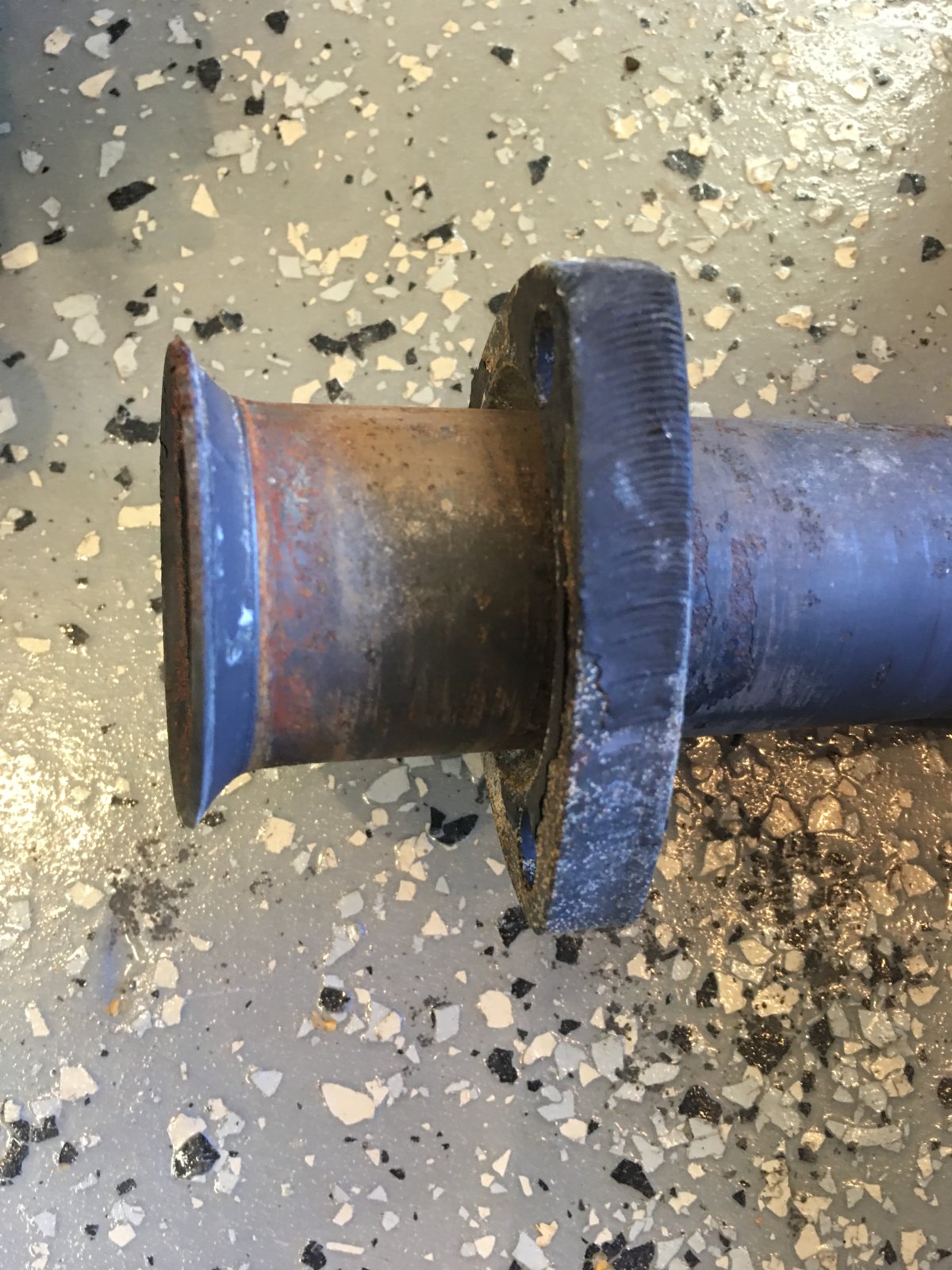

With Stahls you want to collect in the mid muffler. The factory muffler has two inlet pipes and one outlet. If you go that route, you need the floating three hole flange (see below). You are going to want to add the flange before coating. That means you want the rest of your exhaust all setup and test fitted first. Otherwise you will crack the coating when you cut and flare the pipe.
I used a Columbia River Mandrel bending 2-into-1 slip-on parallel merge collector - 1-5/8" in, 1-3/4" out. To that I welded a Summit racing 2-1/2 x 2 collector reducer ( inverted ) and use the 2-1/2" flange to separate the rear half of the exhaust system. I had a leak at the slip flange but a little exhaust sealant took care of that.

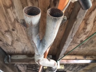

My exhaust has the slip type merge two to one as above with the tabs on it with bolts on each side, picked up the entire 3" tig welded tail pipe, and Stahl headers as set for $400, think the guy went back to OEM with the stainless Coupe King tail pipes...
