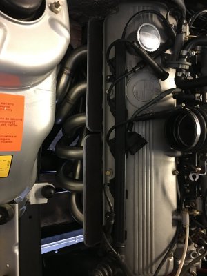

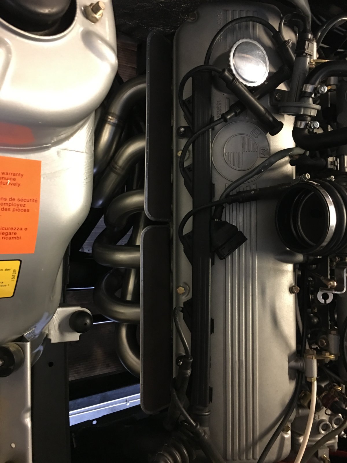

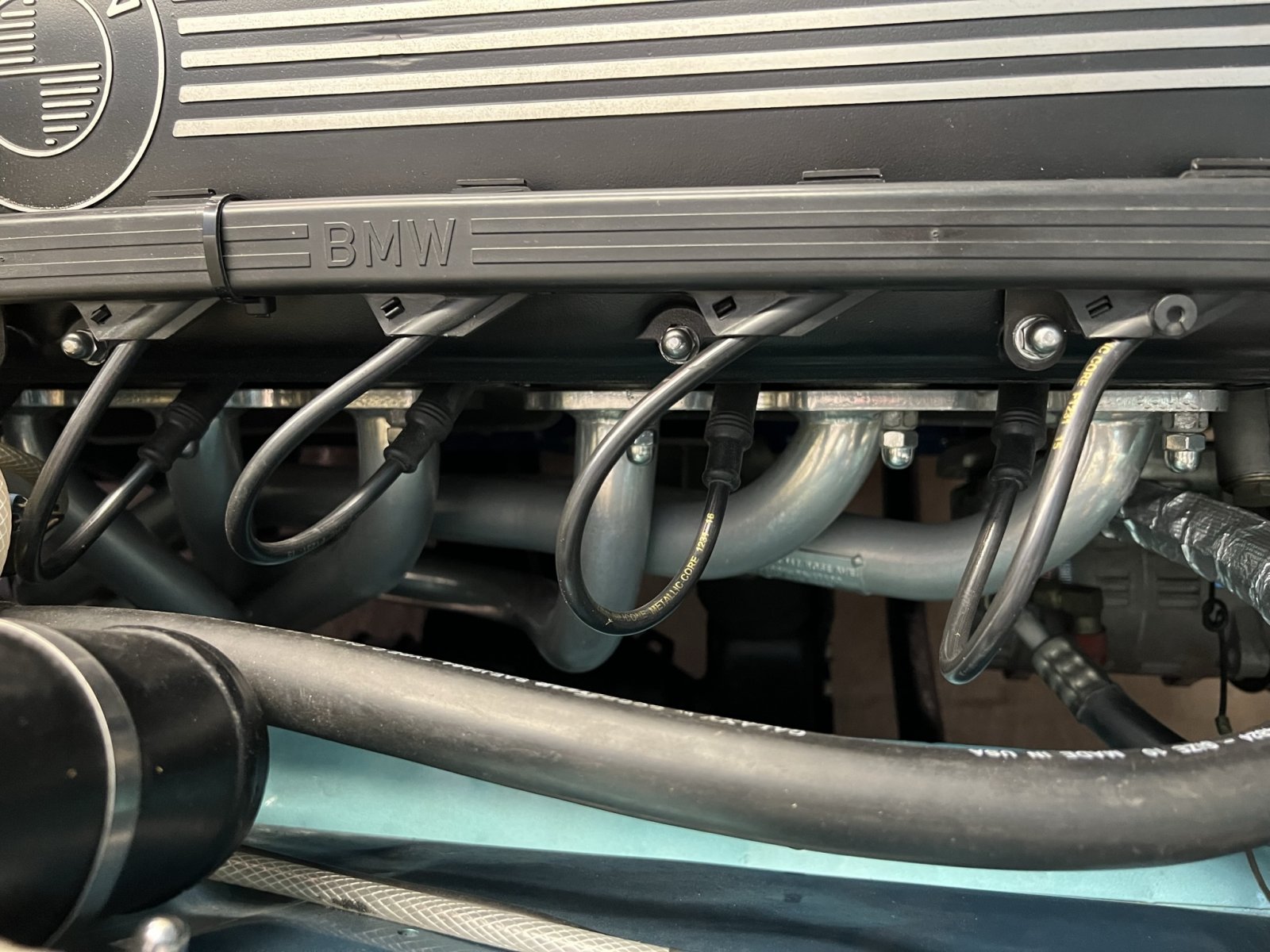

Here's a pic of the Stahl headers on my engine. They have a ceramic coating. The shop installed the factory gasket/heat shield upside down when they put the engine back after paint.

Just wondering....the stock cast iron manifolds are equipped with cover plates. These appear to protect the ignition wires from the intense heat from the exhaust manifolds. The Stahl headers do not appear to offer this protection. Any experience with spark plug wires suffering ill effects from unchecked heat in cars equipped with the Stahl headers? Thanks, Mike
Hi Mike. The later style e24 and e28 exhaust manifold gaskets provide shrouding for the wires. That is what I used for my Stahl install.

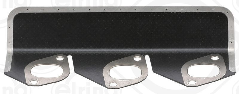

That type of M30 gasket/cover might be used

out of curiosity, is there a part number on this flange gasket? i know i had one on my 2002 but i think my coupe just has regular gaskets
where can we buy this M30 Gasket? who sale this gasket
There’s a link directly above your post.

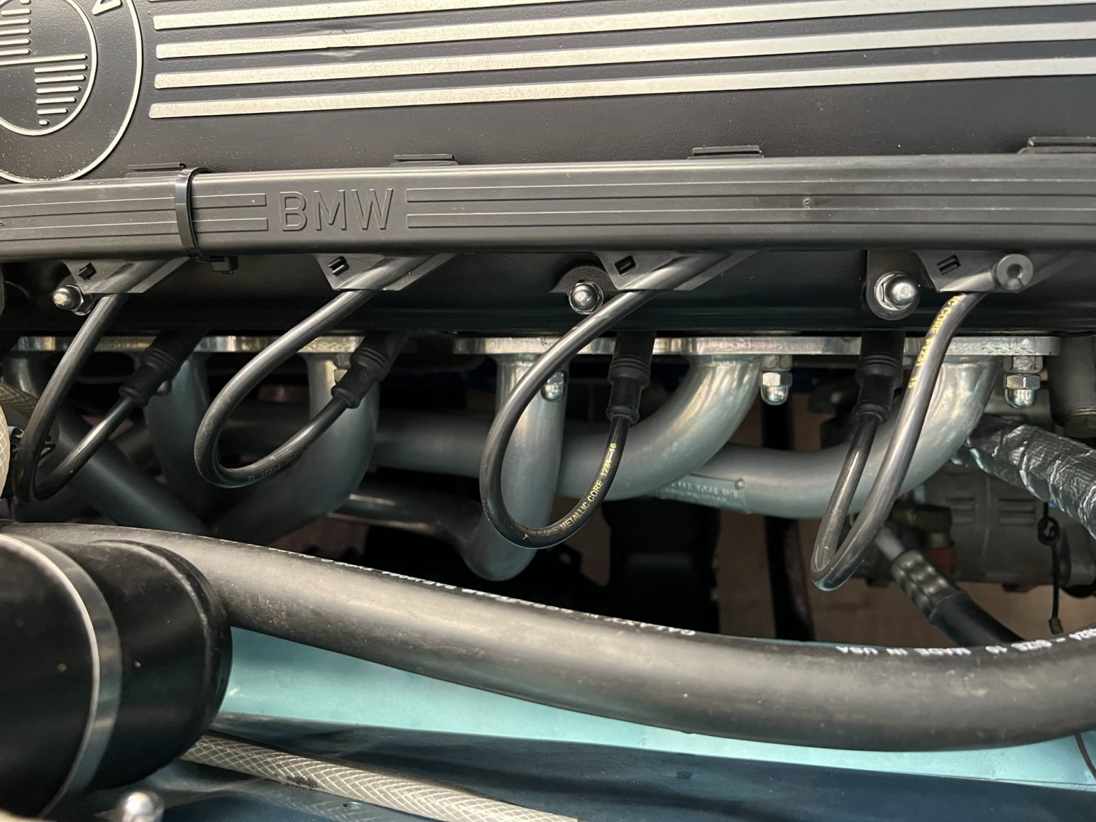

I used those gaskets with a set of headers on my E12 530i. I did the same thing with the SuperSprint headers I put on my E12 M535i and have gotten a lot of flack for hiding their beauty. I figure better safe than sorry as there’s a lot of heat there now.

My car has that heat shield gasket. It was correctly installed before the engine was removed. Now that I have driven the car for over 3 years and 15K miles with that Stahl header having a ceramic coating, and the gasket installed upside down, there is no evidence of the spark plug wires, or any other part, being affected.
