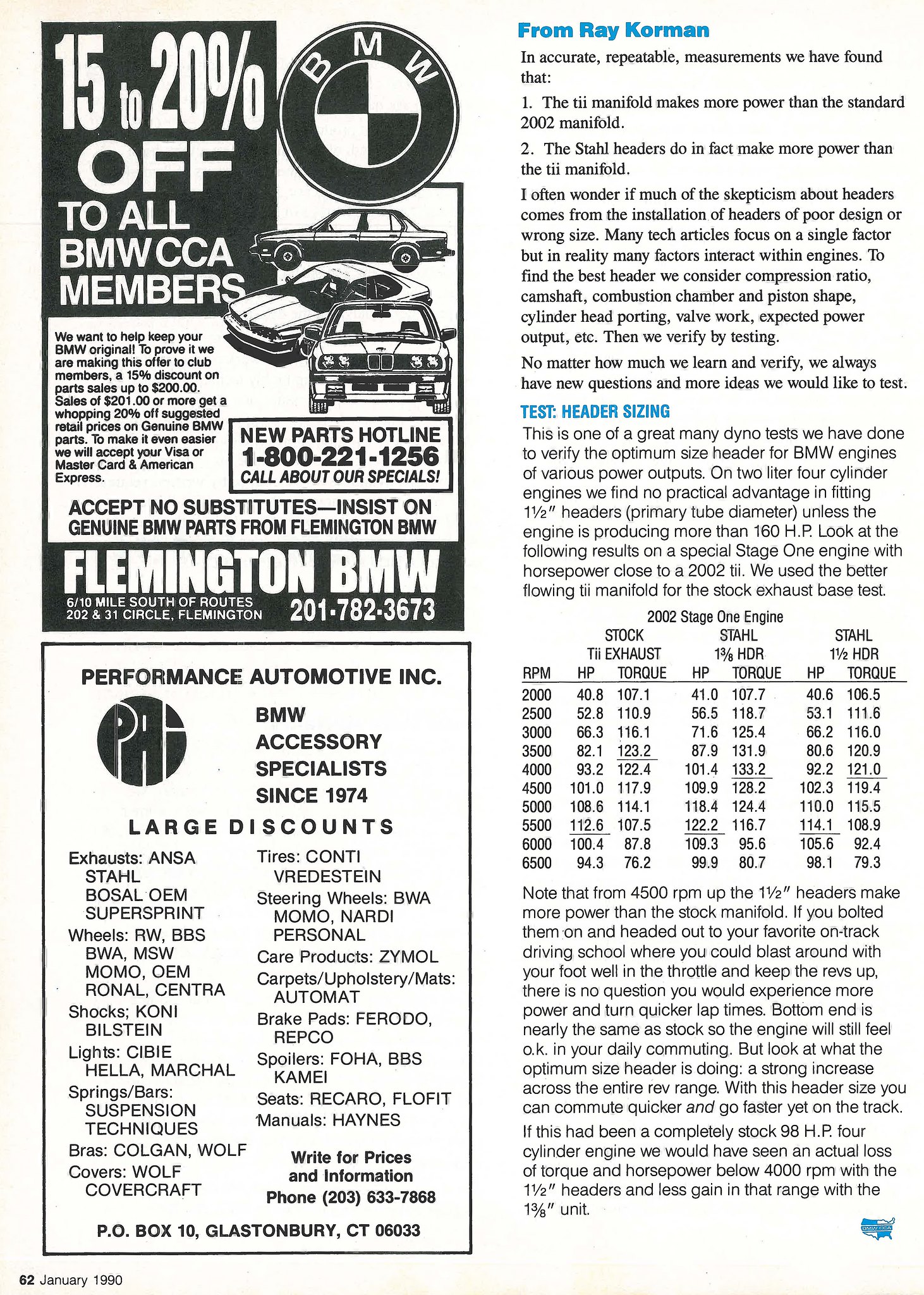

I've been looking into this also. Good article from the Roundel below!
Shannon - Yes, that's what I was landing on - primary tube size of 1.375" or 1.5". Which one? Not sure.
Mario - Please do let me know how the prospect of running a quantity of these headers in stainless steel. I'd be keen on participating. Perhaps if enough of us are interested, economies of scale would benefit the group. ;)
Stephen
The difference in area between a 1-1/2" tube and a 1-3/8" tube is about 20%.
One of the largest errors street enthusiasts make is in running too large of a primary pipe, and too large of a collector. For example, NHRA and IHRA Stock teams using Burns’ headers in H/SA in traditional small-block powered musclecars are running 1.5-inch diameter primary pipes- much smaller than many street machines are trying to use.
