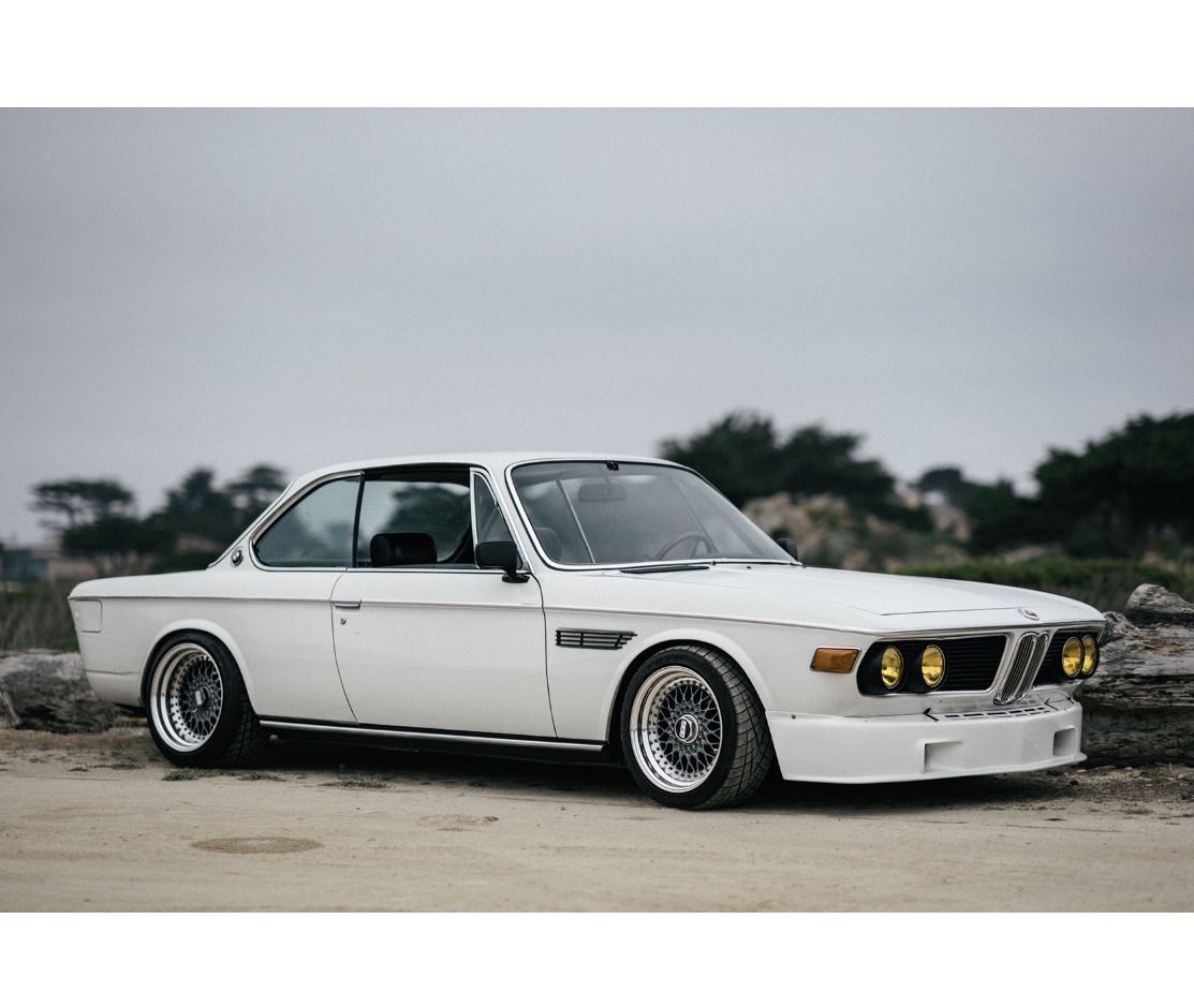

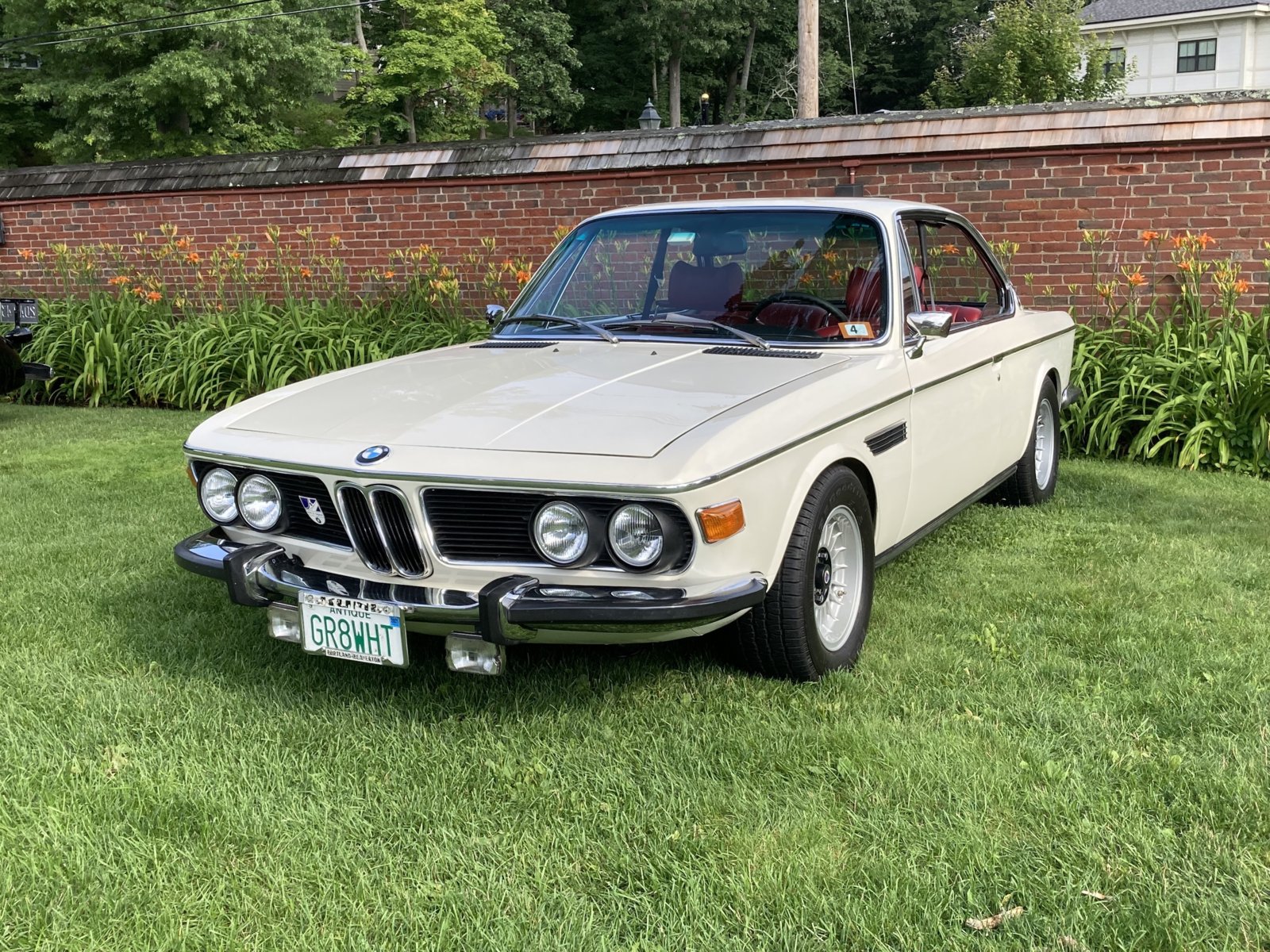

Carl Nelson springs, Bilstein HD, rolled fender lips.
Stan that picture is beautiful, the small fog lights are a nice touch.
I was waiting for Stan to weigh in on stance...
The Previous owner bought almost all of the suspension modifications from Carl and Ireland 16 years ago per all of the receipts in the file. He had 205/60X14 tires on the stock FPS wheels. I changed to the 16X7 BBS wheels with the 205/55 Michelins. The front fender lips needed to be rolled. Corners at speed seem to have neutral handling with this set-up.
yes Robert, there is a lot going for you with that picture - a. the car is white (many of you wouldn't know that he has several white BMW), b. the wheel centers are darker (but not black), c. its low

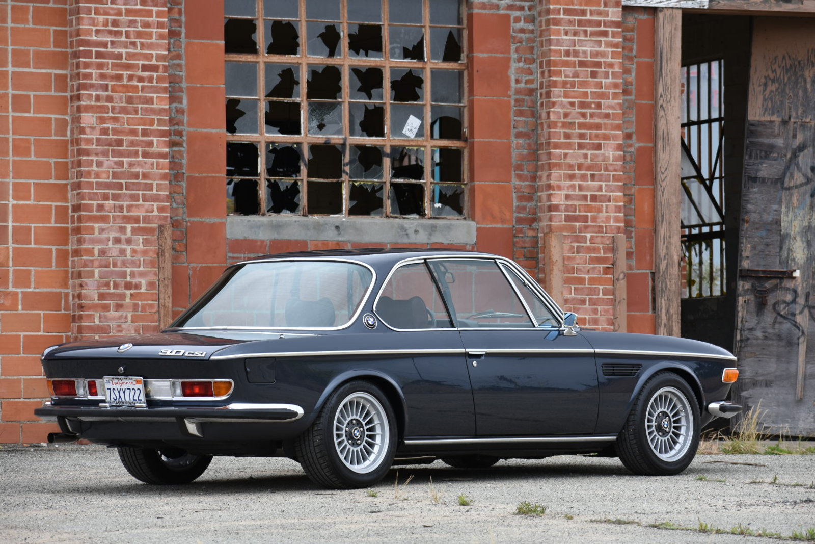

OCCoupe, If my "Nelsons" were as pictured in your photograph, I'd be a fan. As evidenced by photograph #2, they didn't work for me.

Barry = 16's or 17's? 215/45-16 tires are 23.6" diam. which is more than 1" smaller diameter than stock. 215/45-17 is 24.6 / 24.7" ... which is much closer to stock. they look more like 17's in the pic
