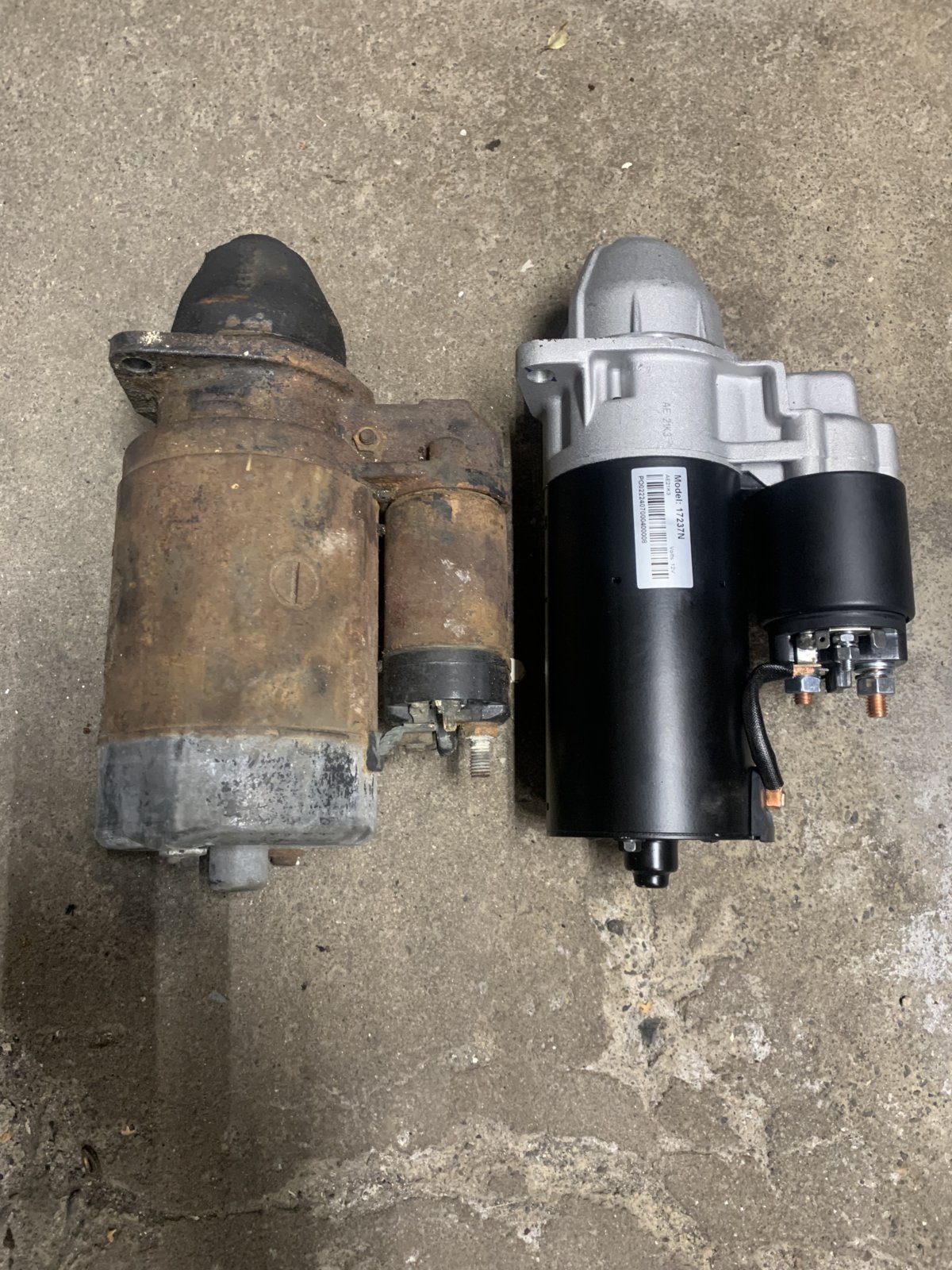

I think the model hb Chris shared is better on many levels. It's smaller and stronger, spins faster, and more torque. I switched last year and it noticably spins the engine faster.

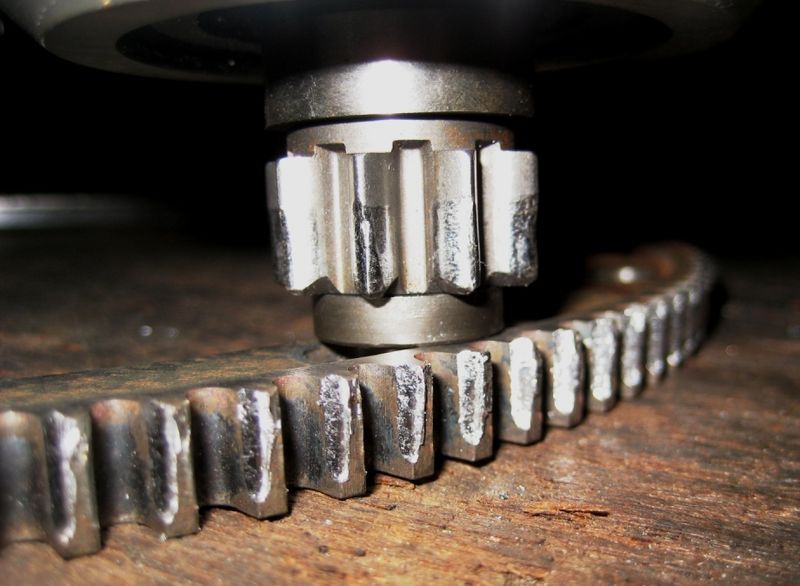

Hypothesis 1 is that the solenoid isn't throwing the pinion gear rearward (or far enough) to engage the ring gear. This suggests a worn area on the ring gear where the pinion makes no contact at all, as shown in Toshi's post 11 above. It may still start if in good tune and the pinion catches where there are still teeth. Hypothesis 2 is that the starter isn't reliably grounding.
