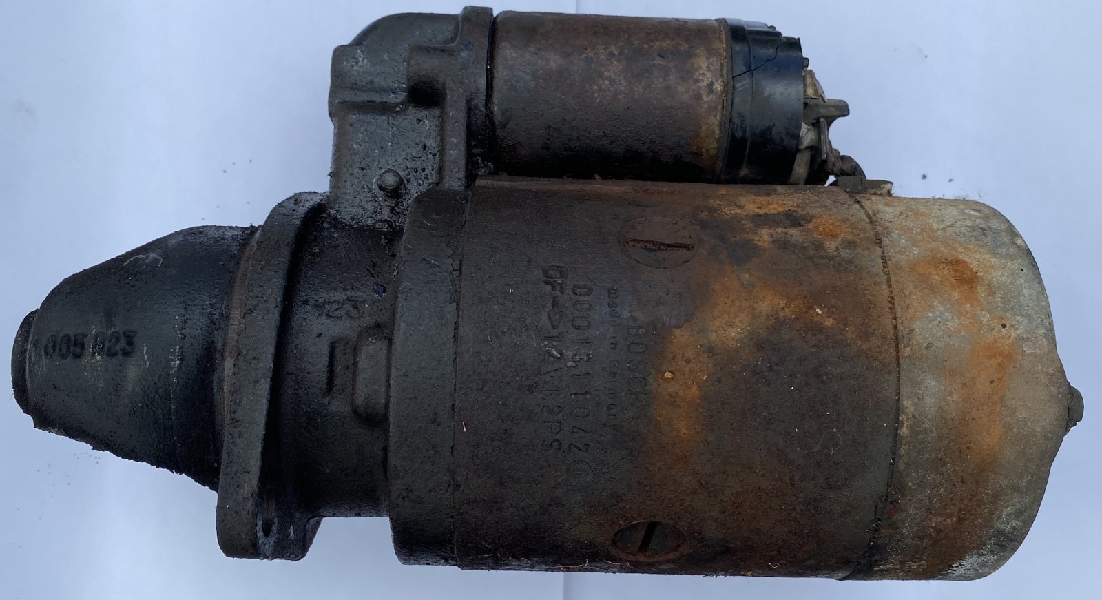

I finally got around to it and slayed the dragon. It took several hours and some "customized" 17mm wrenches (Harbor Freight - so cheap enough for sacrifice). The old beast of a starter is out of my E9. The visible flywheel teeth look good and undamaged, so I suspect it was the solenoid that has gone bad. When I tried to unbolt the power connection, the actual housing of the solenoid gave way... Installing the replacement will start this weekend.
The core is looking rough - I don't see this being a viable reconditioning candidate.
