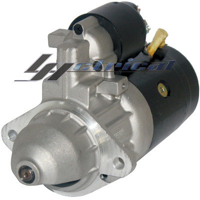

Since you have an injected model- go with the best...
850cs starter with Planetary Gear Reduction
Dirt cheap shipped from the States.
Shipping is - wait for it...wait......
US $16.99 (approx. AU $24.54) Express mail
Price: AU $ 173.33
100% NEW STARTER FOR BMW 750,750IL,E32,E38,850I,850CI,850CSI,E31*ONE YR WARRANTY

You are right- Australia shipping is extra 71.00 US
Does "the best" starter work on all M30 engines? Is this the default replacement for our cars? I see re-manufactured Bosch units (part number 12411272150) for mid $90s. This isn't that much more.
SR-71X with the small case, SR-440 or 441 are all similar and all fit just fine. The SR-444 may be the best but they all have permanent magnets and spin much faster with less drain.

might just need an overhaul. My mechanic did mine (cleaned up the brushes etc.) and all working fine now.
personally i like to keep the original part if it’s working just fine.
The new ones are much easier to get on and off. I’d replace both to reduce the risk of being stranded.
If you decide to overhaul, make sure the bushings are replaced (front and rear.) They wear over time, then the armature contacts the magnets and boy that drains the battery real fast...Also, with the original motors the magnets begin to crumble apart, so check for that.
