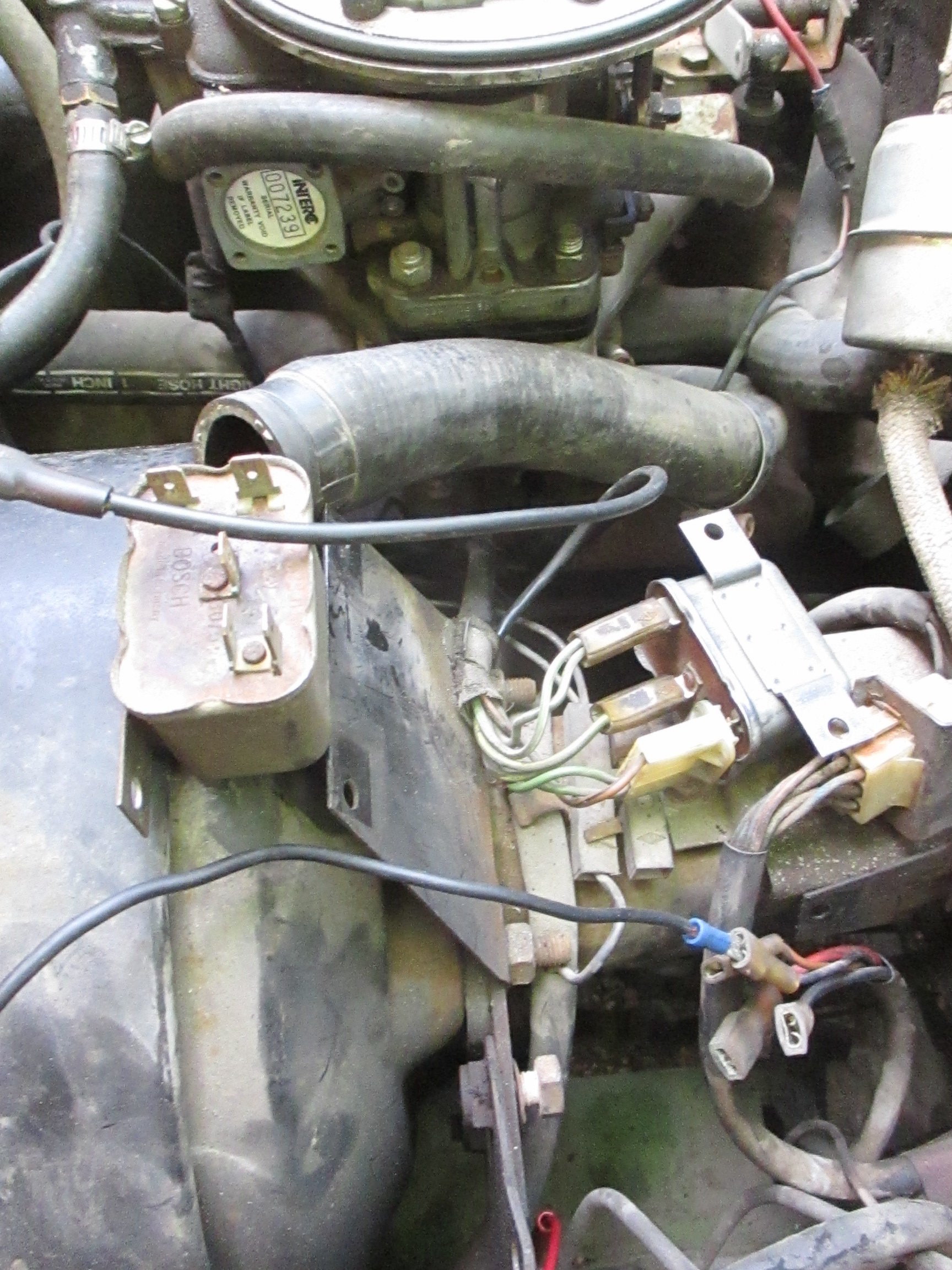

1) In the attached image the 4 prong relay with green/white wires etc is from the bracket on the left. The free relay came from the bracket down on the right, cluster of wires shown joined to this. I was assuming 4 prong was the starter relay, now I am guessing it is the other.
2)Black wire hanging over free relay was joined to the starter at 6 o'clock. I assumed this was the black wire we all spoke of but actually the sheath is black, wire inside is green with white stripe. This wire has power with key in "on" or "start" position. It has no power if I disconnect the clean 4 prong totally or if I manually activate the clean 4 prong with a 12V source across the 2 spades after removing the double female connection in white plastic.
3) Other black wire with blue junction I ran to starter at 6 o'clock. It is joined to a black wire from the removed free relay which gets power only with key in the "start" position....eeehaaa so as presented in this picture, the key and starter work the way they are supposed to. Black wire is smaller gauge than other black wire that went to this relay and smaller than black wire from starter switch.
Both relays click when a hooked to 12V.
Now the only question is, where does this black=sheathed green/white wire go to ? Does it belong with the free relay and the black wire I have hooked to the starter stay the way it is with no relay attachment?

I think you already know the problem. Green/white wire never goes to starter.
Pm me with ph. Number and I will walk you through proper connections tomorrow.
So the saga ends thanks to sfdon who walked me through the wiring. Without his input, I would have never figured ts out.
Starter relay power input was only 2 volts, not 12 so the key in the "start" position did nothing. A previous owner switched from Zenith to Weber (I am unfamiliar with Weber) and was using the old "always on" power to the Zenith chokes , to power the starter. Apparently they placed the choke wire to the starter and once started, I guess would pull the wire and let it hang in the breeze. Delivering 12v to power the starter relay allows everything to work the way it should. The 2v to the relay was because of a poor connection of the relay power wire from fuse #5. Probably a one-time scenario never to be repeated but knowledge is knowledge. Again, I have sdon to thank for keeping what little hair I have left.
