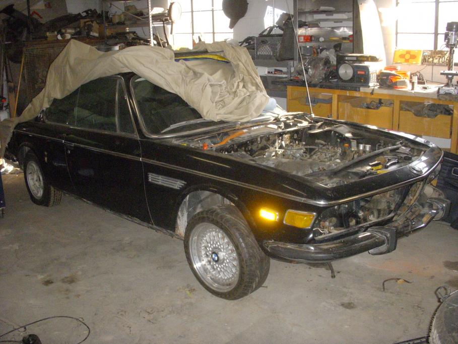

I am starting my slow build on my 54K mile schwartz coupe. It is a 72 vin #2250050 which puts it as the 50th automatic made from what I understand. I am the second owner and thanks to Dave in N.C. helping me put it together. All in all the car is very dry, the passenger side door has some rot at the bottom, the squegy leaked on this side as it sat under a carport for years. The mice ravaged the wiring. This interior is great and will be wonderful after some good treatment with leatherique. I am planning on pulling both subframes blasting repainting with all new bushes brakes etc. Of course the engine and auto are coming out as well. Here is the big question???

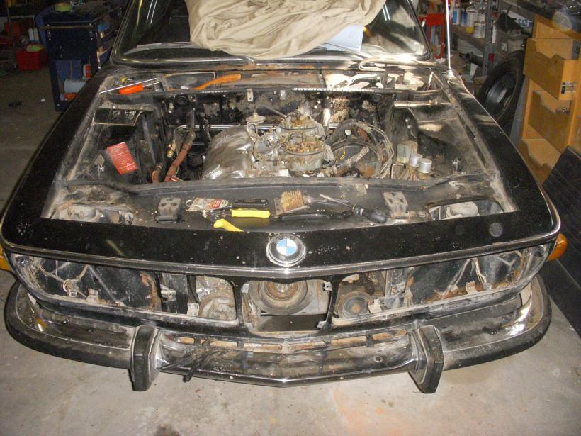

Here are some pictures of the E9

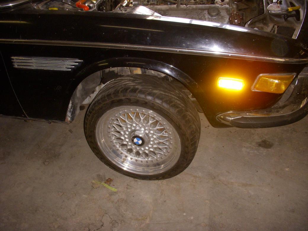

THe first 2 pictures shows the 3 piece BBS 16" wheels I plan to run.

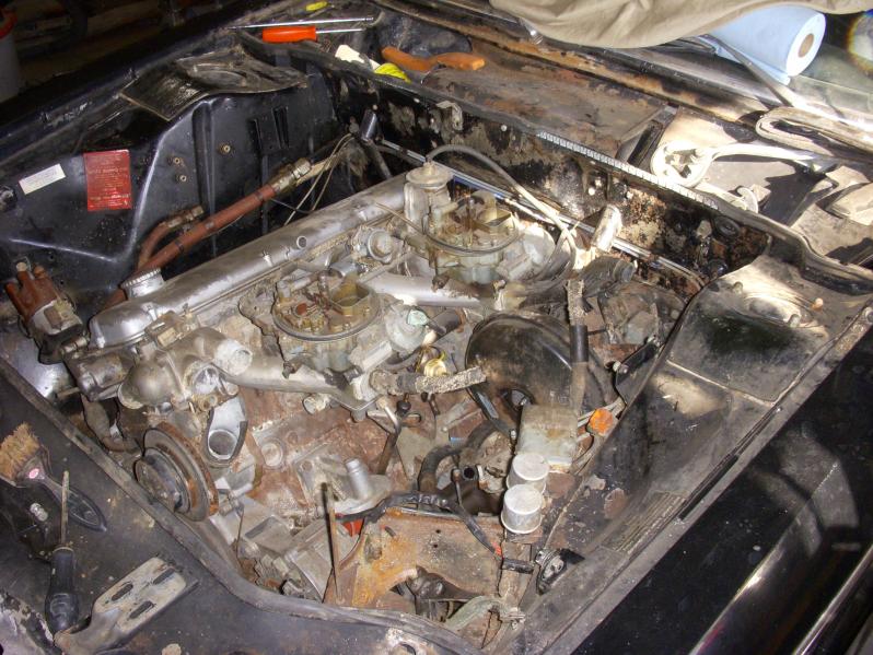

THe next 2 are engine bay shots the "rust" seen is all superficial.
The last is an interior shot the seats are nice but the stitching is dry so most seams are seperating.

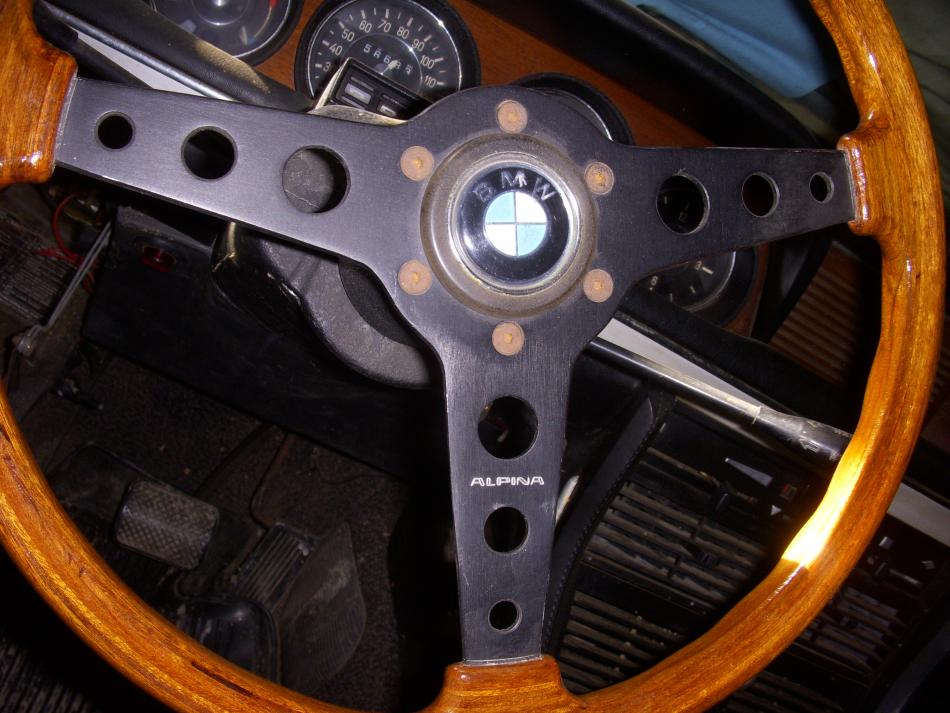

The first shot is my Alpina wheel, this wheel is from 1968 and from what I can tell is one of the first 12 wheels from alpina, it is flat and not bent towards the driver, I just had the wood redone. I would like some input from what you can see in the pictures I know I still need work on the Allen head bolts. I also have this set of Scheels I was pondering what do you guys think? They appear to be two different styles.

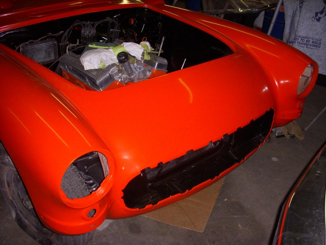

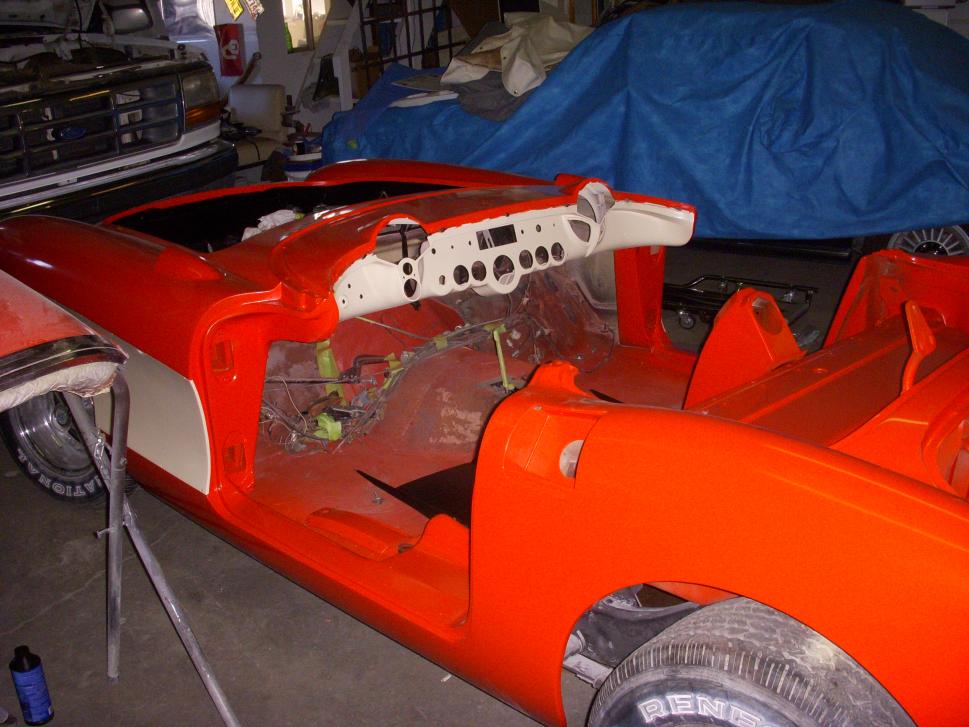

The last two pictures are of another project I am working on a 1957 Corvette with 43K original miles, 2 4 barrels, auto, with all other options including the rare power/hydraulic top
