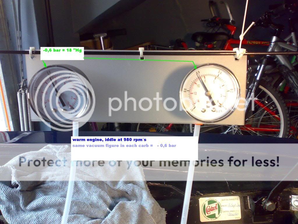

this is my system, i bought two vacuum meters (0 to -1bar)

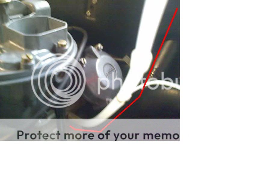

the question is that i am plugging them here:
and i don´t like the meassurement, the needle is constantly shaking while reading
you are right that the sync is very straightforward with this method, and also the high rev and the burl knob adjust
having those two, connected directly to the manifold (I use the connector on the brake booster side of the manifold as I´ve blocked the connection to the air filter anyway) I get a very precise reading and can play with the revs, sync not only idle but also load conditions and can watch the sync when revving up, thus optimizing the burl knob adjustment in the linkage.
do i understand you well?, are you connecting to the same point as me ? ( i have blocked the air filter connection also ) if that is the case,...do you have the mentioned vibration in the needle of the gauge ? or do you have a steady condition ?

First off, yes, I use the same vacuum take off point as you. I believe it to be ideal as it is full manifold vacuum under all conditions. Also, if you, like me are no longer using these points for anything else, you´re not changing the setup in any way from the actual running conditions and can even leave the full air cleaner attached while tuning (not for convenience, but for precision)
The reason your needles are jumping so much ist that they are regular vacuum dials. The engine doesn´t create a constant vacuum though. It´s a pulsing vacuum that pulses with the strokes of the engine. You´re basically looking at three air pumps as found on a bicycle that are connected through the manifold, thus you get a pulse in the vacuum whose frequency varies with the revs.
The boehm synchro clocks have a separate damping device built into then (adjustable through a knob on the vac line that allows one to adjust the damping so you just get a steady reading with still a very quick response to changes in the vacuum. Unfortunately I do not know how exactly that mechanism works and how you could build such a mechanism yourself.

Looking at the description of the Boehm dials on their website, it seems that the variable damping mechanism seems to be no more that a rubber washer with a very small inner diameter that is squashed by a ring nut to modify the inner diameter. So you may be able to get some reasonable damping by simply experimenting with a piece of smaller diameter tube feeding your dials. If you have a rubber line, you may even want to try squashing it by hand to see if a reduced throughput makes the needle jump less. Don´t worry about the accuracy of the reading: as long as the vacuum get´s through at all, the dial will read correctly, it´ll just even out the pulsing.
