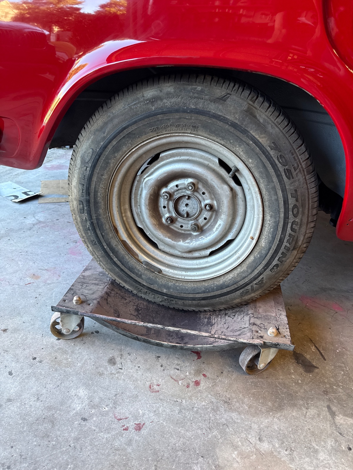

While searching for a set of steel wheels I note that some have small holes between the stud holes and others don't. Were these for alignment with spigots at some point ?. My car doesn't have spigots but the original spare does have the extra holes. Just a query as I'm not bothered since they will be covered by the caps. I see that this wheel without the holes is from 1970, mine (not the one in the photo) with holes is 1972 so presumably the change happened sometime between those dates ?.
The extra holes were used as reference points for wheel alignment, first with bubble gage-based, later using light & mirror-based optical instruments.

My original wheels have the holes. Mine is a 73 with a 9/72 production (which is also stamped into the wheel). Just using these for rollers until I’m ready to buy tires for the new wheels. These tires are from 2021..they will not be driven on, don’t worry.

Thank you, that clears up my query at last !. It looks like pre '72 wheels don't have the alignment holes or at least all I've seen are 9/72 have them and a '69 wheel doesn't. I have bought a set from Germany so all sorted now, thanks.
