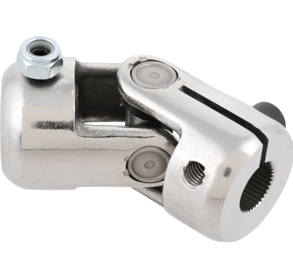

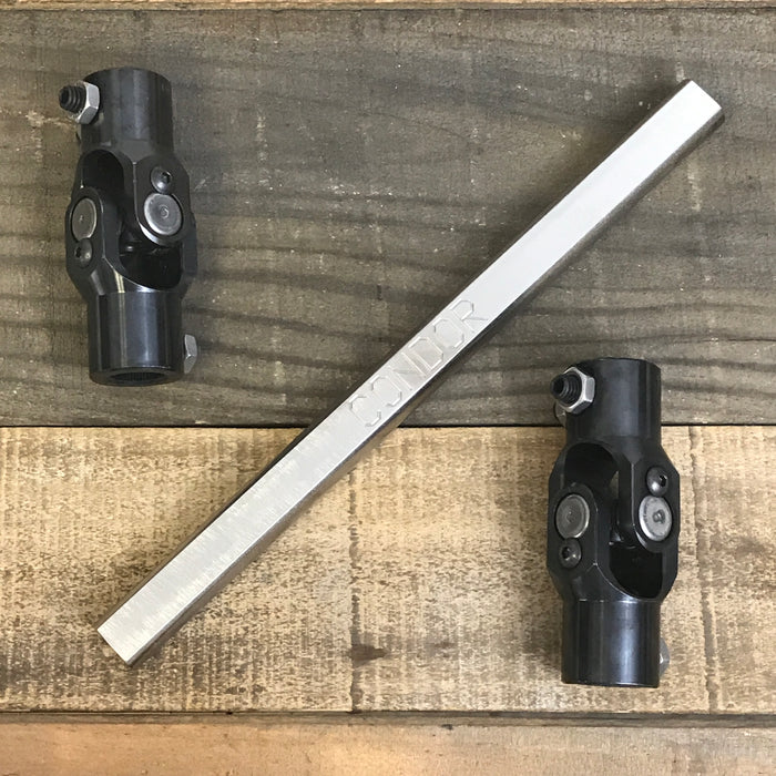

With this news, I think it would be safer for me to make a new shaft. It isn’t difficult to source a 1” DD to 17mm x 36 spline joint. Then you just cut the DD bar to size and have the same joint on the other end (presumably - if it a highly available 54).
Vendors already sell DD bmw steering columns. Here is an e36 example:

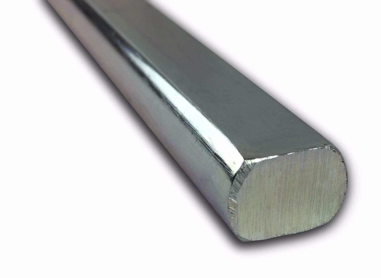

I’m new- what is DD? The plan makes sense though, just wondering what that stood for.
It stands for double D, based on the profile of the shaft. It can’t spin inside the coupling because two sides are flat.
