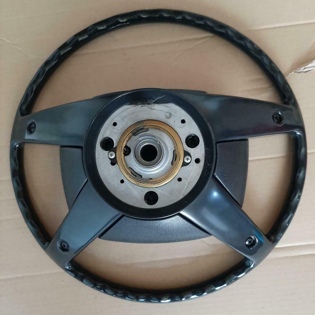

Is this an e9 steering wheel ?

I’d say yes, from/ for the later face lift cars. Has the correct horn ring and the signal canceller.

With removable hub cover, yes, 74 coupes and Bavs. Depending on size though it might be 2002 which is smaller, 40mm. E21 used a non-removable hub cover, access to the nut is behind the roundel.

I’d have thought that a 2002 series wouldn’t need the horn ring, rather a plunger?
