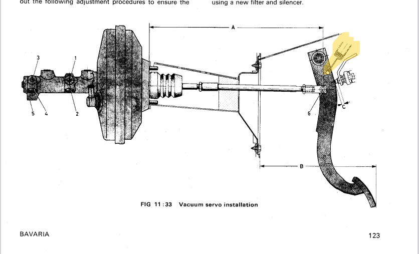

Have you examined your braking system lately? Bled the brakes? Checked for proper caliper operation? How old are your flexible brake hoses? Does your vehicle track in a straight line when braking? Your symptoms might be due to a component not releasing properly, such as a caliper, or the master cylinder, or even a flex hose that is is showing its age. While brake power boosters/brake servos are long lived and ordinarily trouble-free, nothing lasts forever.
As noted by stphers, the issue could also be as simple as lack of lubrication or a failed pedal bushing. Although a "limp" pedal is often associated with a missing or broken pedal return spring, you might still examine yours to ensure against something near the pedal assembly that might cause binding.
