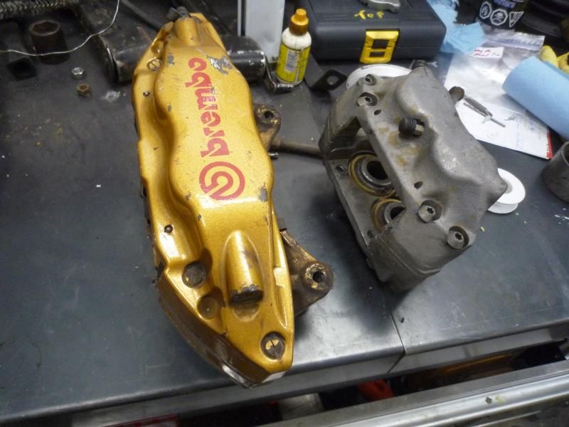

I thought I'd provide a visual of my own rebuild. There's a certain amount of satisfaction for me in knowing all components are original to the car and ready to deliver another 40 years of reliable service.
The black schmutz applied to the underside and calipers was very difficult to remove even with a wire wheel.

They looked like this when I delivered them to the platers. Now that I think about it, I actually glass bead blasted them leaving the pistons in place to protect the bores and brake line holes well plugged.
Did you do anything to prep the bores Luis?

Nothing other than thoroughly cleaning them. Honing brake caliper bores (at least the ATE design I'm familiar with) has never made sense to me. The pistons don't touch the bores, nor do any seals or rings, such as it happens with engine piston rings. Maybe other style calipers do have piston/bore contact...??
I agree Luis that the pistons don't really hit the bores.
I usually hone as it smooth's the bores from any potential area that might wear or be inclined to pit. Honing doesn't really remove any metal at least that you could measure.
Just the way I have done this for 40 years.
The same for me- just trying to make it look good.
