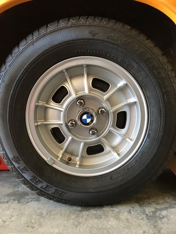

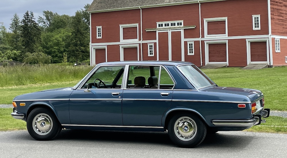

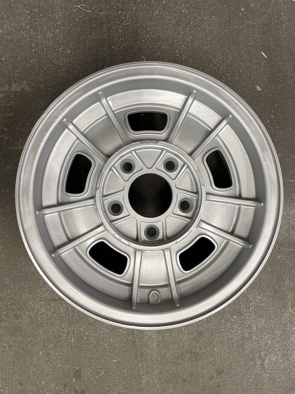

In this thread, @dave v. in nc suggested using small center caps instead of the larger hub caps on these stock E9/E3 wheels. I like the idea!
@Stevehose showed a picture of that look on stock 2002 wheels. The small center caps came stock on those wheels

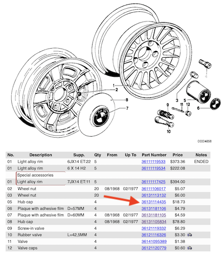

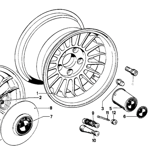

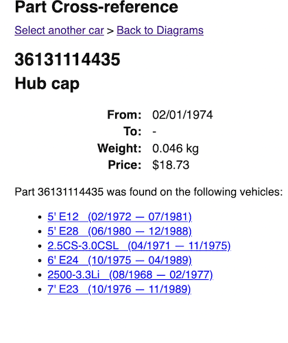

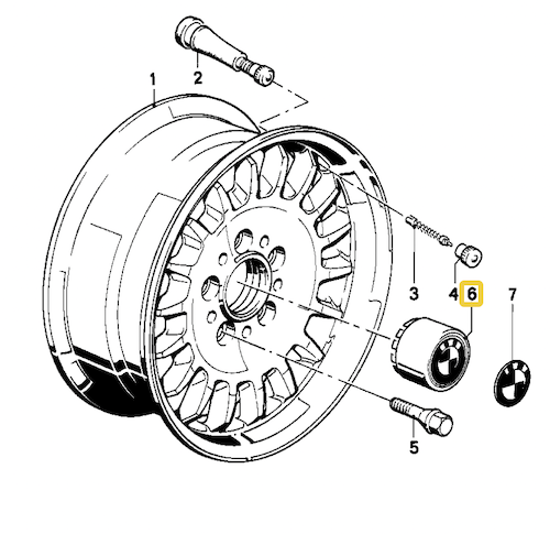

I thought the center caps from the alternative stock spoked wheels might work...
All the above wheels have the standard BMW center bore (72.5, 72.6, 72.56mm ....depending upon the source) but there may be other reasons why the above center cap doesn't work on the wheels I've shown.
Has anybody used just center caps on the wheel shown? If so, what cap did you find that worked?

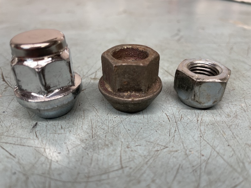

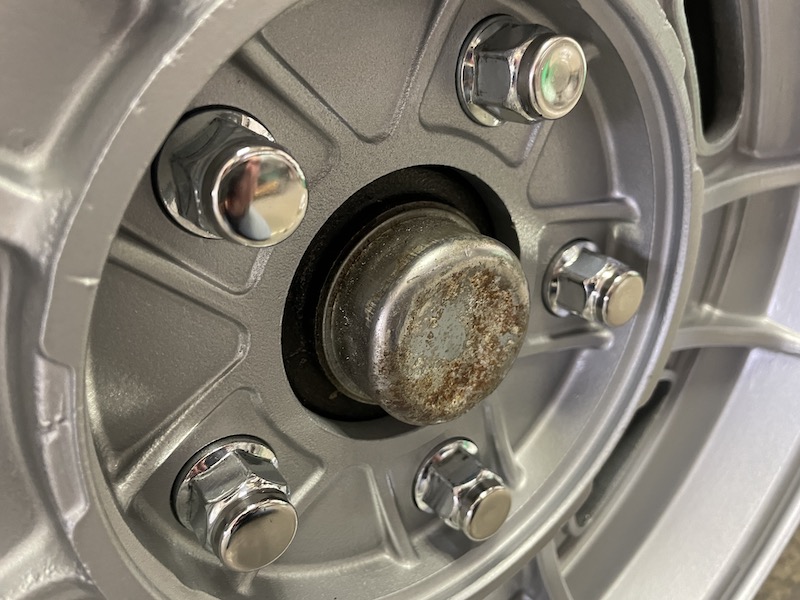

...and we'll need some pretty lugs, too!

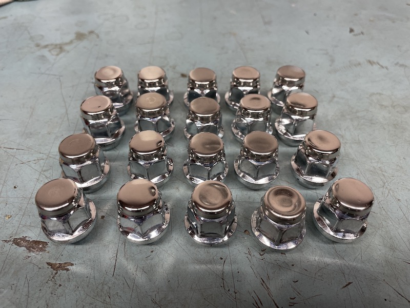

I just cleaned and polished a set of lugs for this purpose. Not perfect, but pretty nice....
These will fit under the stock cap if it turns out there is no solution for the center cap option, but I hate to waste them there. If it doesn't work out, I am willing to trade them for a set of the lugs that were used with these wheels. The center one in this picture...

It looks like the only possible option then was center caps that fit the TRX wheel...PN 36131117649.
The fit is still questionable. The cap is 2mm smaller than the center bore in the wheel. Expanding the base of the cap slightly, perhaps with some silicon or other adhesive might do the trick to keep them from coming off. Also, they need to fit over the hub grease cap...
There is about 20mm minimum clearance needed inside the cap
The caps are relatively expensive. I don't understand why. There can't possibly be any demand for them. Does anybody have any good used ones I could buy to experiment with? The Roundels are available and relatively inexpensive if they need to be replaced.

I may have a set of original lugs if you need them. The bottlecap wheels have center caps that are the same size as those on the FPS wheels that came as an option for our cars.
Thanks for the lug offer, Rob. I'll let you know how this develops.
I'm pretty sure the center bore is the same on both the bottlecaps and the FPS wheels. I think the hope is that since the bottlecap center cap inserts from the outside of the wheel that it may work.

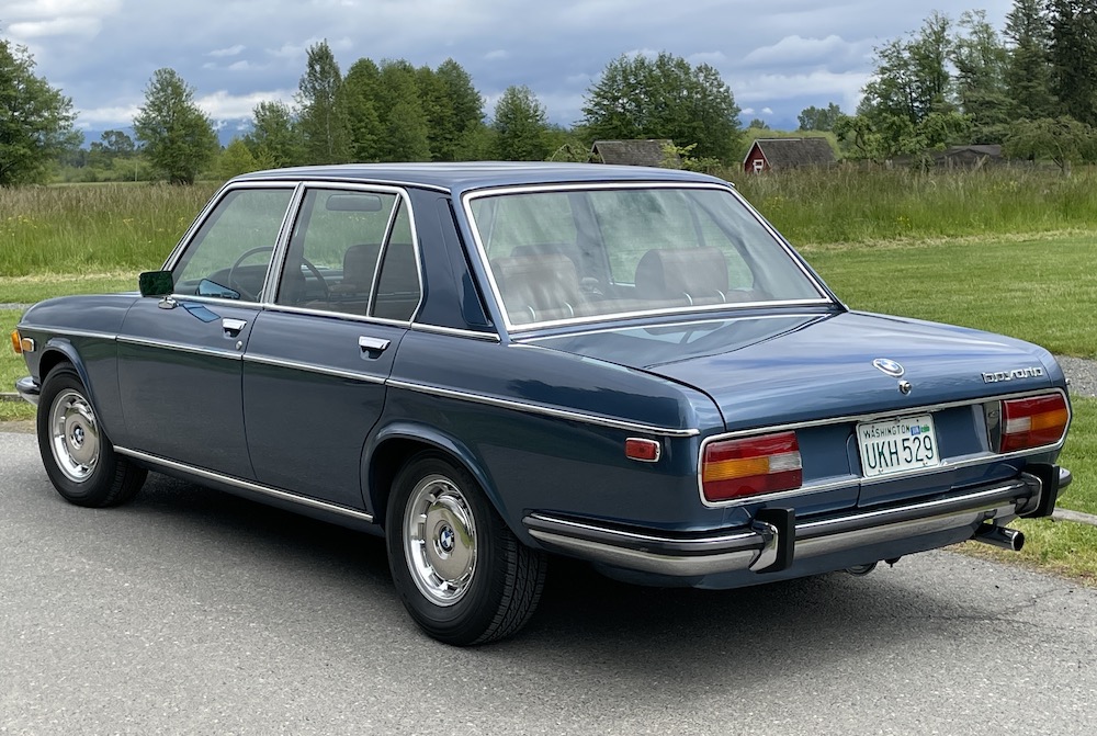

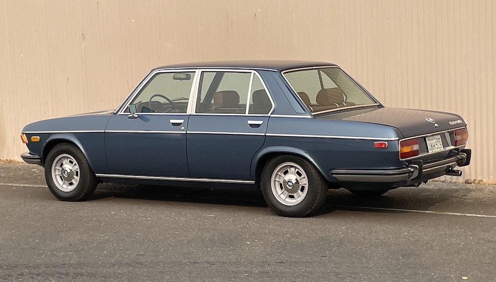

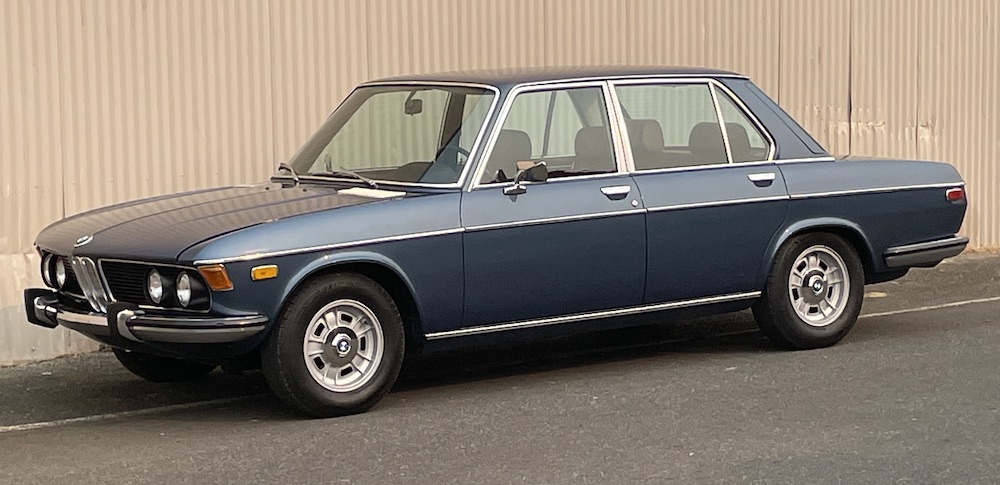

I mounted tires yesterday and swapped out steel wheels with the aluminum E9/optional E3 wheels.
The steel wheels/hubcaps/trim rings are still my favorite but I like the stock aluminum wheels a lot and it will be nice to be able to change up the look every now and then. I still want to see if we can make the center bore cap and exposed lug nuts work. That will give me a 3rd look.
