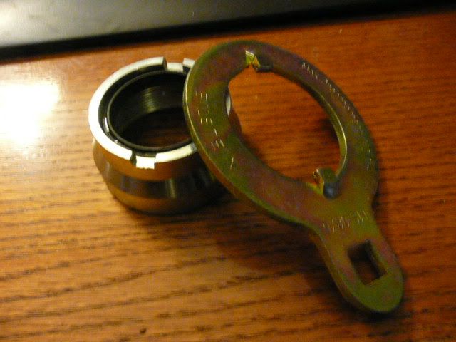

Where can the tool be found to undo the strut nut shown below. Although it is easy to improvise with a pipe wrench and other tools, it isn't very satisfying:

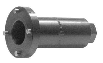

I do know that it isn't this tool:
Nor this one:
We don't have to be like cavemen anymore!

When I replaced the struts in my 74 I used an air chisel to loosen the retainers then I cleaned them up/deburr etc only to find that the Bilsteins came with new retainers which were different in diameter from the original. Maybe Bilstein has the answer?
The bottom picture is the Bilstein tool, I am not sure that one-hook tool would loosen a frozen ring nut. I vote for chisel/monkey wrench and BFH. Can't see it when reinstalled and if you go Bilstein you'll have a nice new one in its place anyway.
Here is a homemade strut wrench I made out of 3/16" steel. I think I used a hammer and chisel to remove the old rings and used this tool for installing the new (smaller diameter) Bilsteins. It worked well.
