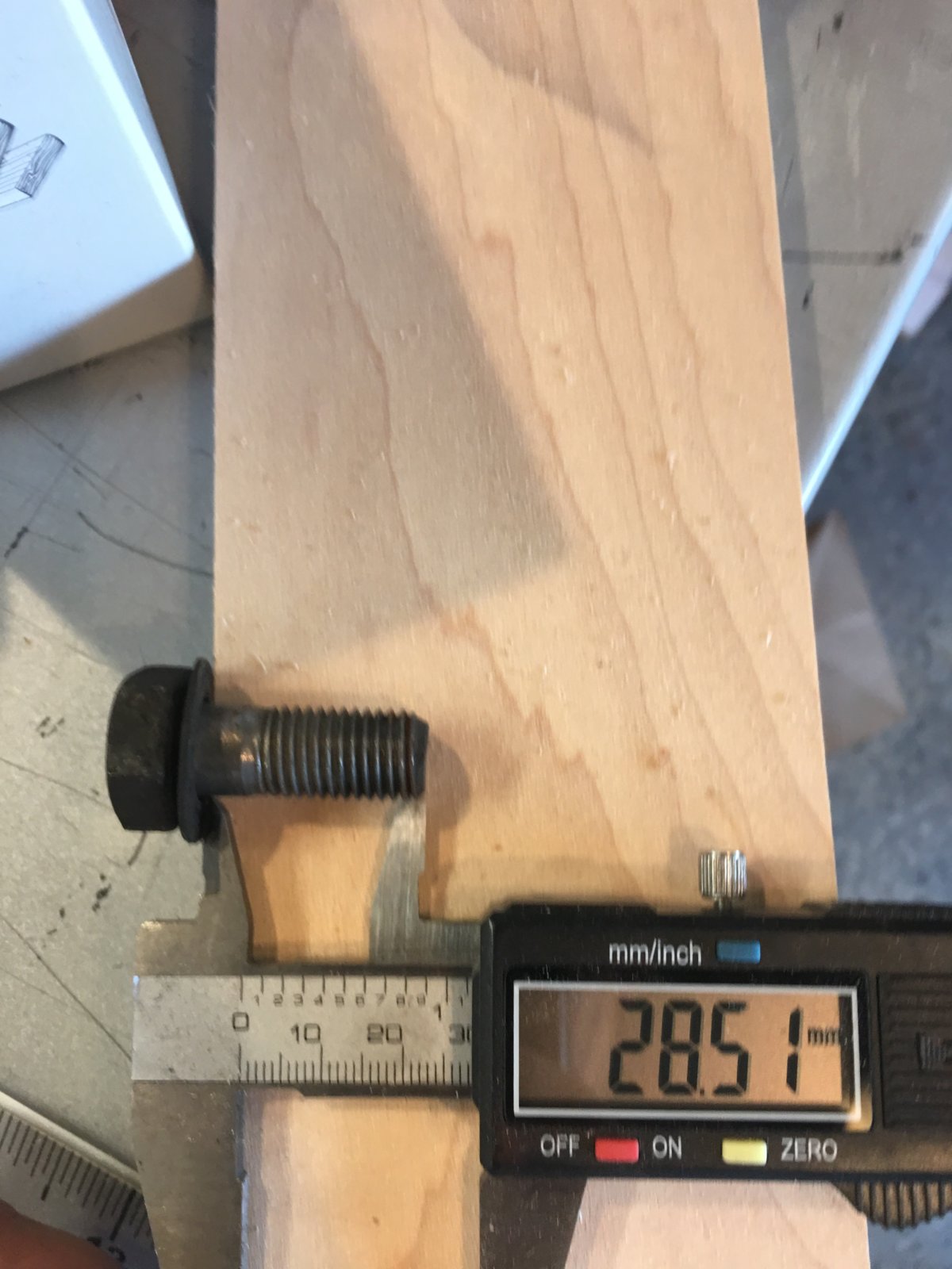

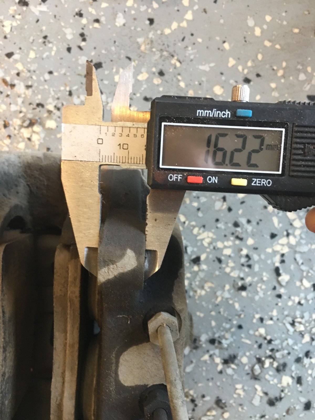

Did you keep your snapped bolt? If you measure it you can tell how much thread is stuck in the caliper mount, and if you have enough clearance to remove the caliper without drilling.
Obviously you could just remove the pads and try, but I know the car is off site. Sometimes you can plan for stuff based on some known facts.
Caliper Bolt:
Caliper width. Is your broken bolt around 16mm long? Account for the washer.
Caliper Bolt:
This is super detailed and resourceful! I actually managed to get mine out (though I DESTROYED the brakelines, which were already pretty rusty), It seems as though taking out the bolts and pin that was holding the brake pads inside the caliper (as well as taking out the pads themselves and brake-line) and then giving it an excellent whacking will do the trick. In all honesty, I have no clue where that broken bolt went but I should search for that now LOL
