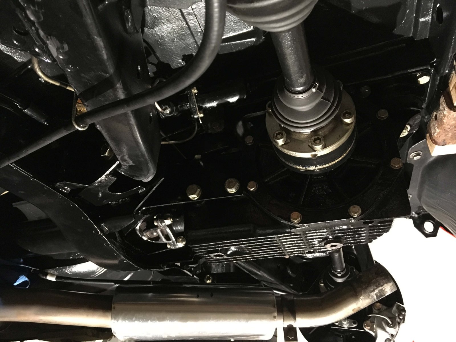

Am preparing for the subframe bushing replacement now. But where would you suspend the vehicle if the usual support location is coming apart to access the bushing you wish to replace? Have looked at old threads, trolley jacks offer options, but a lift, well where do they position the pads?
Where you put the pads is a good question and the answer depends on how solid your car is. I recently renewed my rear subframe bushes at home and jacked the car up under the diff, I placed the axle stands on the rear sill (rocker) lip cushioned with a piece of wood to prevent damaging the paint. If you don't trust your sills then your only option is to place your stands under the floor about 1/3 of the way in using a piece of 3x2 wood which runs from one side of the car to the other to spread the load but this is less than ideal and you do so at your own risk. Having said that I have done this successfully in the past.
Yeah, this is rather a tough one, and the shop manuals I have merely say "support the body."
I am reluctant to use the factory jack points, which makes for a difficult time when seeking to remove the rear subframe. The first time I removed my subframe, I lifted the car using the differential, loosened the bolt holding the trailing arm to the subframe bushing, removed the two bolts holding the trailing arm to the body, swung the trailing arm out of the way and placed a pair of jack stands, with a 2x4 block of wood, where the trailing arms are mounted to the body. This is not ideal because this location is not flat. However, my car spent 40 years in CA and TX before I bought it, so the floors are rust free.
And just in case you think you might want to go down the path of removing the bushings with the subframe in the car, my experience was that it is impossible to access all of the bolts holding the bushing to the subframe with the subframe in the car.

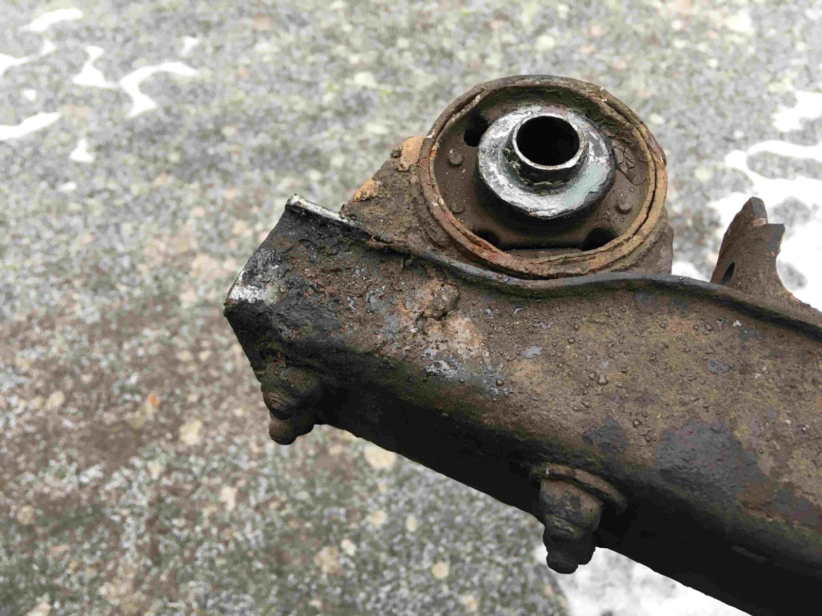

a few months ago I replaced #10 and #3 and I would like to share my experiencies.
I used for #10 the W&N part. The old one was really in a bad condition and this was not really visible, when installed.

When I started the process, I thought that there is close to no rust. But it was again hidden.
So I had really a huge amount of work. At the end I believe, it was the right approach to revise the whole area.

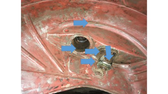

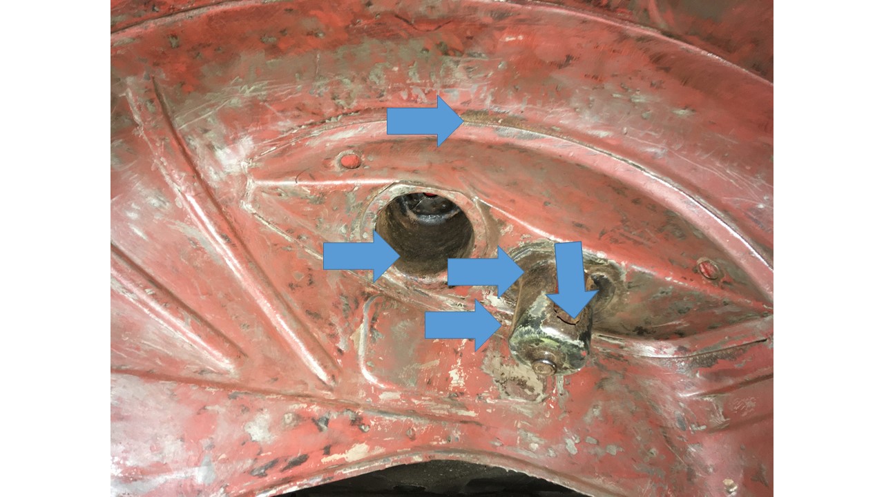

Yes, further to Willy's post, one of the reasons I concluded it was not possible to change the bushing with the subframe in the car is that I did not want to knock out the knurled bolt that is pressed into the body under the rear seat and that holds the bushing and subframe in place.
If you are willing to knock this bolt out, then it can be done. I had forgotten about this in my earlier post.
When I removed the knurled bolts, I used the weight of the car. I had the car on the lift. I first sprayed penetrating oil (Kroil) in the bolt from the top. Let is sit. Then I used a timber on the floor of the garage to the bolt and gently lowered the car. It slid out rather effortlessly. This, of course, required a lift. But it was gentle.
Well I guess I went the hard route. I could not get the knurled bolt out despite PB blaster for 3 days, a torch and placing the nut on, and lifting the car by the bolt itself. Thus, I left it in and I don't recall exact details, but I lowered the diff, removed the brake lines and was able to elevate the rest of the car to clear the subframe for the knurled bolts.

Would love to have captured it. But I just scanned my pics and I evidently didn't record it. However, now that I think about it I do recall that they didn't come out immediately. I let the weight rest on them to the point where the timber on the stud was lifting the car off the lift a bit. I then got in the car and added my weight and a little jiggling/bouncing to get it to comply. I'd forgotten about that part until just now...
