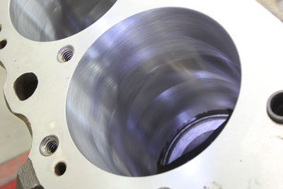

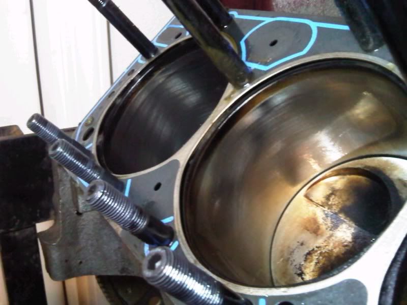

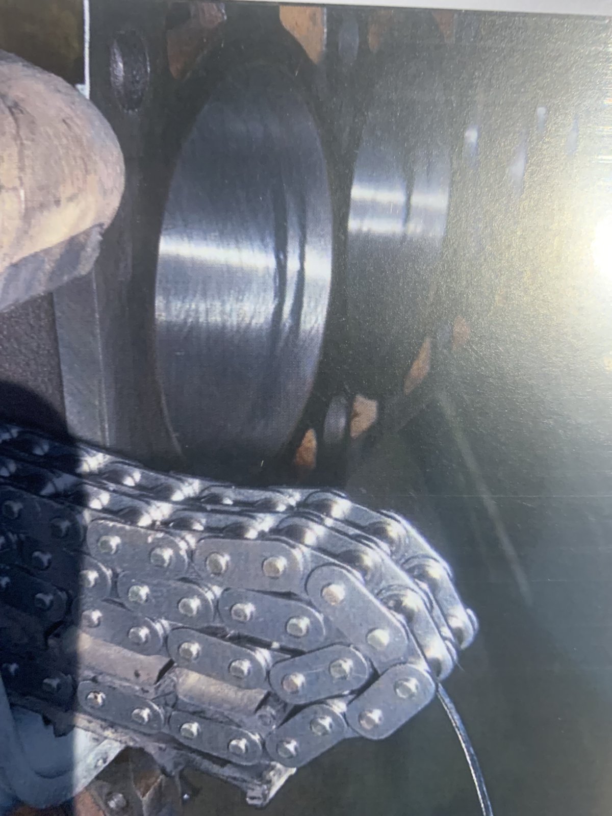

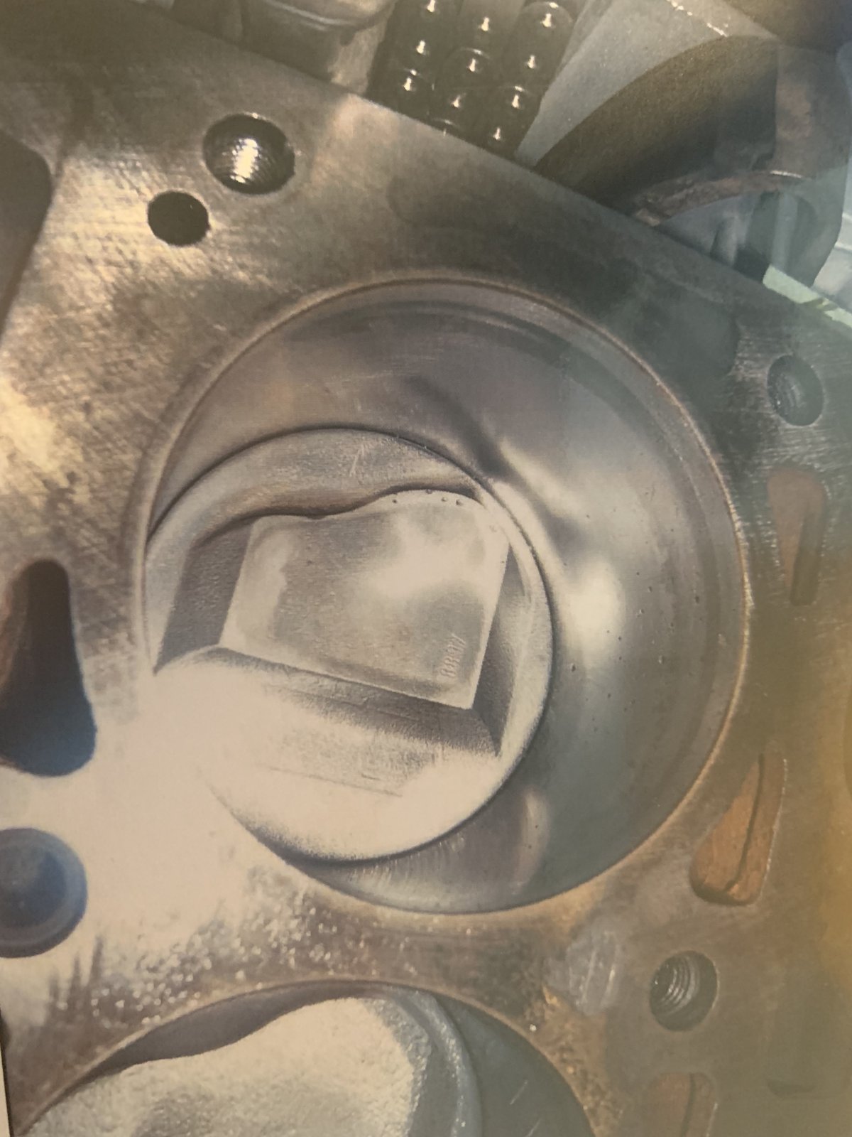

Let's start with the overall condition of the engine... the engine has been overhauled completely by an engine specialist, about 2yrs/2000kms ago. They changed really everything:
1. drilled out and honed cilinders and put oversized pistons
2. changed valves, grounded them, in one word, renewed
3. changed bearings...
4. cilinderhead flattened
In short, an overall overhauled engine, done by a specialist. I've put some pics of the before/after result...
So... I think this engine should be in excellent condition...
Next message will be the one with an update on the problems... With more pics and - if possible - some movieclips...

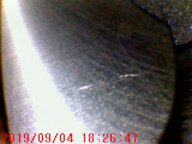

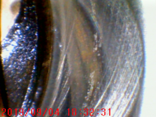

So we also did a compressiontest. I will put the exact values later but there was a difference of 3kgs between the first three and the last three cilinders. We also did a leaktest on the second cilinder, pressure mounting till 12kgs, so, that means... cilinders damaged?
The small valvecover dang was talking about appeared to be a blind one?
So i also got some pics of the cilinderwall, see for yourself...

Let's see if this works...
So this was this morning, cold engine, high idling because of choke, no any strange things going on... No smoke, no bad running, just a warming up engine...
This is the clip with camera from the cilinderwalls
They said the colour is like there is some sediment on the wall indicating a leaking segment or oil scraper...

As for me - your endoscope photo's showed, that it isn't the problem with dirty engine after re-honing, re-surfacing, because there is no vertical scratches on cylinder walls, but your photo's also showed that your cylinder walls are far from perfect surface (brown pitting, where re-hone scratches are not visible), i think it might be a problem combined with piston rings, that's why there is such difference in pressure on cylinders.
Maybe also piston rings gaps / piston rings are too big?
On hot engine gaps on piston rings are even larger, so it might have sense if matching with symptoms you mentioned.

I did not consider the photos due to a small viewing screen. However, upon closer inspection, even without the newer images, it would seem that the cylinder walls were merely "rehoned" rather that bored and honed. If there was any reboring, it may have only been to remove the upper cylinder "lips" or to remove a taper unseen in the images. It would also seem that the original pistons were reinstalled along with (hopefully) new piston rings. Although I doubt this occurred here, the piston ring gaps may have been properly sized, but perhaps some of them were not staggered. That said, with the sharply defined crosshatch pattern, some minimal "break in" has to occur for proper cylinder sealing.
engine-distributrion-chaine-jpg.74501
cilinder-treated-jpg.74503
These images do not inspire confidence in the engine rebuild. Maybe only a "hone" to remove cylinder wall "glazing?" Color changes suggest there may be some lack of cylinder wall uniformity. If new piston rings were installed, depending upon their composition, there may be a very long break-in period. The original equipment chrome plated top compression ring was very hard and durable and also notorious difficult to "break-in" without a suitably prepared cylinder mating surface Some softer composition rings, e.g., "Deves," allegedly do not experience the same issues.
