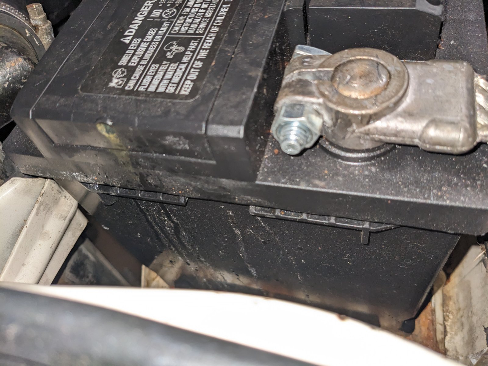

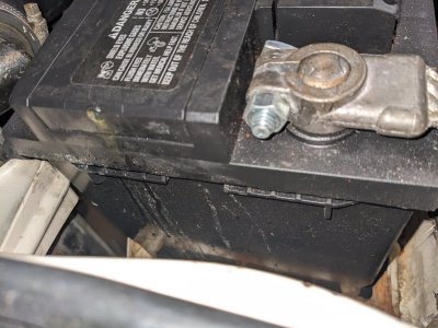

I have heard an overcharged battery can cause this smell. Never heard of it in a Coupe, but apparently a faulty voltage regulator can affect the battery enough to produce sulphur smell. Not saying this is your issue, just something that has been recorded. Good luck and let us know. ;)
Interesting, I'll check battery health and smell once I let it run for a bit. Thanks for the lead
