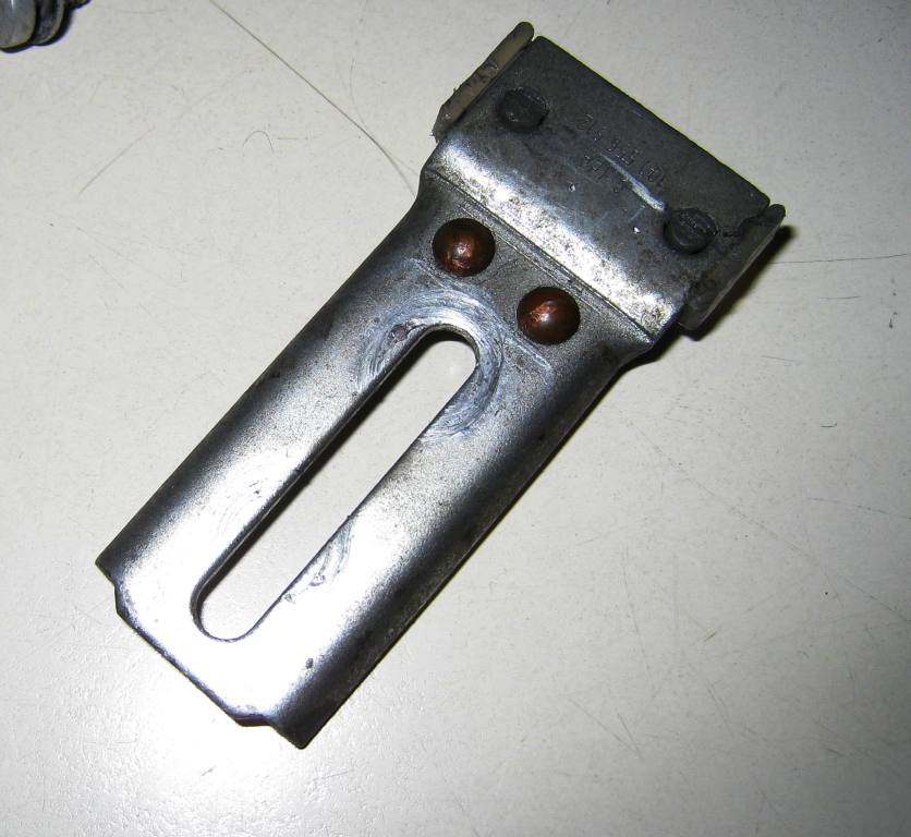

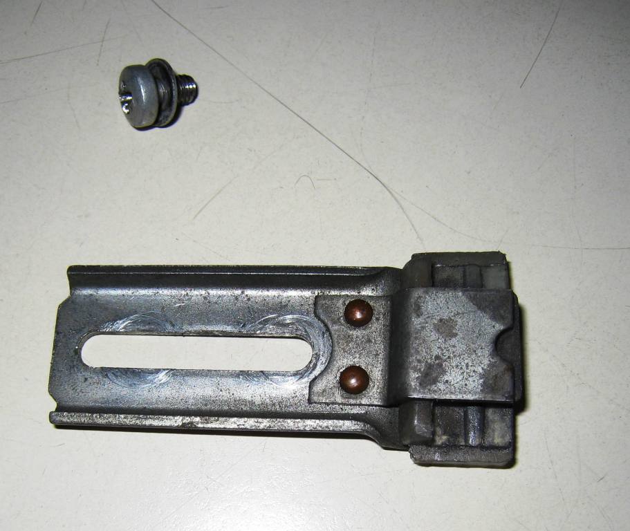

'73 3.0CS. I am attempting to adjust my manual sunroof. It's been a long time since I took it apart so my memory needs help.
I have the blue book service manual (page attached), but the front clips don't match those pictured there. Two photos of mine are attached. I suspect the manual that I have was printed in 1969, and a different clip superseded that in the blue book. (And based upon what the rather 'lacking' instructions, I would swear a page was missing if it was not printed with a consecutive number on the reverse side.)
1. Which side is supposed to go up in the clips I have, photo 1 or 2?
2. If it is that facing up in 1, then I am going to need longer screws.
3. Does anyone have a later blue book page corresponding to the one I have with photos showing what I have (and hopefully more complete instructions?)
Picture 1 faces down to the interior, see the wear on the clip from the screws. Picture 2 is the top that rests on the two knurled nuts at the front. Turning the knurled nuts adjusts the height of the front of the roof up and down.

May I ask if you are speaking from experience with the sunroof, or based upon the photos I posted? The marks on the clips (guides) could be a red herring. I suggest this because even with the knurled adjustment shafts screwed all the way 'up' (i.e tightened as much as possible against the surface of the sunroof), when oriented as you suggest (Pic 1) the front of the sunroof is considerably to high, protruding may 5 mm above the roof surface.

The wide plastic glide should slide on the rail, narrow part below the rail.
Since you tightened both knurled nuts You may need to back off the knurled nut towards the center of the car to lower the front. The sunroof has an arc to it tightening both nuts will make it too high.
Easiest way is to put the bracket on with the phillips head screws loose, or the outer phillips head screw loose. Then back off the inner knurled nut until you are satisfied with the height.

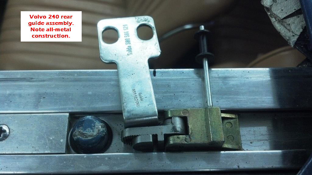

The location of the rear guides is critical, so when replacing the cable/guide assembly when BMW's (or Golde's) lousing plastic units with the much more beefy Volvo 240 assembly, getting them in the right spot it tricky. (Hindsight being 20-20 I wish I had marked location of everything before I took the originals out. EVERTHING!)

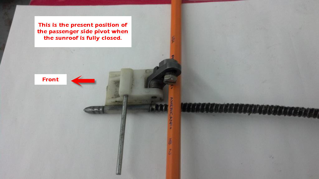

The reason for this is that the mechanism causing the sunroof's rear edge to rise is associated with the pivot on the rear guide. As the guide moves forward when the front edge of the sunroof hits the front edge of the opening, continued cranking of the handle causes the rear guide to continue to move forward and the pivot turns the finger-like portion into a more upright position. (I still don't know the exact function of the rod that goes about the sunroof spring, but it has something to do with this.)
I am not completely sure what the final orientation should be. I have attached a couple photos showing what is and what it maybe should be, using the old rear guides as models.

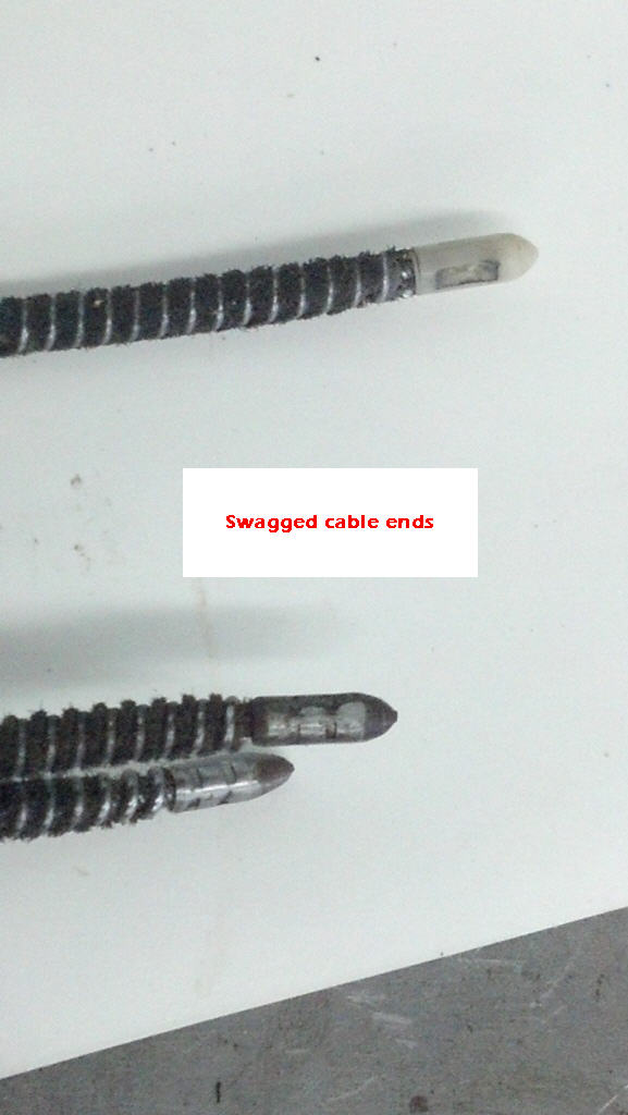

In addition, the Volvo 240 assemblies have longer cables that that for the CS. The cables need to be cut. If there are sharp/pointed wrapping wire ends sticking up the cable will bind in its track, so ground the ends round. I am searching for 1/8" dia swagged bullet-shaped cable ends like the originals (also pictured) right now.
