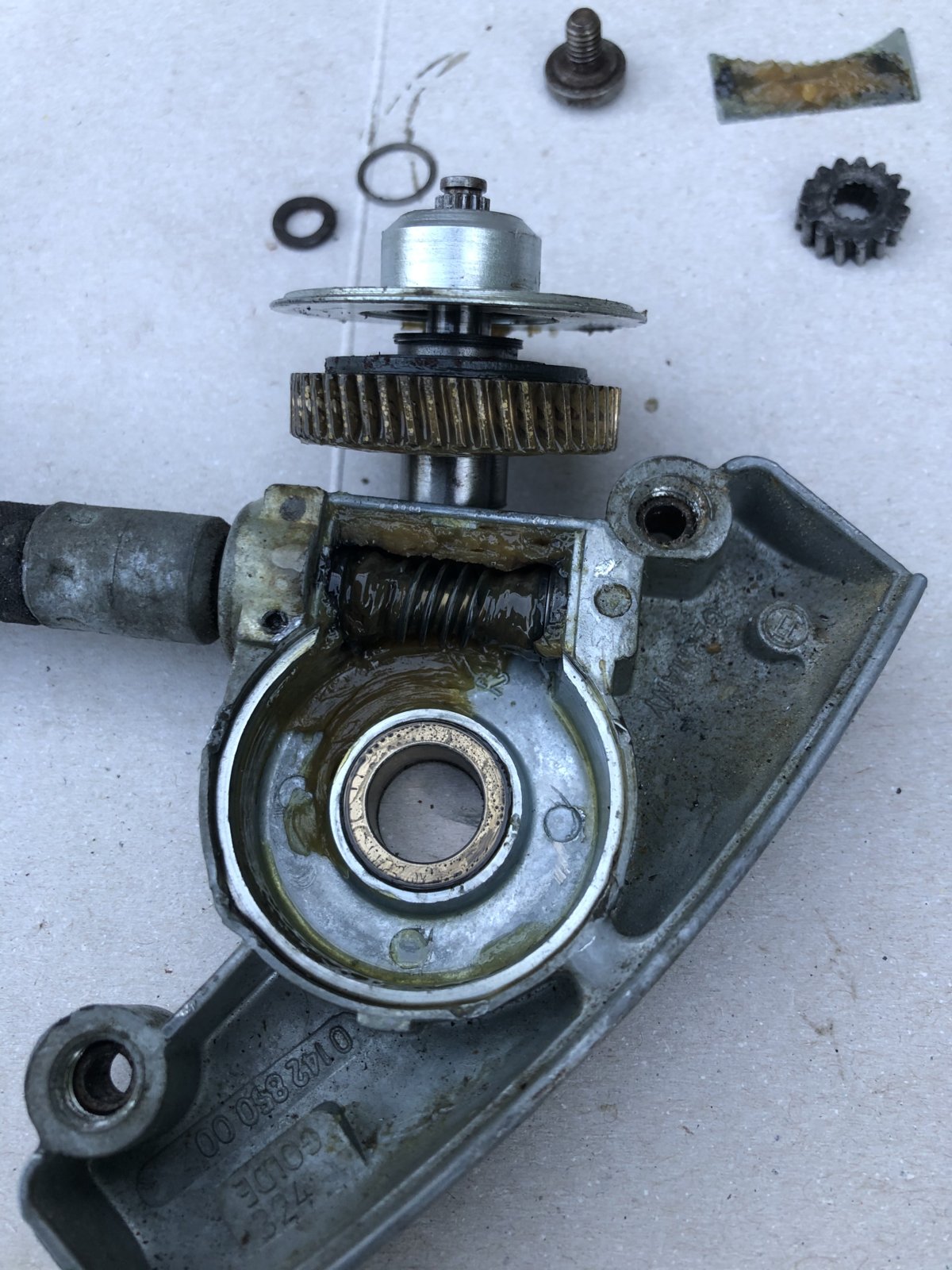

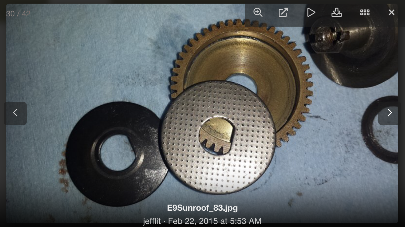

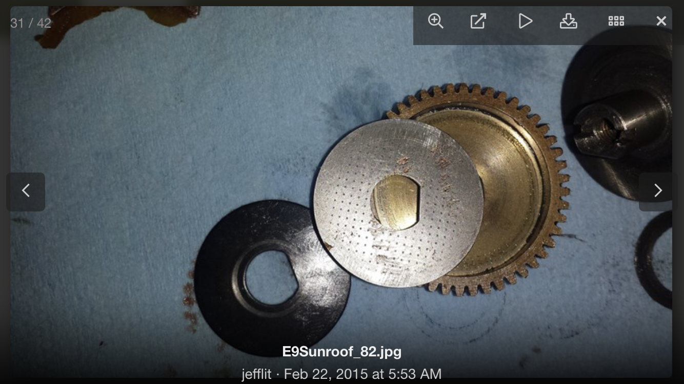

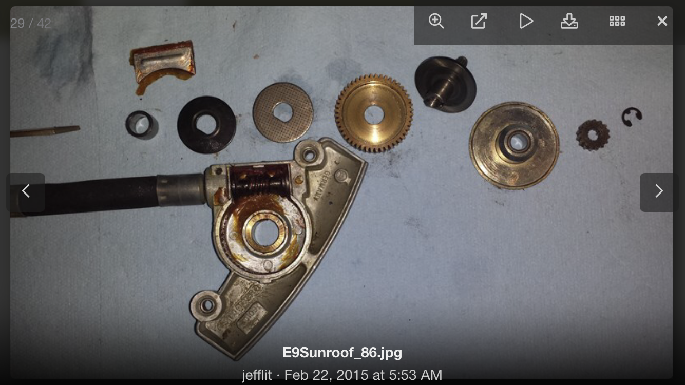

I did see these photos put up a while back On a previous discussion,
I wonder was it ever solved back then ?

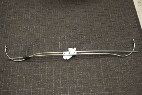

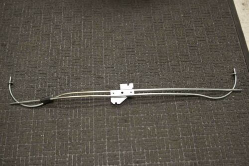

First start with clearing the cable tracks along the brushed alum parts and lube them. Also (See below), the motor retracts the cables and they criss-cross as they travel inside these tubes when opening. The tubes get crud and rust and add tremendous resistance . Of course, if the gear is stripped, none of this will help. The center part in the image can be adjusted a bit towards or away from the roof so if your gear is slipping because there is not enough "bite", that will help.

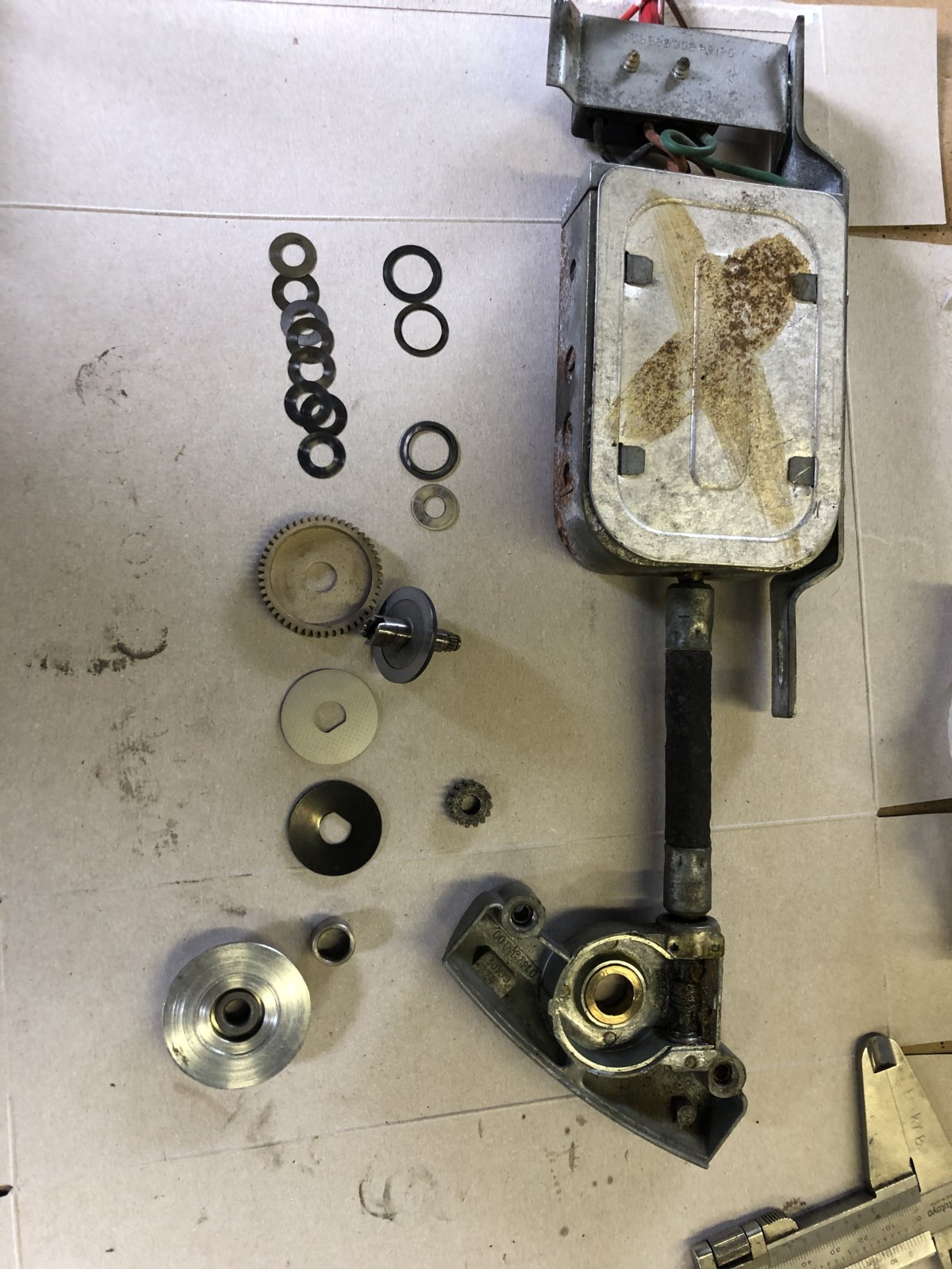

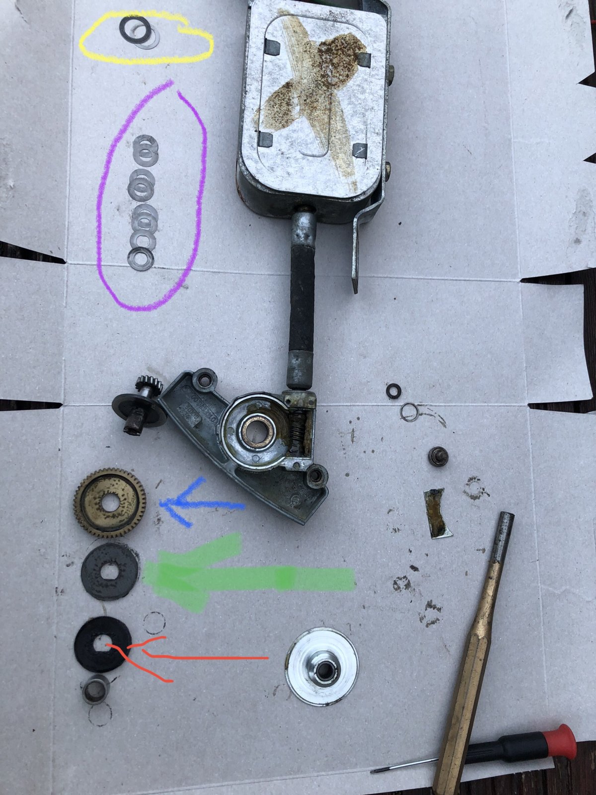

Hi again
So I took my sunroof out again and I checked everything.
I do have 1 sunroof cable that is not great , it will need replacement.

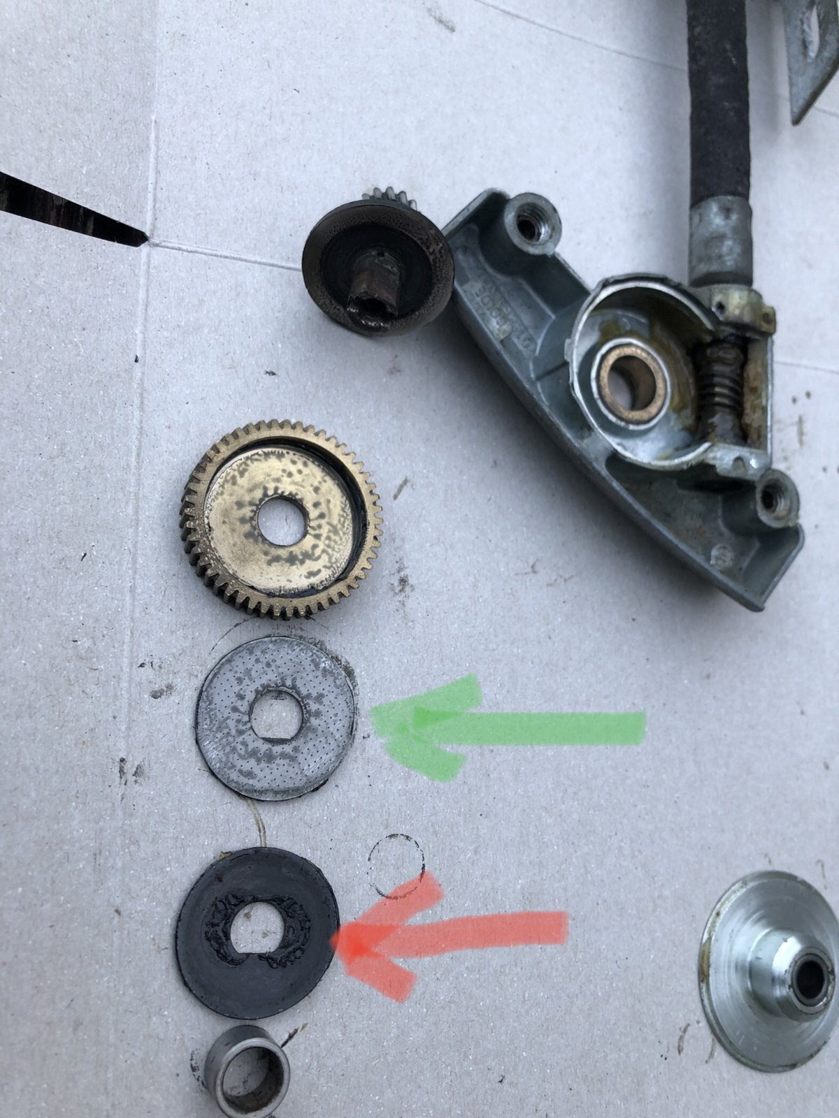

I then took out the motor and with it stripped I can see that the friction clutch between the brass gear and the metal cable drive cog is slipping.
Now I did get oil on everything last weekend , so that probably wouldn’t help things .

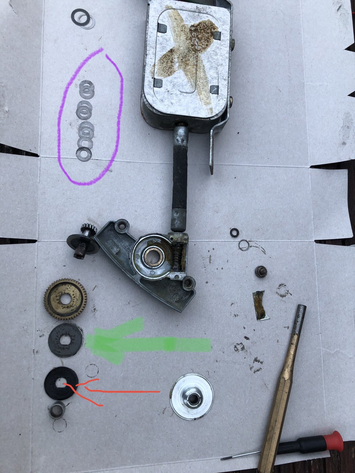

I think I need to add more shims or something to get the clutch to be more positive.
The black washer that I highlighted with a red arrow in the photo is not flat. It is concave and is made from a type of spring steel.
So it acts like a pressure plate acting on the friction plate which is highlighted with a green arrow. The shims are highlighted in purple. So if I can increase the shim thickness below the pressure plate, in theory i should get more force and more of a positive drive to the sunroof cables.
(Maybe)

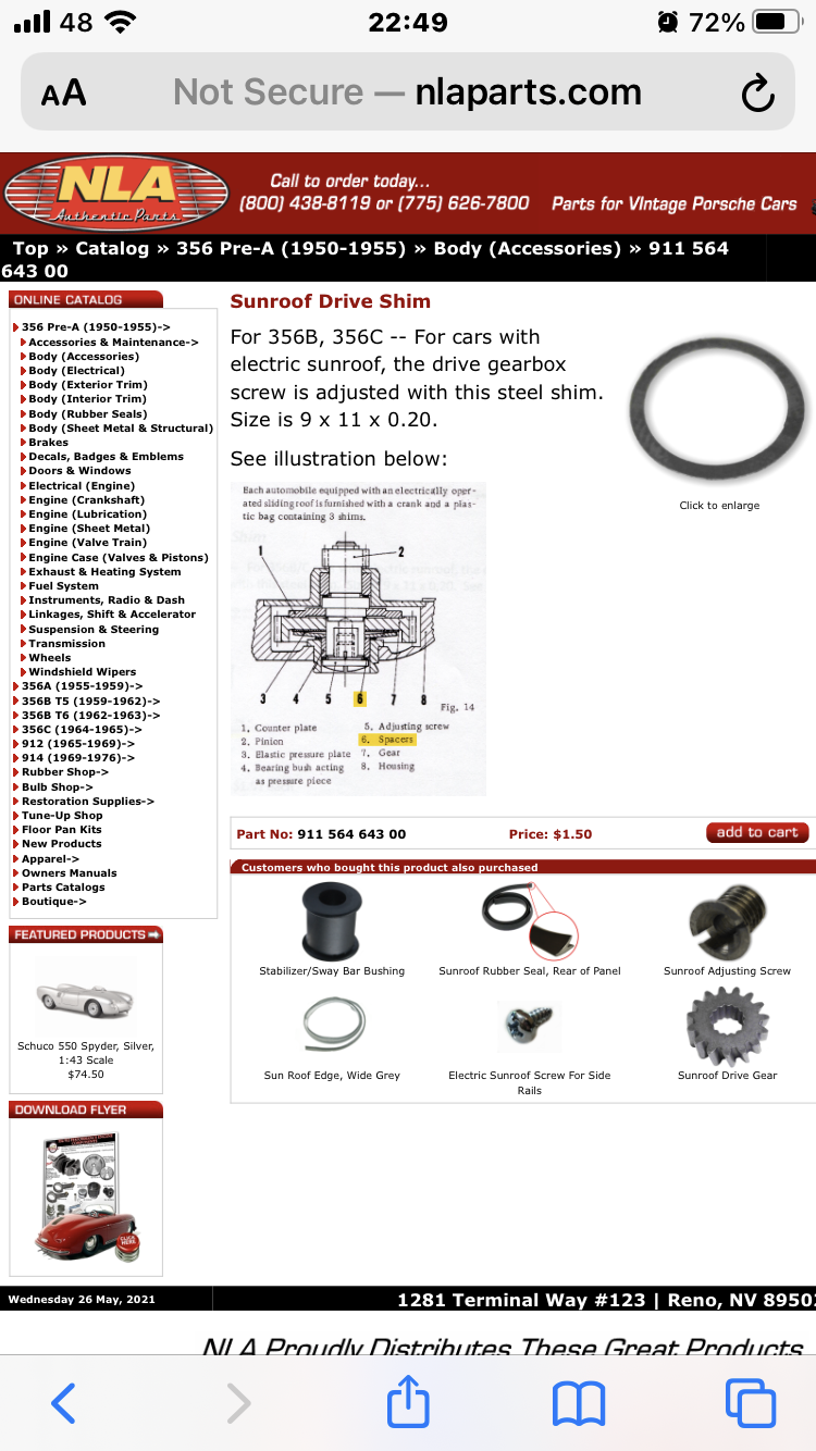

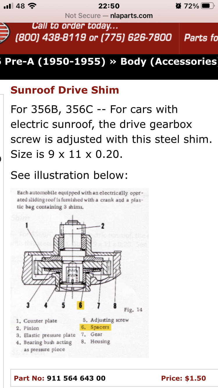

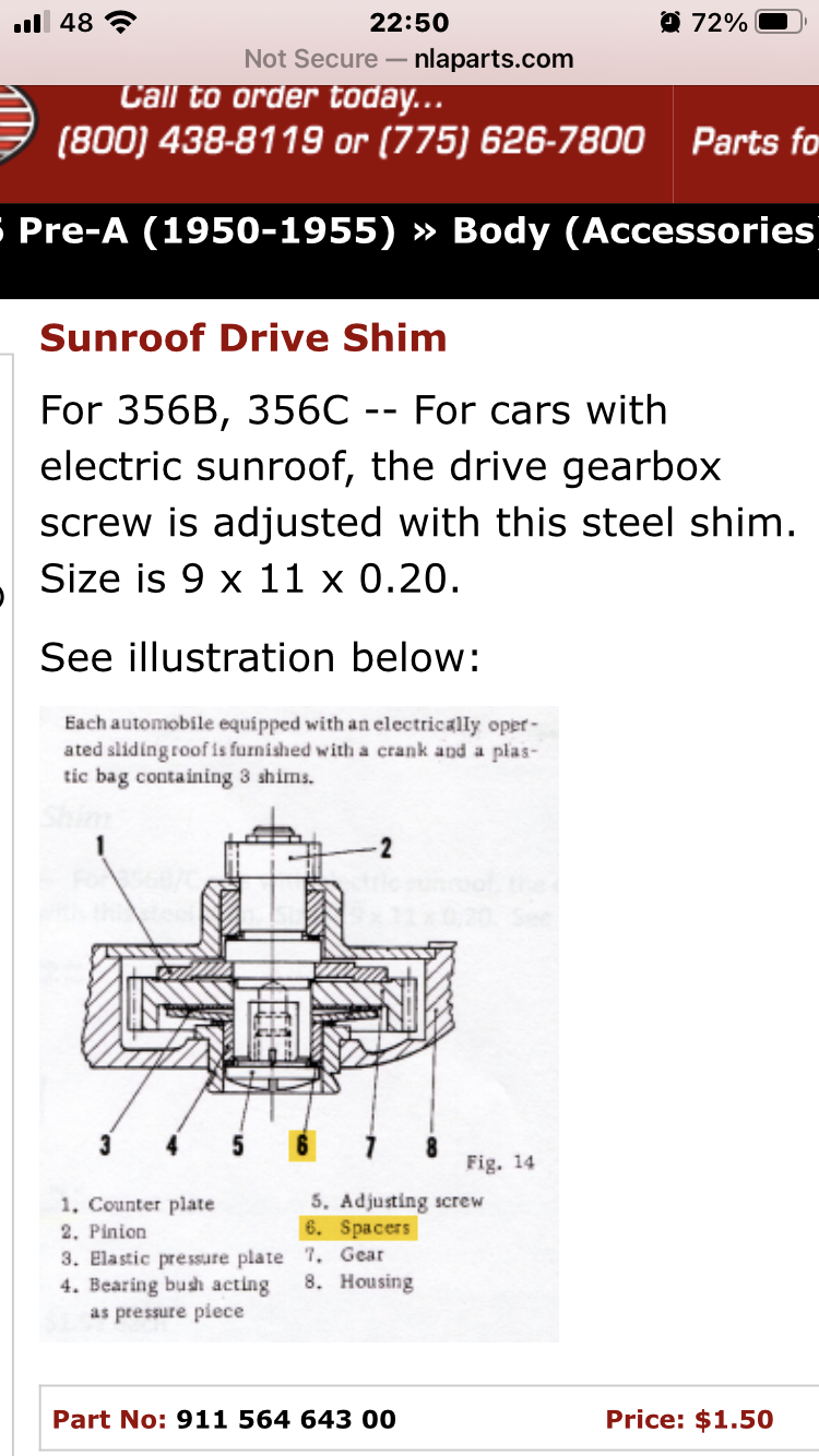

I just found this online . This is the golden ticket I think .
Or should that be Golde ... n ticket :)
I am not sure they ship to Europe though , I have emailed them , so fingers crossed.

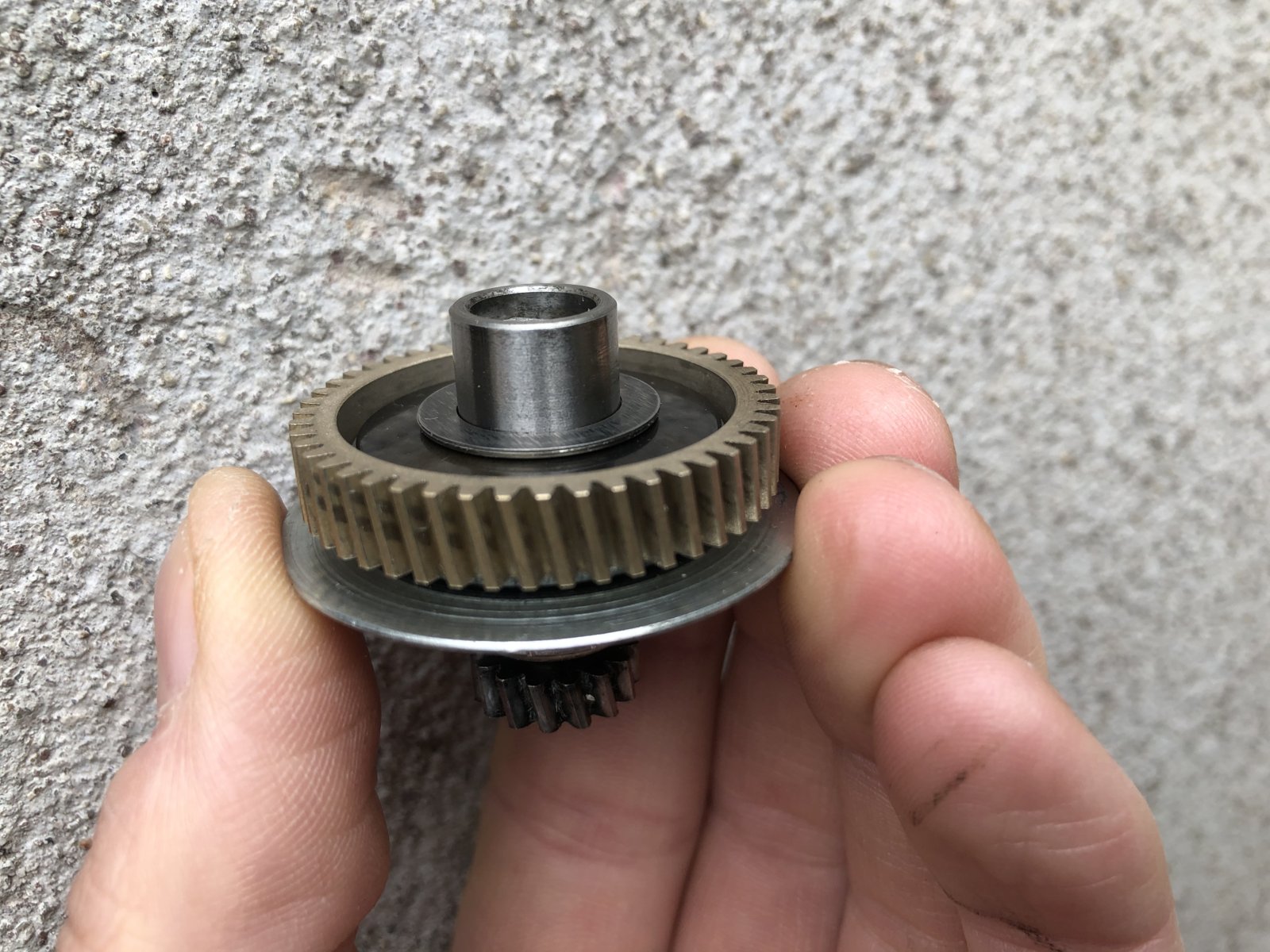

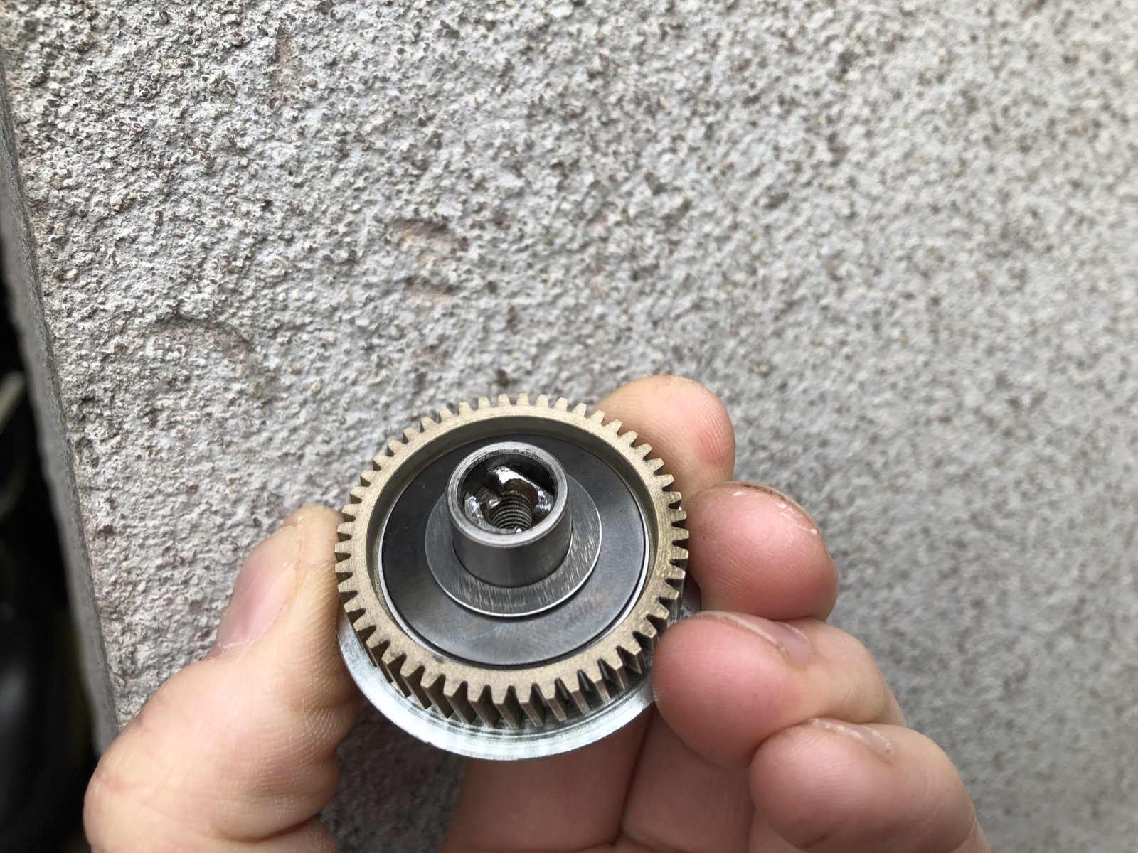

I fixed the Slipping sunroof motor so my sunroof slides along and rises up to close properly now as it should :)
I stripped the sunroof motor gearbox.
I cleaned everything and then I made 3 changes to it before reassembling it.
1. I media blasted the face of the brass drive gear ( arrowed in blue ) to give more grip.
2. I took the 2 larger diameter shims (circled in yellow ) and measured them ,they were 0.2mm thick and 0.1mm thick. I then got a friend of mine to machine a new shim 0.5mm thick ( anything thinner and he could not part it off on the lathe) I then took away the 0.2 shim and replaced it with the new 0.5mm one. This change now increased the preload tension on the concave clutch pressure plate ( red arrow ) by 0.3mm .
3. I turned the friction plate (green arrow ) around 180 degrees. From the factory it comes with a dimpled / textured surface on both sides .one side wears smooth over the years. So I flipped it around to allow the fresh dimpled side to now be in contact with the brass drive gear thus increasing its friction grip on the brass drive gear.
the stack of smaller shims I left as they were- just cleaned them and reused them (circled in purple)
make sure all friction faces are dry and lubricant free before reassembling everything.

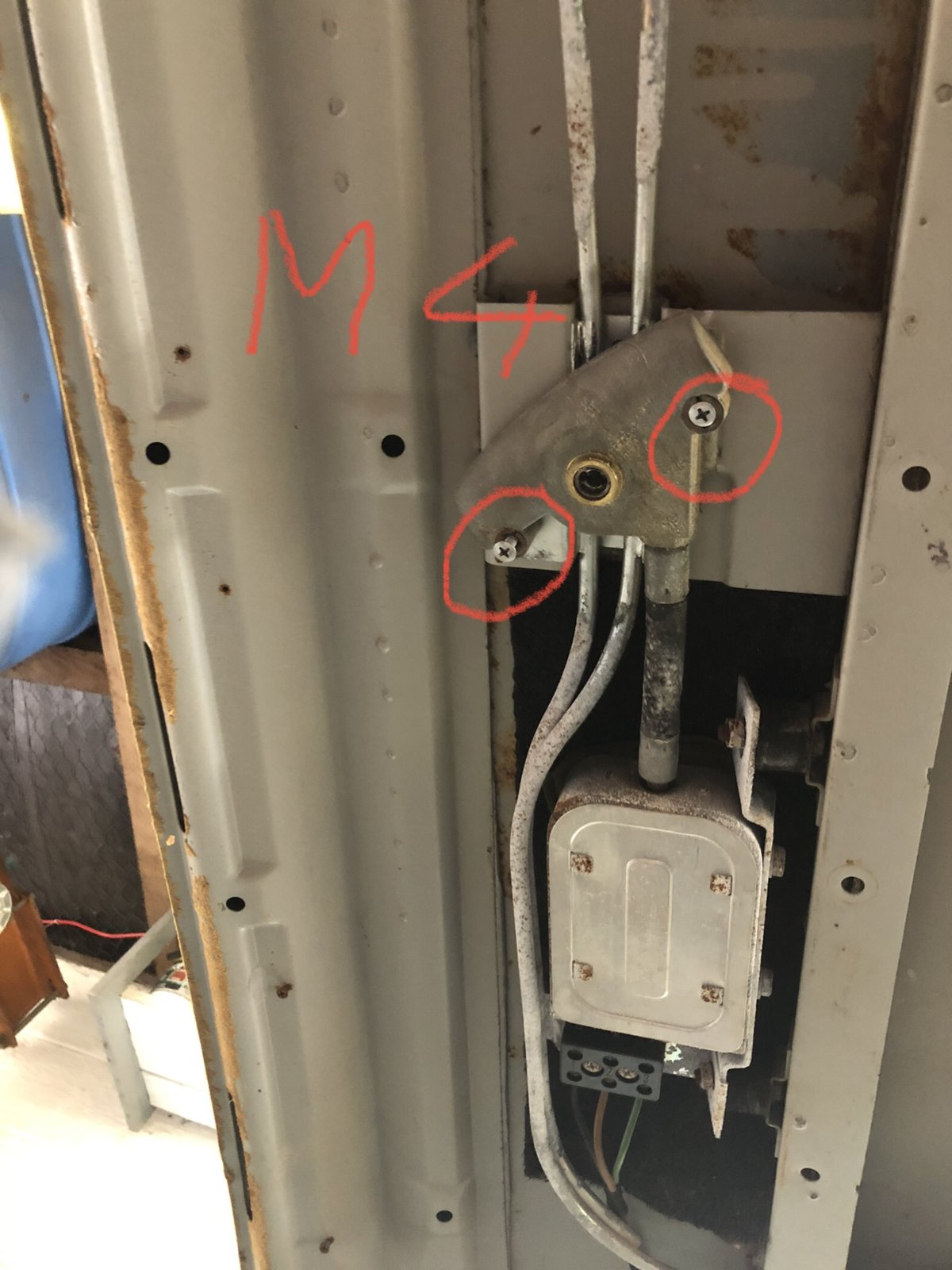

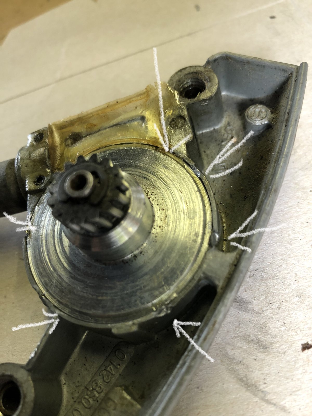

When you do re install the “stack of parts back into the housing you will have to crimp / dot punch the housing (white arrows ) to keep the assembly together. Once fitted back into the car the 2 m4 screws also keep it all together.
By the way I don’t think the diameters mentioned on the Porsche sketch are correct for our roofs so if you are getting shims made or if you are buying some, take the time to measure your own one beforehand.
Also a word of warning !!!
If the plastic end of your sunroof cables are brittle from old age but still in 1 piece ... when you make your sunroof motor work properly they may now give up under the increased load.
one of mine was broken already ,beforehand I had glued it back together temporarily so that I could get everything sliding again. But once I fixed the motor the glued part gave up predictably... ( I had another one on order in the post to replace it anyway)
